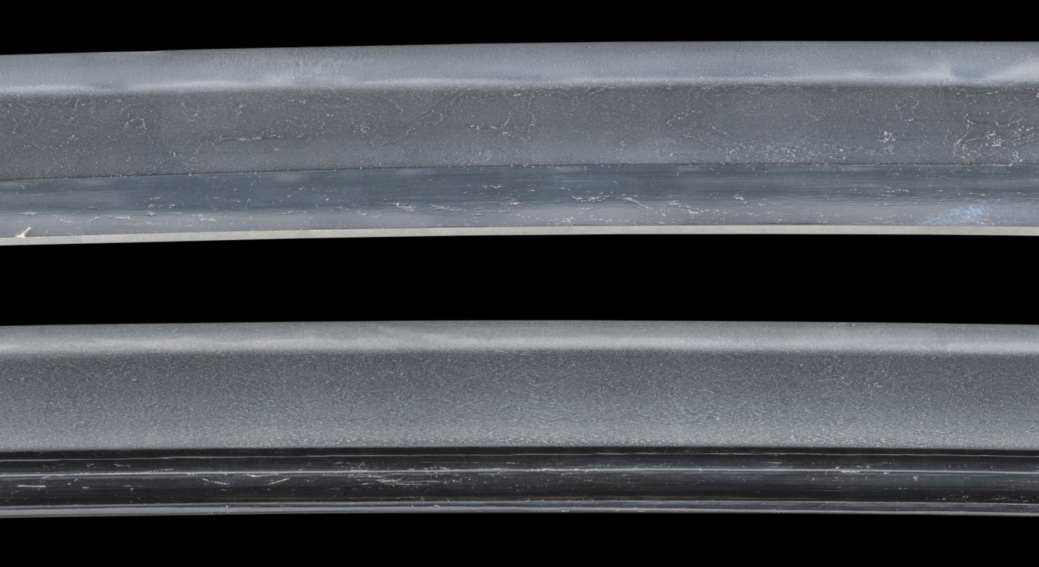

Here you can find the next problem:
2 Katana, both mumei, both Juyo Token, both with an attribution to Rai Kunitoshi.
Do they look as if they come from the same man?
Uwe G.
Uwe, i would say yes. The hada is really similar in my eyes. The first one gets some polishes more than the second. And every good swordmith is able to make every hamon and style. I would say yes.
Excellent illustration of why image recognition > identification is so difficult. The algorithm to identify both blades as Rai Kunitoshi just isn't here yet. Could an AI system be trained to recognize both of them? Sure, but if just one was in the database, the second wouldn't likely be ID'd as the same tosho, jihada notwithstanding.
