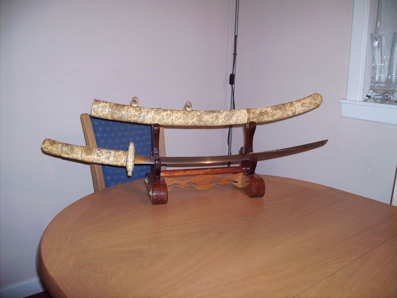

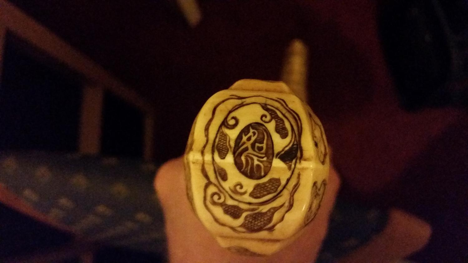

I know not good karma these days to own anything ivory, but it came my way about 15+yrs ago , obviously made around the Meji period, I would suggest circa -1860/1880 !! any idea what the signature may be , supplied both ways not even sure what is the right way up.
Hi Ray.,
I'm going to make a wild guess 60px-%E9%BE%8D-bigseal.svg.png which is an archaic Chinese version of the  character  for dragon?

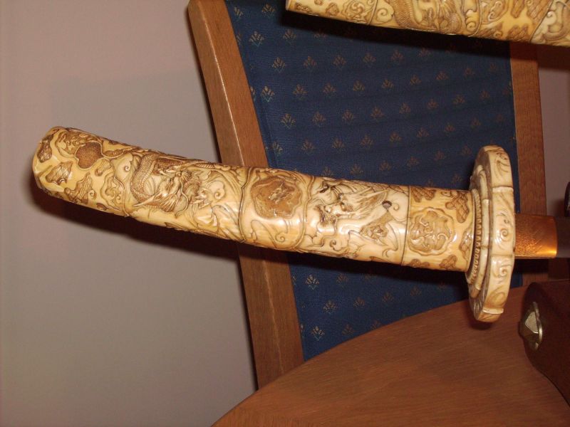

Can you please show a side view wide and side view close up of the complete tsuka?
There were a large number of these produced for the export market after the opening of Japan.  The vast majority are actually bone, not ivory.  Look for Schreger lines to see if they are there.  You'll find them on the ends of the piece.

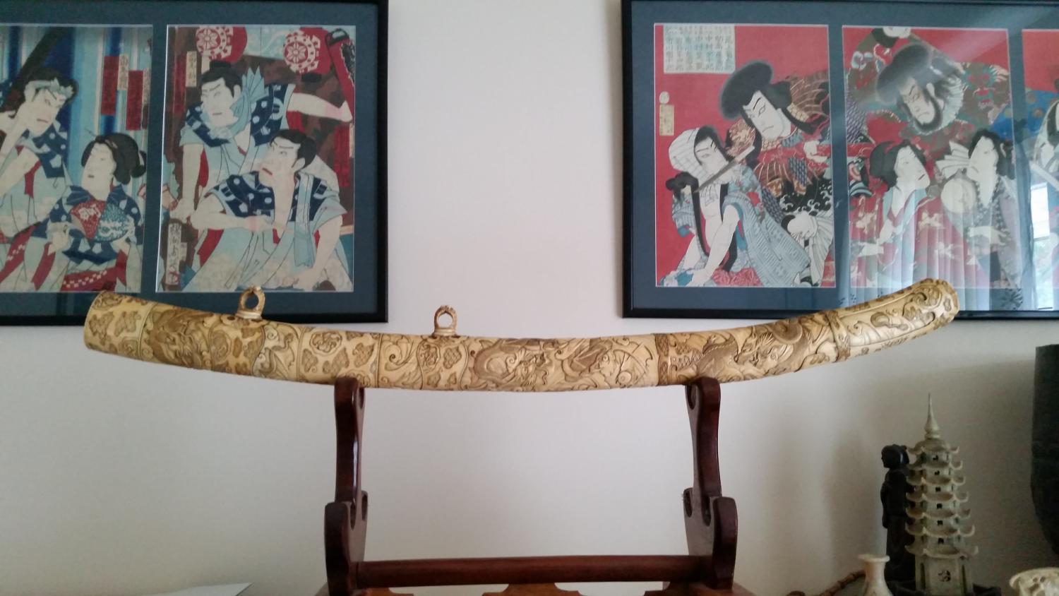

yes , Steven , i have the saya , there 10 dragons carved all over the tuska and saya diving in and out of the clouds , in fact a small portion of the saya is in the second photo.

Ah that's better, fine example of Meiji ivory carving. You are fortunate to live in a climate that's kind to ivory, no doubt why the condition is so good.  99% of blades in this style koshirae are nonsense, any possibility yours is part of that 1% exception?

Those would usually be in the poorly carved "all flash, no substance" mounts. Bone and poorly done ivory.
This one is very well carved and of high class, so I wouldn't expect it to be a poor blade or even a repurposed one. Possible, but those are usually put into the bad bone carving koshirae.
