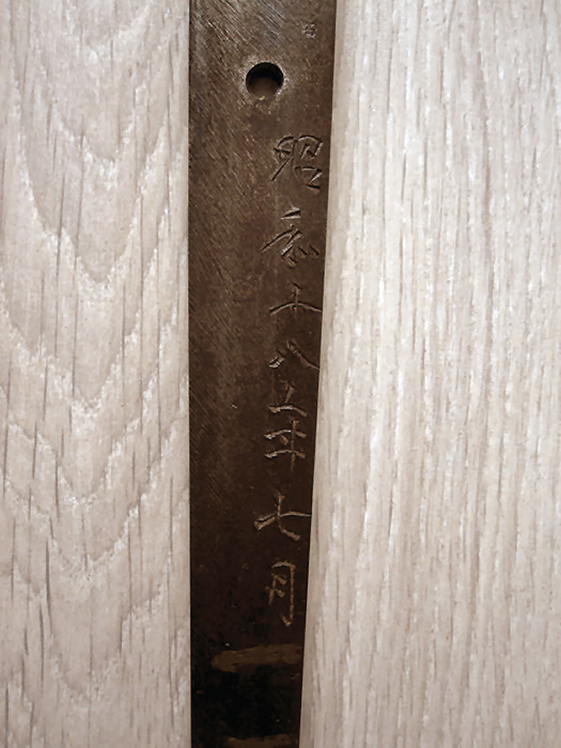

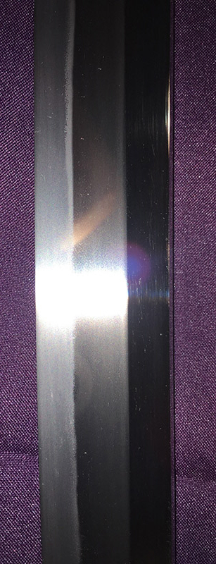

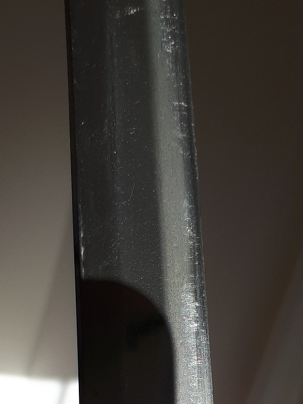

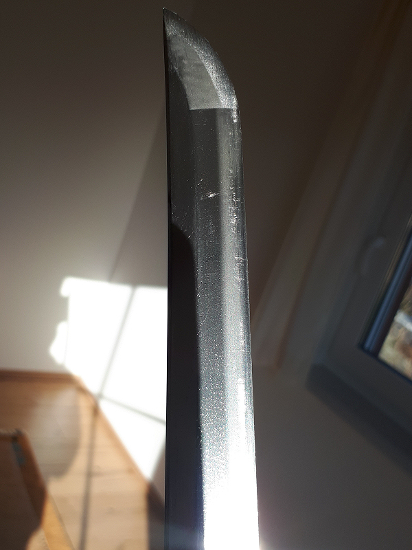

I have a very nice showa-to type 98 with a "na" stamp.
What is the na stamp? Is it a controll stamp or indicates it a showa-to blade?

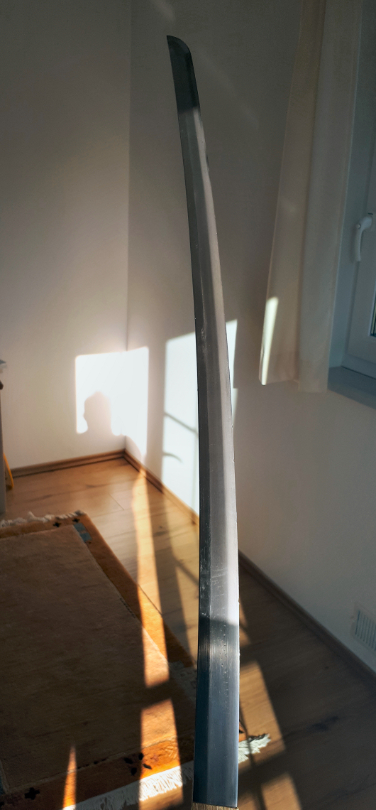

post-3496-0-37252500-1510764585_thumb.jpgpost-3496-0-48912400-1510764598_thumb.jpgpost-3496-0-44959900-1510764620_thumb.jpgpost-3496-0-32615900-1510765019_thumb.jpgpost-3496-0-27290900-1510765470_thumb.jpg
(the drops are choji. I was looking at the blade oil it and then the sun comes out - taking photos).

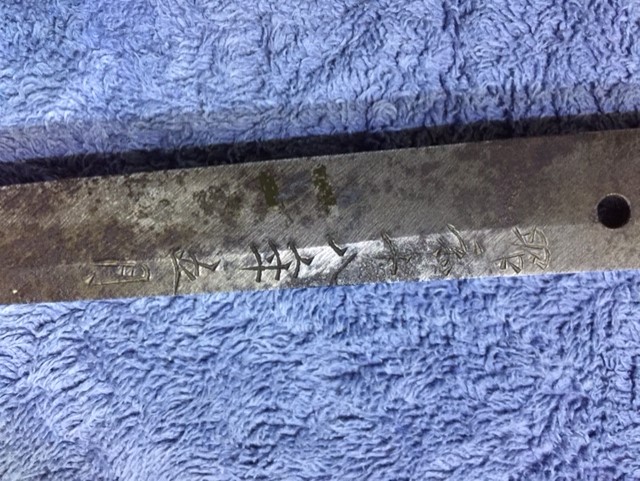

post-3496-0-88927500-1510768026_thumb.jpgpost-3496-0-97427600-1510768041_thumb.jpgpost-3496-0-62809800-1510768052_thumb.jpg
Chris
Chris,
It is the inspector stamp for the Nagoya Army Arsenal. It means it passes inspection, but it also means the blade is not a traditionallly made blade. It's very beautiful, by the way! But probably made with non-Japanese steel, or with hydraulic hammer; something like that.
You probably know the date, but in case you don't, it's July 1943.
Thanks Bruce. There is no other stamp on it. It has less or no big activity between itame hada and suguha hamon so i think its oil quenched? No problem for me it is honestly a showa-to. It is one of my oldest swords in collection so i didn't care much about it. Today i take some time for the older ones to care and as the winter sun came into the room i see the beautifull hamon shining and saw that there is only this small stamp.
I was going for October 1943 (thanks again).
It is definitely pretty. I never discount showato. They can be made with just as much care and craftsmanship, but simply out of another form of steel.
Yeah, I still get the numbers mixed up and have to look them up, sometimes! This one is "七", though, which is 7, so July.
If you bring the smith name over to the "Translations" forum http://www.militaria.co.za/nmb/forum/15-translation-assistance/
You'll get a quick translation. The first one is "Kane" but I'm not good at these and don't recognize the bottom one.
Chris, I know what you are thinking, that you think that you have a "real" GENDAI TO. You don't believe it is machine made. I would be more convinced if it had a STAR STAMP, indicating the use of TAMAHAGANE. There is every chance it is made from steel, and hand forged, and oil quenched. BUT, very hard to identify from photos. I have and had many KANENORI and it looks like what I described. A GENDAI KANENORI is very rare, and a good one quite expensive. Your sword is a very nice package, and I would do more research on how he identified his GENDAI swords, not just by reading "for sale" advertisements. I will take a closer look at some of mine, and if I find some thing that helps you, I will post some photos. Neil.
Great Neil. I hope for some information. I was taken this sword today on a german internet auction plattform to rise some money (to buy another). After the pictures today in the sunlight, i didn't want to sell it for a extrem low price. If it is might be a gendaito i will hold it. I must say i never had take a deeper look on that sword. What a shame.
If the blade is a oil quenched, european steel forged, machine made blade than it is a very, very fine example of the quality of showa-to.
Kanenori made low to medium grade showa-to blades. I hope veryone who looked on the pictures is according to me that this blade is above medium?
Best
Chris

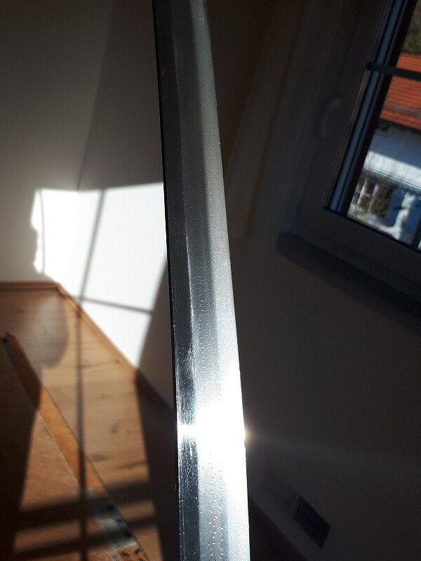

Thanks Paul for the kindly words. I will show to compare the hamon of 3 of my swords with suguha hamon. To see the difference.
1. Sadayuki (1813)
2. Masamitsu (1864)
3. Tsuguhira (around 1620)
4. Kanenori (1943)
post-3496-0-04805300-1510859492_thumb.jpgpost-3496-0-97003100-1510859503_thumb.jpgpost-3496-0-77042800-1510859520_thumb.jpgpost-3496-0-90156900-1510859789_thumb.jpg
You see the quality of a showa-to oil quenched, hammered, modern steel is very close.  :)
