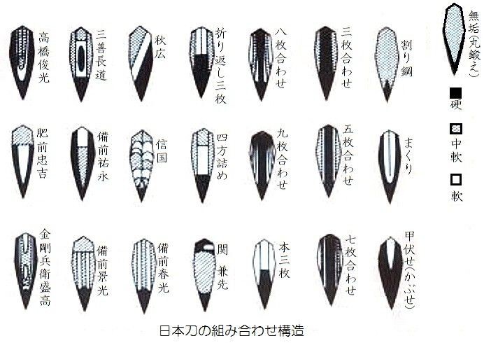

 I remember " Ryujin swords" (there is more than one firm using the name) mentioning going through the skin of a Gunto, after a Japanese polisher had refused to touch it, telling him it would just be a chunk of modern steel. In fact, it's the reason they did that very handy guide about Showa manufacturing methods, which now looks to have disappeared off the internet :( I will post that again, and also 2 very handy diagrams about construction of blades, and apologies if this info' is redundant.

I don't think that this general classification of methods is correct.
The smiths who took part on the RJT program made the swords in the way they have learned it.
You can't say they where made in Kobuse or Soshu kitae or what ever without destroying the sword.

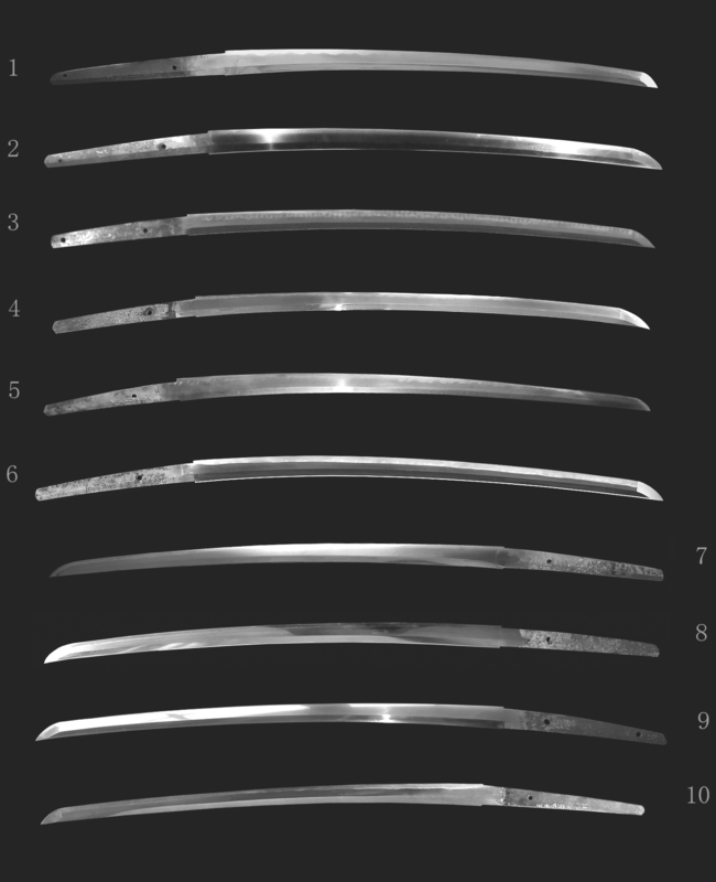

Here is my small collection of RJT gendaito. I have swords of all periods in collection but my true love are these RJT ones. If you compare the swords you see how different they are. The quality is wide above from most of that what you will in other periods. Not one sword has a forging flaw. These are strong swords. Some have a brutal cutter design, others are made as fast fighting swords. I love them all.
  • Wow 1
Yes, very nice Vajo...and not one sword has a forging flaw...same as my RJT swords - all excellent.
Thanks for the photo...nice collection, you are very fortunate to have them...smith names?
Regards,
Thanks George.
1. Masayoshi
2. Yoshitada
3. Munemitsu
4. Morinobu
5. Suketada
6. Okimasa
7. Masatsugu
8. Hisakuni
9. Akihisa
10. Morimitsu

Yes George. It is Tsukamoto Okimasa & Yamagami Akihisa.
The swords have a wide range of size, weight and design. You are so right. It is really fascinating to study and compare the swords. The RJT program allows a lot of variations in the scheme of forging these swords.
Looking on the different boshi and shape i find nearly all sword periods in that swords.
Chris, you are very lucky to have those two smiths, Okimasa especially. All your swords are good and yes, I agree, if you look carefully in RJT, you can see many "styles" of sword in them...I love to study them.
