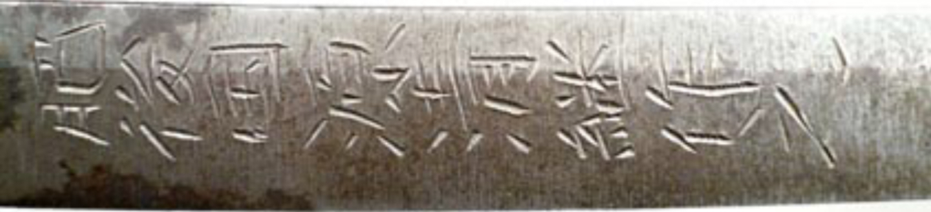

as to your initial question, sometimes the mei on the nakago doesn't leave room for a 2nd ana such that it has to be drilled through the signature.  that might be somewhat aesthetically displeasing, but assuming the second ana were drilled correctly, i don't think it would greatly alter the value of the sword particularly if you were selling to another JSA practitioner.  as an iaito, general use and wear, especially from tameshigiri, will be the main factor leading to depreciation of value.
this all assumes that your blade is actually a shinsakuto and not a gimei komonjo blade like this one currently for sale
http://www.ebay.com/itm/T48-Japanese-Samurai-Sword-Kiyotsugu-Katana-Bare-Blade-78-2-CM-/162707751582
if it's that one, it's a loooong blade for toyama ryu in my opinion and a 2nd mekugi won't matter one way or another.  but you said yours was from the 1980s, so it sounds like you have the real deal.
i have a 1980s blade by minamoto kunitsugu, by the way.  i would like to see your nakago.
The blade was bought from a renowned seller and is not gimei. And it has actually (almost) the measurements that Nakamura Sensei mentioned in Tameshigiri no Shinzu: 69cm Nagasa and 1.8 cm Sori.
