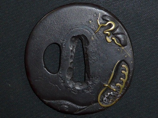

"sea cucumber" has been suggested, but I think that is a stretch. The silver inlay resembles caning that you might find on a chair seat (woven overlap) and this design element repeats on the verso. To me the design seems to hint at life springing forth (from the sea?) or something along those lines, but I don't know. Any help or even guesses would be much appreciated. Thanks

The upper ribbon shape may be a Buddhist symbol so if correct may be a starting point
Ahead scratcher indeed. :)  The upper element is only produced once on the front as you see. The lower element is reproduced again on the verso, with the same little doohickey that crosses over, the same silver inlay, same four fronds (for want of better word), and the waves.

Gabion - used in castle building and flood control
There were major floods in the Edo period, the debris, decay left in the aftermath became a theme...

Thomas, I thought you were joking at first, but what I read just now bears your thought out, even to the baskets. "Debris", yes, indeed I should have guessed :laughing:     Thank you

how about mine call to putt this Tsuba) to the Hikone school and tradition ...?
( this is a somehow,to ben tittulatet "small" - but still very respectet "derivate" school  with a lot of influence done for...( others).... - not a main or "standard" school per see!...

I believe that Thomas is correct.  The Japanese name for the basket shaped erosion control is take-jakago.  The tsuba pictured below has the exact same shapes and is described as a Jakago and is illustrated on page 91 of the book "Japanese Sword Guards - Art of War" by Gary Murtha.
George, thanks. I thought it might be wishful thinking trying to get it identified, let alone be able see the same design on another tsuba. Thank you, all of you; the depth of your knowledge is amazing.
Kind regards,  John               p.s. Might I conclude from the write-up that due to the thick inlay, this tsuba would fall into the class of Onin influence-Momoyama period?
