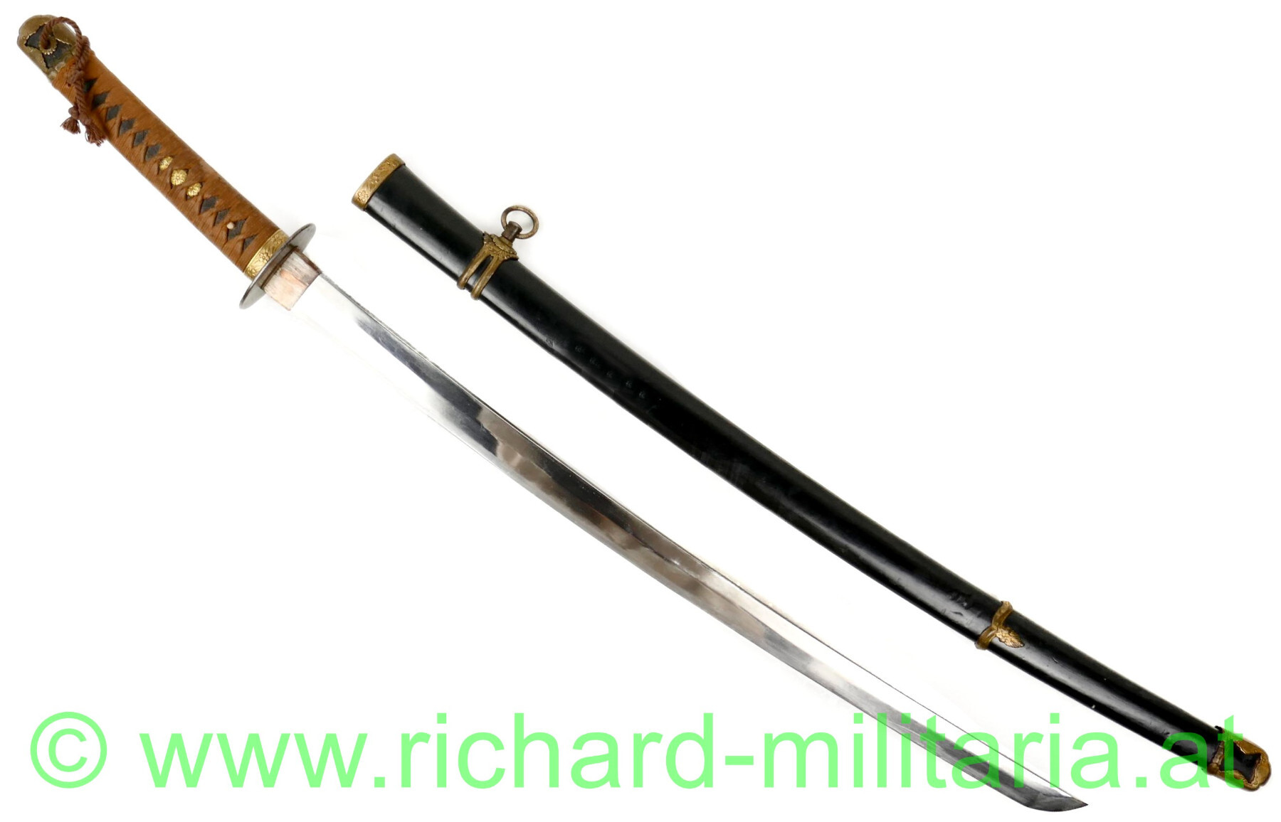

4 hours ago, Nazar said:
here is another one from the same site:
Good one, Nazar, thank you!  An interesting one, too, with that stamped "119."  Normally we see this on wartime blades, although I do have four others with stamped numbers.  I'm tempted to think this was a war surplus blade, but that unfinished nakago with heat coloration sure looks like something made by the souvenir operation.

Nice one, Nazar!  Shaped nakago jiri and no heat stains, so likely a surplus blade from war production.  Checking the chart, with our duplicate numbers, most have one blade that has finished jiri and the other/s do not, supporting the theory that the finished blades were surplus and the unfinished blades were made for the souvenir contract.
