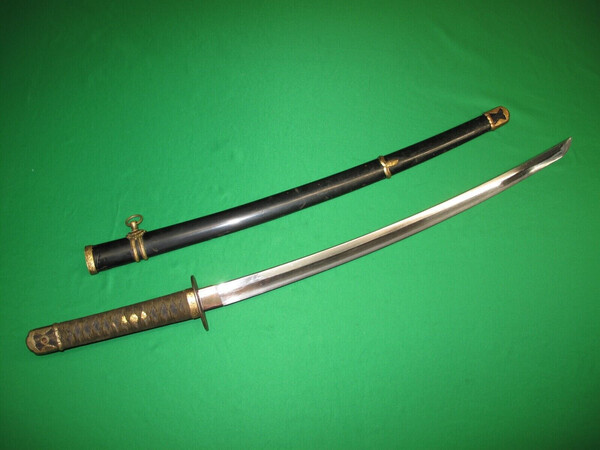

Nazar Posted May 17 Report Posted May 17 Another one. https://www.worthpoint.com/worthopedia/sword-authentic-wwii-Japanese-kai-4933955248 1 Quote
Bruce Pennington Posted May 17 Author Report Posted May 17 Thanks Nazar! This one is interesting because of the crack in the saya showing it was made with lacquer over cloth. I checked mine, and it was made of solid wood, then lacquer. Quote
Nazar Posted May 18 Report Posted May 18 My kai-gunto saya is also solid wood. I wonder if that cloth was used as putty (to make the surface more even) or for reinforcement? Quote
Marcin Posted May 18 Report Posted May 18 (edited) Probably to speed up production. Urushi with black dye (roiro urushi?) on cloth gives thicker layer. Edited May 18 by Rawa 2 1 Quote
Justin Grant Posted May 18 Report Posted May 18 Urushi on fabric is a well known Japanese Armor trick. You will find all sorts of pieces this way. It makes them strong and water resistant. 3 Quote
eternal_newbie Posted May 18 Report Posted May 18 13 minutes ago, Justin Grant said: Urushi on fabric is a well known Japanese Armor trick. You will find all sorts of pieces this way. It makes them strong and water resistant. You can even find some koshirae where the tsukamaki has been lacquered, ostensibly for the same purpose. 1 Quote
Marcin Posted May 21 Report Posted May 21 Boys look in other thread t98 with lacquered saya, clearly fabric under lacquer Quote

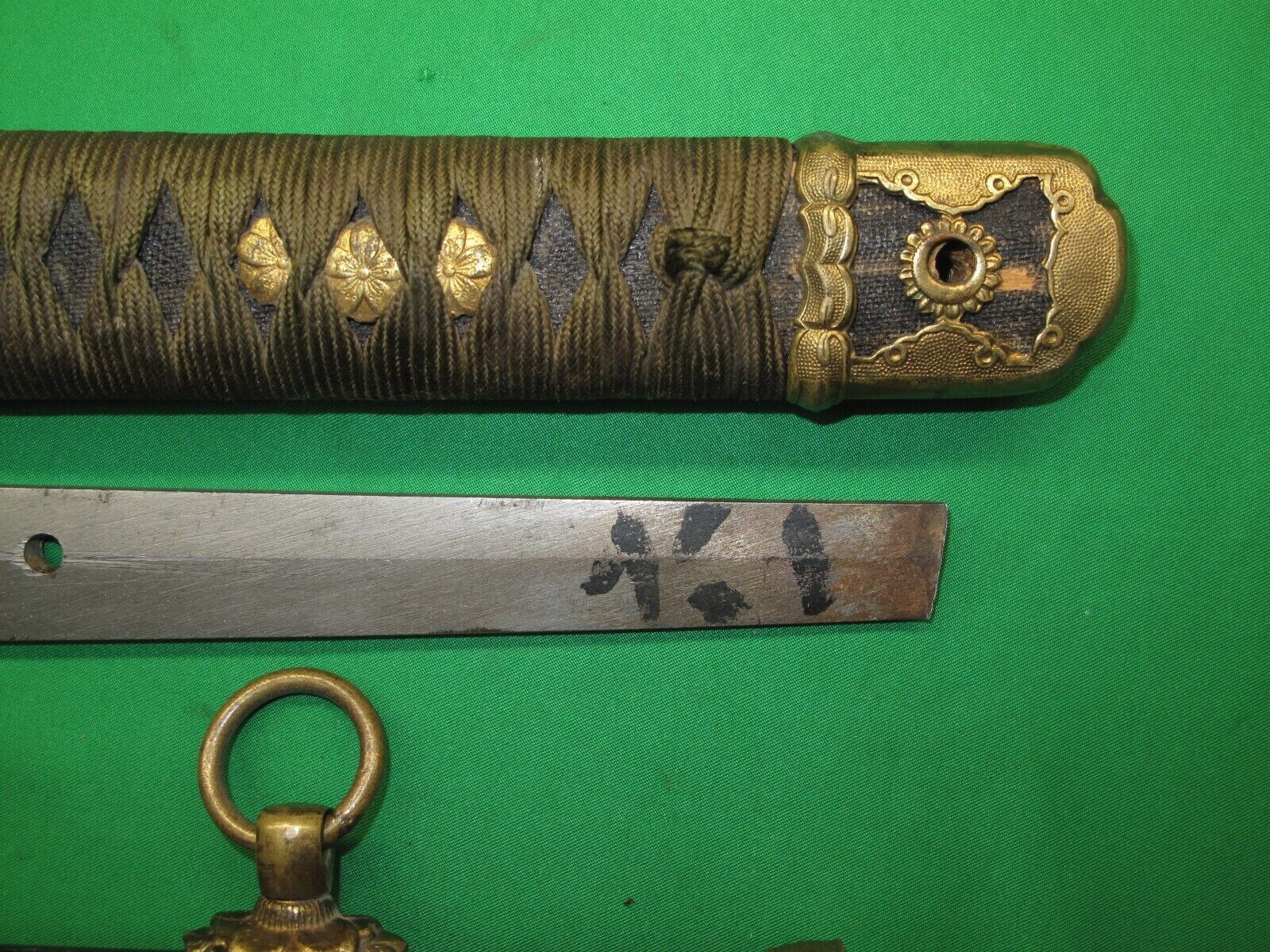

Nazar Posted May 22 Report Posted May 22 Yet one. This one is curious because of habaki fitment. I wonder if the reason for this mismatch is that they started to run out of parts that more or less fit each other? https://www.worthpoint.com/worthopedia/Japanese-ww2-navy-kai-gunto-sword-4728816675 Quote
ROKUJURO Posted May 22 Report Posted May 22 Nazar, I saw this as well, and I would like to see if the MACHI truly align. Quote
Bruce Pennington Posted May 22 Author Report Posted May 22 Yes, you can see on the zoom: It looks to me as if the habaki is just misaligned, shifted upward too much. 1 Quote
ROKUJURO Posted May 23 Report Posted May 23 Thank you Bruce, I can see it now. It is just a wrong HABAKI. It could be dangerous to handle the sword as the blade could come loose and the MEKUGI could just fall out. Quote
vajo Posted May 23 Report Posted May 23 The habaki didn't fit to the blade. Its not original. 1 Quote

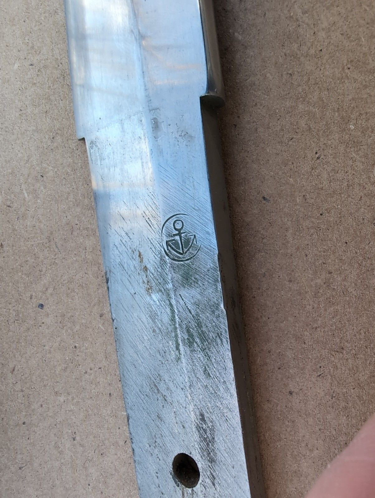

Marcin Posted May 23 Report Posted May 23 (edited) Double anchor stamp, did We had it already? It’s hard to memorize 23 pages https://www.antique-swords.com/zw52-ww2-Japanese-naval-officers-kai-gunto-gendaito-belts/ Could this blade have been replaced? Edited May 23 by Rawa 1 Quote
Bruce Pennington Posted May 23 Author Report Posted May 23 7 hours ago, Rawa said: did We had it already? That's a new one, thanks! I've written to the seller to see if he'll give us a full nakago shot. The belt is an unknown, as to whether the sword shop added it, or the G.I., or a post-war owner. Quote
John C Posted May 23 Report Posted May 23 1 hour ago, Bruce Pennington said: That's a new one, Bruce: What were the differences again between the small and large anchors? John C. Quote
Bruce Pennington Posted May 24 Author Report Posted May 24 John, We don't know. All we could do is make a systematic survey of naval swords to see if there is a timeline difference in use. Not even sure if one could identify location differences as most of these are mumei. 1 Quote

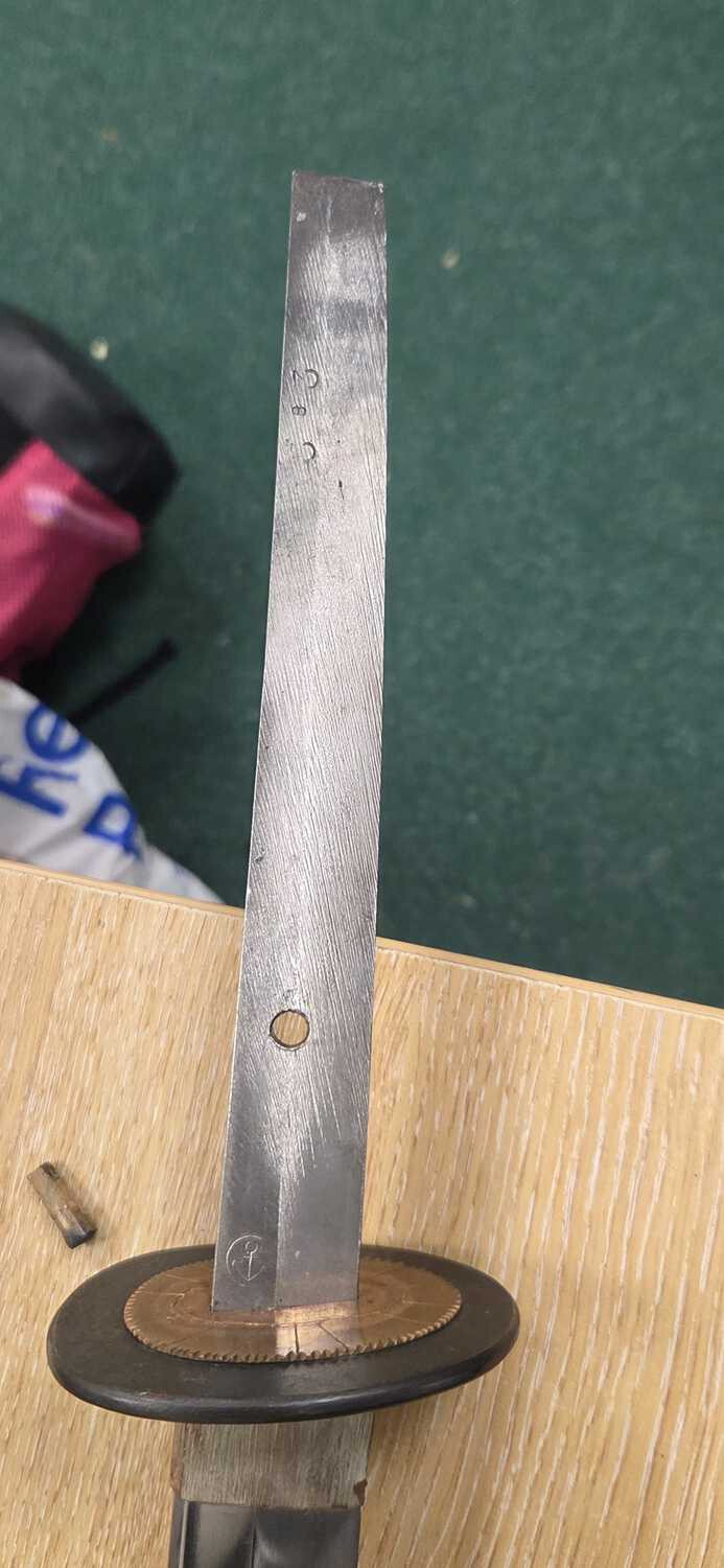

Bruce Pennington Posted August 18 Author Report Posted August 18 Interesting one shared by Rob @NotANinja HERE. The auction house didn't post a photo of the other side, so it might not have the black painted number. But it's one of a few on file with a stamped number. And some of them use this odd font with large-small-large numbers. So, that, plus sarute, plus leather saya cover. Oh, and the anchor is upside down!: Quote
