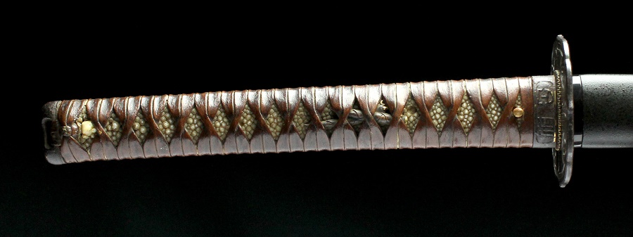

Stephen Posted January 2, 2017 Report Posted January 2, 2017 ther is paper, hans is doing a wrap for me, reported longer lasting than leather, first photo is old and new pre coating its folded over its self then lacquered. the finished look were going for 2 Quote

Greg F Posted January 3, 2017 Report Posted January 3, 2017 Stephen that looks brilliant, would love to see the finished product. Greg Quote
