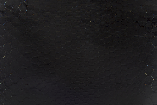

Gordon Sanders Posted April 25, 2016 Report Posted April 25, 2016 As many of you know, I am building a Daisho with a dragon and water theme I was thinking of the saya being black gloss with about 4-6 inches at the top wrapped in Black Seasnake What do you think? Should I just keep it as basic gloss black or add the leather? Quote

Gordon Sanders Posted April 25, 2016 Author Report Posted April 25, 2016 I have the swords, fk, menuki, tsuba. Pablo from unique Japan is my dealer and now it is construction time. I had seen saya with "same" on the upper pet of the saya about 5 inches or so. I had thought since it was water and dragon that a Seasnake skin might be nice instead of the same. Opinions are always good Somewhat like this 1 Quote

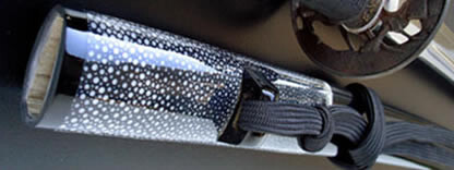

ggil Posted April 25, 2016 Report Posted April 25, 2016 If sea-snakes are black, and the rest of the saya is black, won't the finished product not look as interesting as the work could be if using a different colored leather? What does the sayashi say? Why not use shark or ray (that isn't black/dyed black), then you get the contrast of the nodules after they are polished down and the spaces filled with black urushi. with the snake I'm wondering what you are getting from the added costs and labor. Maybe the spaces between nodules would be filled with another color urushi so the skin would show off? I just don't know, so sorry for the post if it is just another waste of time, as this would be my norm, or giving out plain old bad info (sorry guys, I have a hard learning path it seems). One thing is for sure: the idea of creative embellishments on saya is very good, so I hope I'm not discouraging you in your efforts for such. -Grant Just googled snake saya and this popped up, but im wondering how an already black skin would show off. Quote

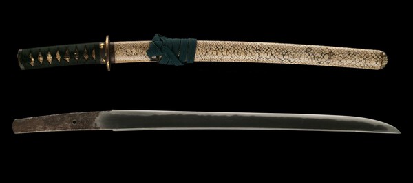

Stephen Posted April 25, 2016 Report Posted April 25, 2016 What Hans could do for you, when he gets back up and running https://www.facebook.com/koga.bijutsu/photos/pcb.567182903445404/567181456778882/?type=3&theater 1 Quote

Shogun8 Posted April 25, 2016 Report Posted April 25, 2016 As many of you know, I am building a Daisho with a dragon and water theme I was thinking of the saya being black gloss with about 4-6 inches at the top wrapped in Black Seasnake image.jpeg What do you think? Should I just keep it as basic gloss black or add the leather? I like the idea of adding your own personal aesthetic touch. It sounds like it could be a very interesting, subtle and elegant touch to add the black seasnake to provide a contrasting texture to the gloss of the urushi. I often like to work with the restorer/craftsman to "personalize" items that are being restored, by employing unique colour combinations, finishes, etc.. Since armour is my primary interest, it's fun to specify odoshi patterns, urushi finishes, etc. when restoration is required - as long as one remains true to the piece and period in question by employing appropriate (traditional) techniques, materials and aesthetic cues. I'm sure these tenets hold true for nihonto as well. Quote
