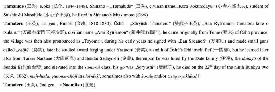

cabowen Posted December 23, 2013 Author Report Posted December 23, 2013 Through the help of a very kind forum member, I have received an example of the nidai Tamahide from a Shibata Rei catalog. In the interest of sharing info, here is how it roughly translates: Soryushi Tamahide (玉秀) was the son of Soryushi Tamahide (玉英). The shodai Tamahide was a very influential person among the tosho of the Sendai Han in the Bakumatsu period. At first, he was a student of the Ichinoseki smith, Takehiro Yasuhide. From that relationship, he was given an introduction to the school of Suishinshi Masahide's top student, Taikei Naotane and went to Tokyo. During the Bunsei period he returned to Sendai and the nidai Tamahide began training along with many other students. Thus Tamahide laid the foundation which made the Sendai branch of the Suishinshi group the strongest. The nidai Tamahide also went to Tokyo and trained in the Naotane school. He received the Nao kanji and signed Naomitsu. In Kaei 4 he returned home to Sendai. After returning home, he began signing Tamahide 玉秀. There is a gassaku work dated Kaei 5 surviving. His father, Tamahide died at the age of 71 in Bunkyo 2 and after his father's death, he again changed his mei, this time to Tamahide, using the same kanji as his father, 玉英, becoming the nidai. Here is an early work of the nidai done when he was 30 years old. A work that shines, done in masame, it is a work from Sendai that makes a deep impression. Tokubetsu Hozon. Quote

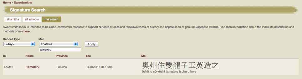

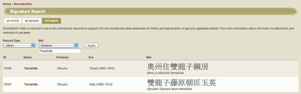

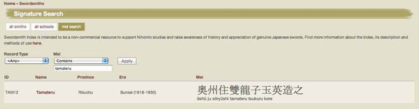

Eric H Posted December 24, 2013 Report Posted December 24, 2013 Some additional information on Tamahide / Tamateru: In the reference books (Sesko, Hawley) shodai and nidai are listed as Tamateru. Nihonto Club..from Tsunafusa - Tamahide - Tamateru. Eric Quote

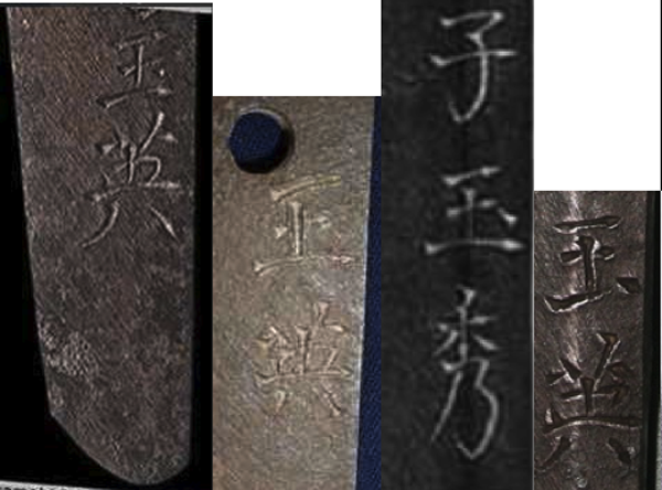

Eric H Posted December 25, 2013 Report Posted December 25, 2013 I believe the nijmei is by the Nidai Tamahide. Eric Quote

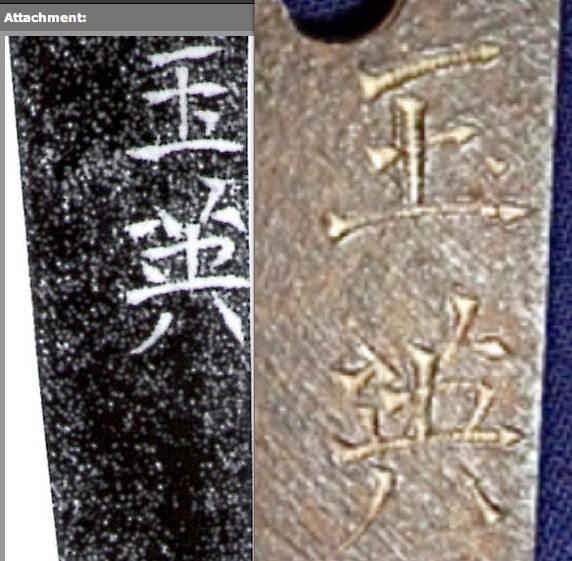

cabowen Posted December 25, 2013 Author Report Posted December 25, 2013 The middle two oshigata are the shodai I believe Eric. The "ryu" 龍 kanji has a distinctive difference among the 10 or so verified oshigata I have assembled. Look at the right side two horizontal strokes; the shodai's are like commas, the nidai straight horizontal strokes. Here are verified examples of the "ryu" kanji from both shodai and nidai: Shodai: Nidai: Verified examples of the shodai's mei in the next post... Quote

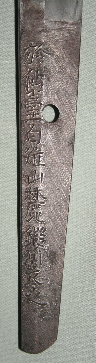

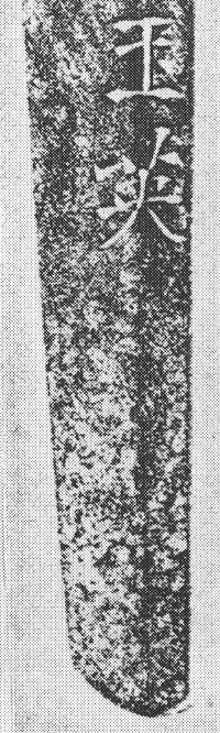

cabowen Posted December 25, 2013 Author Report Posted December 25, 2013 Here are verified examples of the shodai's mei...The nakago jiri is also consistent with the mei on my blade. One final thing that has me leaning toward the shodai is the age of the patina on the nakago. The nidai did not start using the Tamahide 玉英 mei until after the death of the shodai in Bunkyo 2. The nakago patina of mine seems too old to be the nidai's work. Of course that isn't definitive, just another piece of info.... Very much appreciate your contributions. Quote
Eric H Posted December 26, 2013 Report Posted December 26, 2013 Mei change over time, more or less. The „ryu“ kanji is convincing in differentiation between the Shodai and Nidai. Are there Nidai examples with mei after his father‘s death? Table from left to right: Shodai approved your Wakizashi Nidai Shodai Eric Quote
cabowen Posted December 26, 2013 Author Report Posted December 26, 2013 I have an oshigata of the nidai done after the death of the shodai with the same kanji as the shodai but it is poorly reproduced and thus the finer points are indistinct. Here is a verified shodai that to me looks very close to mine: Quote
