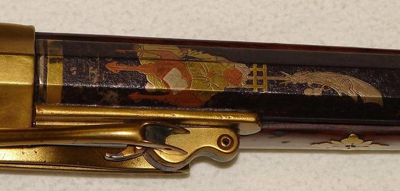

Dear Brian,
You noticed too. I did not comment on the fact that the inlay depicts an apparent Westerner. I commented instead that the inlay was amateurish and poorly executed. This is one of the reasons I give for thinking the gun is rather late production.

I hesitate to add to the expert discussion that has already been presented here, but this gun brings to mind some matchlocks I remember seeing in Tohoku. Up there, country folks had and used old matchlock guns for hunting. These were used by both farmers and 'matagi' who were full time commercial hunters. You can see guns in amongst "mingei" or 'folk art' that look like old tanegashima that have been much used and rustically maintained.
Here on the Plains, gun slicks are used to seeing old army rifles that fit that descriptions. They refer to them as "cowboy'd." Whatever you call it, I think that gun shows some "non-samurai alternation."
I LOVE the barrel inlay and I think the gun would clean up nicely.

Here's an example of a barrel inlay from a Sakai Tanegashima dated 1825 that I own. It depicts Kwanyu , a celebrated Chinese General of the 2nd century deified by the Japanese in 1594 as the God of War. He is usually depicted carrying his large spear. The inlay work is finely done in brass, silver, and copper. Now compare the inlay of mike's example. Usually if we find inlay on the barrel of a Tanegashima it is of very high quality.
... Ron Watson
Ron, is it not so that had the gun you posted been battered and neglected for countless years, the inlay work might have looked the same.
Not saying that yours is not better quality, but I have seen antiques of the same maker (Thomas Chippendale) one in pristine condition and one in an absolute detrimental condition which to the naked eye could not have been by him, but actually was.

Mike, if you do get the pan and lid restored, look at Ron's example above this post for what to aim for. Notice the ama-ooi between the pan and the barrel, and the hollow hinge pin. Your gun still has many good things going for it and on top of some thorough TLC as Ron suggests, could be restored by someone with the right understanding and equipment, depending on where you are based, of course. Either way, it will look great on the wall.
Ron, I am tempted to re-post my Kozuka Kwan-yu as he looks similar. Well, they all do... hahaha.
viewtopic.php?f=2&t=16473&hilit=nagatsune
Wow, this discussion has gotten ahead of me. The quality and condition of the Kwany on Ron's gun is superior. the inlay on Mike's gun has serious "condition issues". But I still say that it is an interesting and unusual image. We rarely see human images on guns and this one has an interesting stnace andlook. Clearly the face has been serious marred, recut? moved?. I still think it is worthy.
