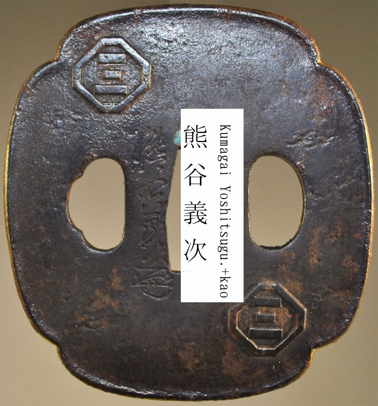

kissakai Posted July 13, 2013 Report Posted July 13, 2013 A couple more queries I'd like help with I know they should possibly been on the translation page but as I had a couple of other questions I added it to this page Umetada mei = Masa or is it a kao This was described as Seiriuken Yeijiu but I'm not convinced Teruaki with kao I found a reference to this mei and kao on the internet from a book called 'Japanese Sword mounts in 'Collections of Field Museum The maker was around 1860 but not sure about a school My Daisho I bought this on Ebay a few weeks ago as I was drawn to the cloisonne work and it is a Daisho set I presummed it was modern (around 1950) I then saw this on the internet: Aoi mon tsuba, Hirata, 19th century Shakudo mumei Hirata shippo yaki Aoi-mon (Tokugawa family crest) motif, end of Edo period, 19th century Aoi mon tsuba, Hirata, 19th century Published in the book Tsuba – Japanese sword hanguard Do you think this is right? If it is then obviously better/older than I thought Thanks Grev UK Quote

IanB Posted July 13, 2013 Report Posted July 13, 2013 Grev, As John will happily confirm I wouldn't know a tsuba from a dustbin lid, but the first tsuba looks to be signed Masatsugu 正次 to me. The second one is industrial strength sosho, but at least I know the kamon is Inaba family. Ian Bottomley Quote

k morita Posted July 14, 2013 Report Posted July 14, 2013 #2 tsuba mei says "Kumagai Yoshitsugu +kao". 熊 谷 義 次 Quote

docliss Posted July 14, 2013 Report Posted July 14, 2013 Thanks to Morita's expertise, we now know that the maker of this tsuba is listed as H 12262.0 in Haynes' Index .... John L. Quote
