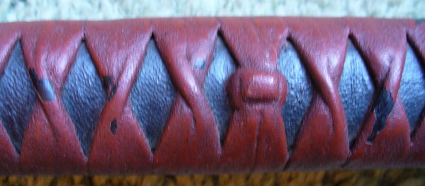

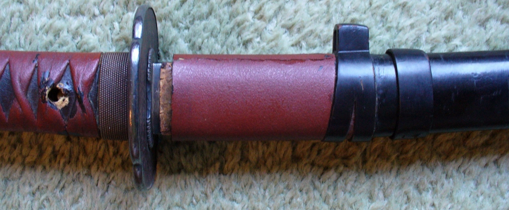

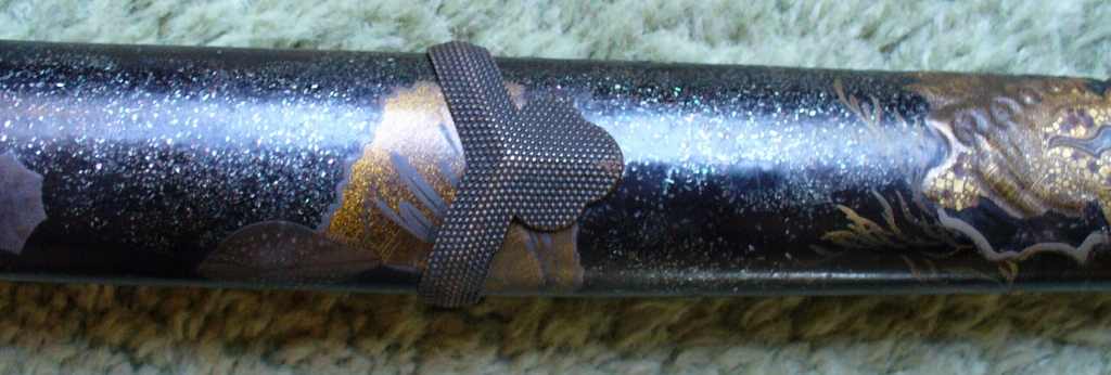

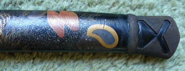

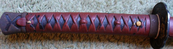

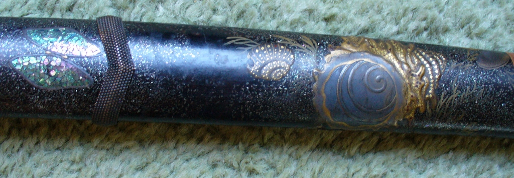

DGARBUTT Posted May 25, 2013 Report Posted May 25, 2013 I have attached pictures of mounts that I find unusual. This sword was brought back from Japan after the war and has been in the family since then. The fittings are all copper with a plain nanako ground. The tsuka appears to be leather wrap over leather, no same. The leather wrap has been lacquered black and then red. There are no menuki, instead two knots have been made on each side of the wrap where menuki would normally be placed. The saya is black lacquer with fairly elaborate decoration of an undersea scene with shells and sea life. There are two metal hangers on the saya one similar to a tachi hanger and the other on the side. The hanger on the side slides and appears to have been intentionally made that way, almost like a moveable kurigata. There is no sign that the side hanger it was ever secured to the saya. The tsuba appears to be late Edo of a devil mask. The suriage blade is signed Kashu Haryoshi and date Eisho 12. I cannot find any reference to this smith. I have posted the signature in another thread. I welcome your comments as to the style and age of these mounts. This katana will be for sale shortly. Quote
kaigunair Posted May 25, 2013 Report Posted May 25, 2013 I like the lacquer work on the saya. The nanako work on the fittings seems decent enough. Maybe a theater use item? Would explain the Noh mask themed tsuba...(I'm not a fan of the tsuba). Hope the blade is something. Quote
Soshin Posted May 26, 2013 Report Posted May 26, 2013 Hi Dale G., I don't see any connection between the designs on the tsuba and theme on the saya. I was lucky enough to see the saya in person and it is really remarkable in quality in terms of the lacquer work. Could the tsuba be a old replacement before World War 2 that fit and balance the sword blade well? Just some ideas off the top of my head. Quote

Brian Posted May 26, 2013 Report Posted May 26, 2013 I'm still trying to decide if I like the ensemble or not...it certainly is unusual and a-typical and I think is probably quite desirable. It certainly makes a statement, and cannot be called bland :lol: The saya was a later pairing maybe, being of an undersea theme, and well done. A composite koshirae, but quite unusual fittings. Brian Quote

Bazza Posted May 26, 2013 Report Posted May 26, 2013 Maybe made for the Theatre, so ito could be seen from a distance...just a thought Shooting from the lip here - I can imagine a tanto being worn to the theatre by patrons, but not a katana???? Also, I meant to comment on the "sliding ashi" - I once had a tachi with handachi tosogu and one of the ashi moved freely along a contained length similar to the one Dale has shown. Regards, BaZZa. Quote
