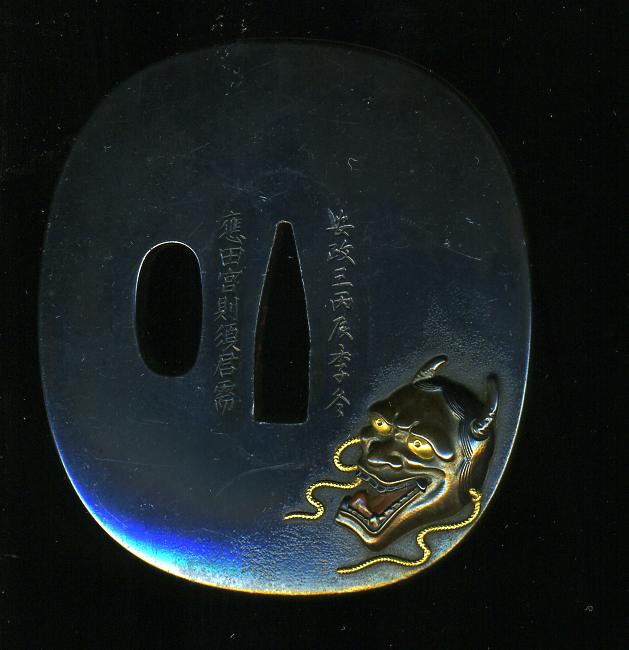

Curran Posted January 29, 2013 Report Posted January 29, 2013 Junichi- Yes. Saw quite a number in the 1850s & 1860s. Attached: NBTHK Tobuketsu Hozon Commissioned piece for Mr. Taima c.1856(?) Signed on the back on the open area: Yasuchika w/ Kao (6th gen Yasuchika, aka Masachika. Took over the school. not to be confused with 1st Gen. Gen 2 to 5 were in decline, then revival as with Ichijo of Goto school). Quote

kaigunair Posted January 29, 2013 Author Report Posted January 29, 2013 Lovely example Curran. Thanks! Looks like Japanese natives were commissioning them for gifts at that late date. You say most of these pop up in the 19th century? John, AH! Kenjo Tsuba Thanks again! From another website, it states that kenjo refers to gifts given from one damyo to another. So this might point to an older practice and the term *might* preclude the lesser work (i.e. shiremono), esp if its supposed to be a gift to a feudal lord. (unless you didn't like the guy, nor value your life.... ) Oh to be such a discerning collector that people would shower me with such gifts (or the one who holds your life in his hands)! When it comes to kinko tsuba collecting, its hard enough not to be the one "...whose money is soon departed..." Domo arigato gozaimasu, sempai-sans! Quote
