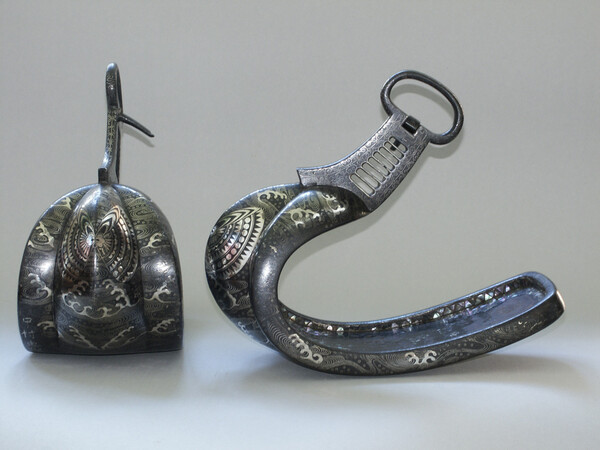

Shimazu Posted January 8, 2013 Report Posted January 8, 2013 Hello, I hope a question about abumi is appropriate for the NMB. Unlike any other abumi I have, these have kanji located prominently on their front face. My reading is 中村恵賢, with the last kanji being in doubt. It is not quite the same as on the abumi, the upper left element appearing different, but I can’t find anything closer. Assuming I have the last kanji is correct, a possible reading of these kanji is Nakamura Keiken. My questions are: * What is the correct last kanji? * Is this a signature, or something else? It seems to be in a very prominent position for a signature, especially on a piece that was owned by somebody that could afford these. I have been unable to locate any artist or place using these kanji. Thanks, Jack E Quote
Bugyotsuji Posted January 8, 2013 Report Posted January 8, 2013 They are beautiful! There is someone I am meeting on Sunday who might be able to answer your question, but he doesn't have e-mail so I will wait till then and look for an opportunity if I am not too drunk. Quote
John A Stuart Posted January 8, 2013 Report Posted January 8, 2013 I think you have the correct kanji. 中村恵賢 Nakamura, probably and Shigetaka among many readings. So, Nakamura Shigetaka??? John Quote

Shimazu Posted January 8, 2013 Author Report Posted January 8, 2013 John, I like the Shigetaka reading better (if it's even a name). I don't know why I chose Keiken. As you said, there are many possibilities. Thanks, Quote
John A Stuart Posted January 8, 2013 Report Posted January 8, 2013 Hi jack, It must be a name; it makes no real sense otherwise. John Quote

Bugyotsuji Posted January 13, 2013 Report Posted January 13, 2013 Showed your Abumi to an expert in Japanese armour/armor today. They look like Kaga work he said, and the name there is typical of Kaga Zogan artists. The Abumi themselves are Edo, he said, and he made a note of the name and promised to find out more and let me know. Quote
Shimazu Posted January 14, 2013 Author Report Posted January 14, 2013 Wow, thank you Piers! I have been collecting abumi for years, and, so far, I only have one book that covers abumi (Kaga Han no Wasa to dezein KATCHU – ABUMI - TOSOGU). It is in Japanese with many photos, but, other than names, dates and terms, the majority of the text is completely lost to me, as I do not speak Japanese. I have almost given up learning much more about Abumi. I truly appreciate you showing these abumi to a Japanese expert. I will watch this thread for anything you are able to relay back to me/us. Thanks again, Quote

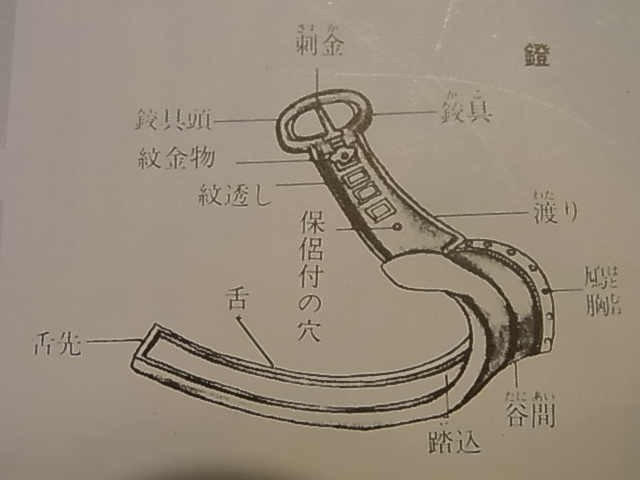

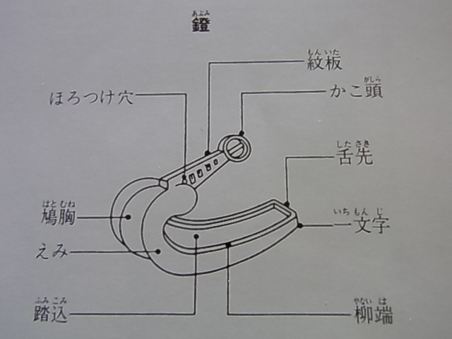

Bugyotsuji Posted January 18, 2013 Report Posted January 18, 2013 Jack, there are several pages in Sasama showing some evolution in Abumi, pp 411-422. In another book I found a detailed illustration with the names of the Abumi parts. Do you need the readings in English? Quote
Bugyotsuji Posted January 18, 2013 Report Posted January 18, 2013 Oops, there's an illustration on p416 in Sasama too. Quote

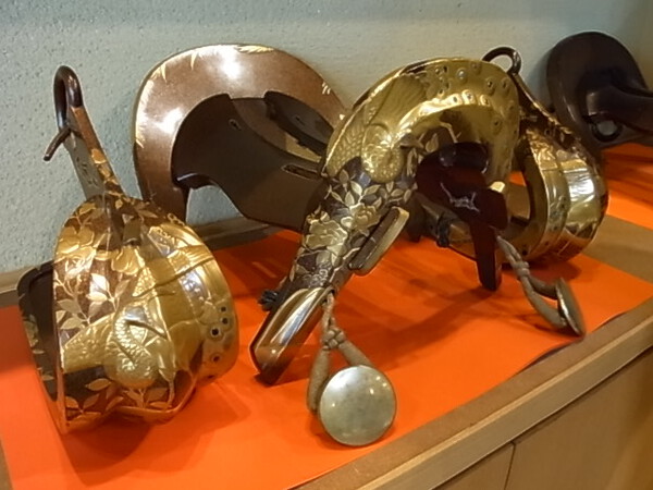

Shimazu Posted January 18, 2013 Author Report Posted January 18, 2013 Piers, Thank you for the references, diagrams and info. I don’t have the books you mention, and appreciate you posting the diagrams. I am able to translate the labels on the diagrams, so at least for me, you don’t need to bother translating them. Your comment that older abumi are generally longer than newer abumi is very interesting and valuable information, something I will eagerly investigate. The lacquered Kura and Abumi you posted are beautiful, and bring up another question I have had for a long time. Every pair of lacquered abumi I have ever seen has a “three diamond” pattern just under the ‘buckle’ on the side facing away from the horse. I have never seen this mark on the matching saddle. Does anybody know the significance of this design on lacquered abumi? Thanks, Quote
estcrh Posted February 27, 2013 Report Posted February 27, 2013 Jack, there are several pages in Sasama showing some evolution in Abumi, pp 411-422. In another book I found a detailed illustration with the names of the Abumi parts. Do you need the readings in English? Piers, I just saw this post, if you ever get a chance to list the translations it would be helpful, nice diagrams, thanks. Quote
