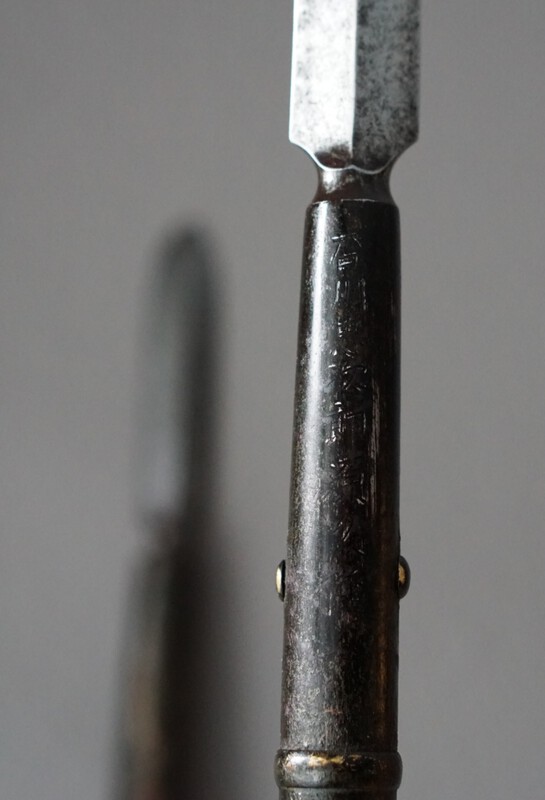

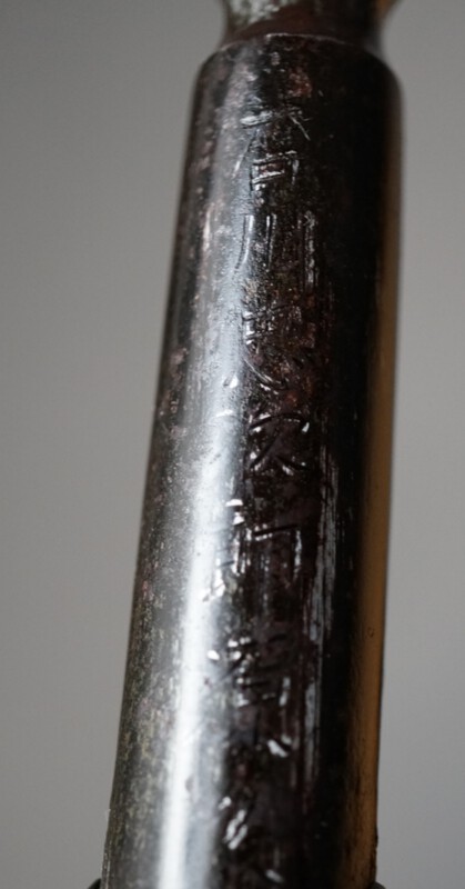

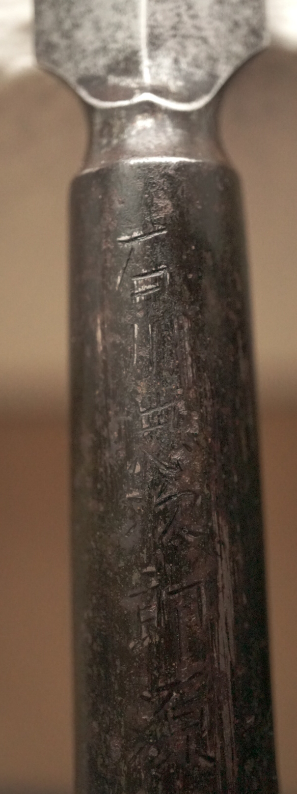

Fukuro Yari mei, need help
EdWolf
Thanks Brian, but chikushu doesn't seems to fit. I believe the signature starts with Sekishu but the rest is almost impossible to read.
Ed,
Why not try an honest-to-goodness oshigata.  Even a B pencil on A4 bond 80gsm paper might be better than a poor photograph.  Then copy it and try to "fill in the blanks" on the copy.  Use magnifying glasses in different lighting to trace where strokes go...
Bestests,
BaZZa.
Looking like 石川忠次郎源囗囗 (Ishikawa Tadajirō Minamoto ?)
or possibly 石川定次郎源 (Ishikawa Sadajiro)
Agree appears to be Tadajiro
Character after minamoto looks like Hisa.
Need better lighting or chalk to see the last one
Steve, that's really impressive!
Thanks Matt for sharing your thoughts. I shall try to make a better picture soon.
