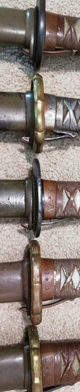

Fake Kokura Stamp?
kotkinjs1
I'm with Paul. That Tokyo inspector stamp beside it and the contractor stamp are harder to fake and they look right. Steve (Shamsy) says he's seen many variations on this stamp, so as long as the rest of the gunto look right, which it does (so, ok, the Tokyo stamp on the blade by the serial number looks weird) I think you've got a good one there.
It's fine. As Bruce said, there are dozens of variants to the cannonball, larger, smaller, bigger rings, smaller rings...
If I remember tonight I can post some examples if people are interested.
I would love to see some of the extremes. It's the one that I often call "fake" on, and then it turns out to be legit, so I could use some education on this one.
