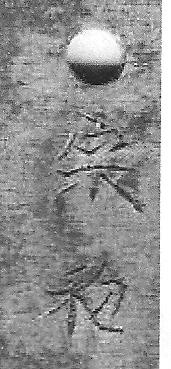

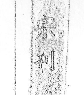

elder brother is Munetoshi ( pic munetoshi1 is early mei 1941-43 and pic munetoshi2 is later mei)

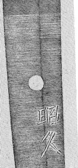

younger brother is Akihisa (his mei stayed the same).

I have one AKIHISA sword you mentionned. There is no date, mountings are type 44 high end, and there is a star stamp. I will send you the other details later on.

Sorry I've taken so long to get back to you George. My Munetoshi is the same as the one you have posted here after Akihisa. It is signed the same way as the one in John Sloughs' book,page 121

BTW...had a little bonus last week, my ebay purchase Munetoshi (3rd pic mei) in high quality Type 3 fittings and "matsu" stamp arrived, and when I took the tsuka off (2 screws) I found a Star stamp...what a pleasant surprise...wasn't shown in pics or mentioned in description...so, I'm very pleased.
