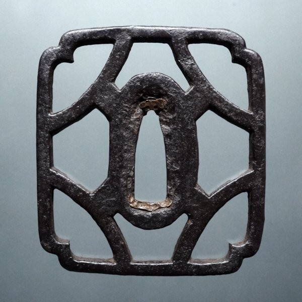

Re. the enso motif: when I said I had not seen another with the enso motif, I meant specifically in the "square with notched corners shape" (sumiiri-kaku-gata), otherwise there are many diverse examples of enso motifs.
As an aside but still on topic, I have just recently seen two Kanayama tsuba with this sumiiri-kaku-gata shape, but with the more typical Kanayama tekkotsu on the rim as opposed to the more Yagyu looking layers you showed in yours with the open grid sukashi @Tim Evans, which is an interesting piece :thumbsup:
One of the ones I saw had a slightly more elaborate grid pattern (a cross like yours but with "windows" in each arm of the cross shape).
So I think it is now safe to assume that there was a stylistic overlap between the two groups at this point in time (sometime in the early 1600s to mid 1600s)... and/or that some smiths working in the Kanayama style were commissioned or recruited to make some tsuba in the Yagyu style (or so the legend goes...without any period documentation to verify it).

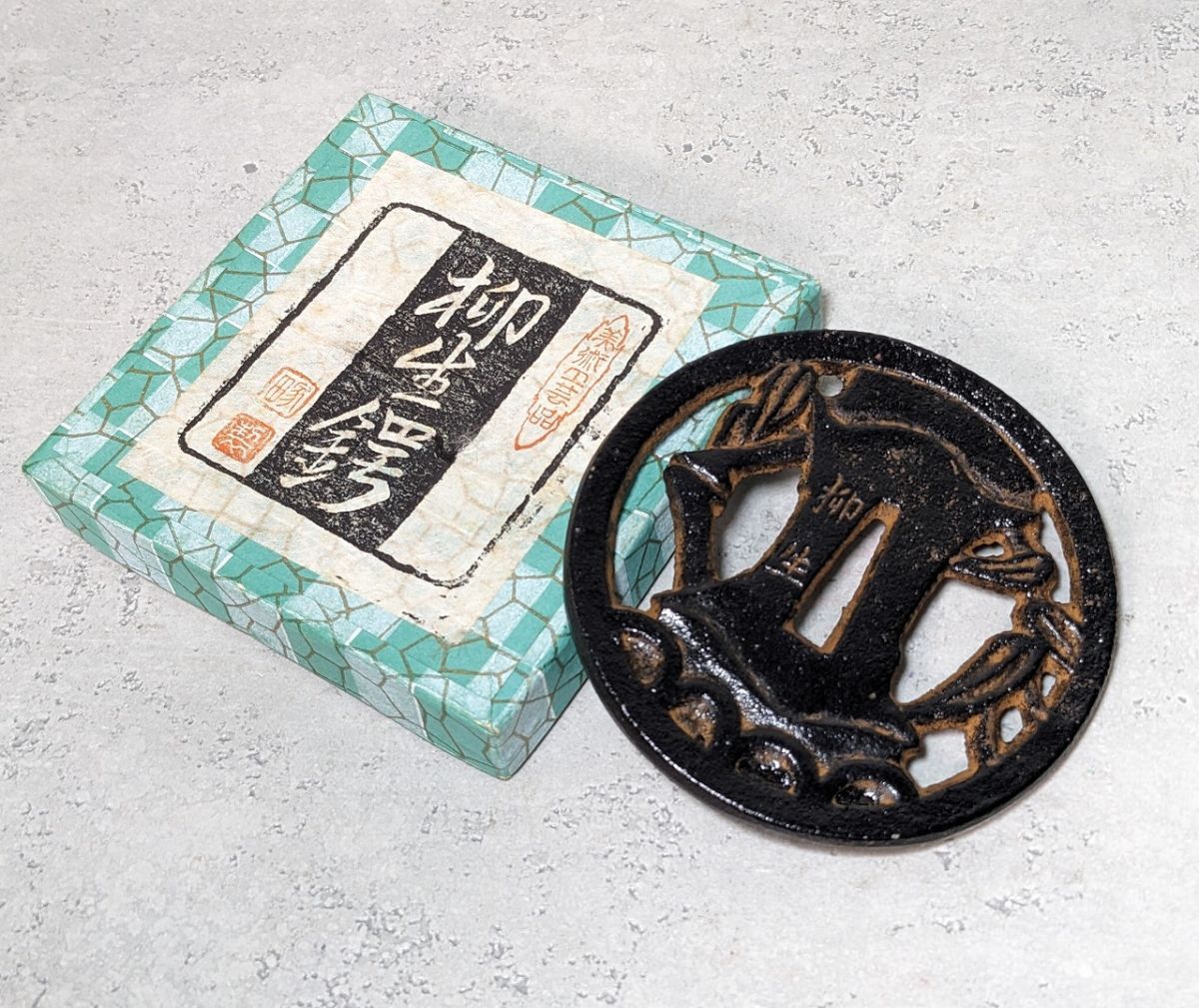

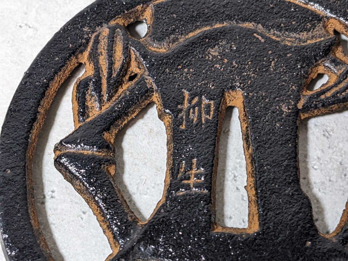

Interestingly enough, this just popped up... a signed modern casting, in a box printed with "arts and crafts Yagyu tsuba" that comes with a general information sheet about Yagyu tsuba:
Apparently produced by "Ieda"? I have no idea what company or organization that name belongs to.

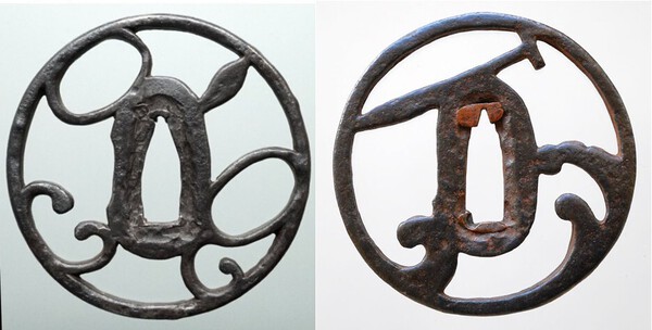

So here's a definite problem with the whole papering business for "Yagyu".
The fact that there were so many smiths commissioned to do Yagyu style tsuba (with no extant all-encompassing pattern book), makes it nearly impossible for any organization to identify Yagyu commissioned pieces unless they fit neatly into the more obvious patterns.
It becomes essentially a black box of unknowns, and organizations like the NBTHK have demonstrated time and again that they don't deal well with unknowns. If it doesn't fit in the preconceived box, they don't know what to do with it and have a range of attributions outcomes.
And in the face of unknowns, the NBTHK (and collectors) have a clear pattern of reverting to what has already been "established"... which creates its own feedback loop that closes off any oppenness to broadening the group through comparative analysis. i.e "this is not like the others that we already certified, so it it not one of these..."

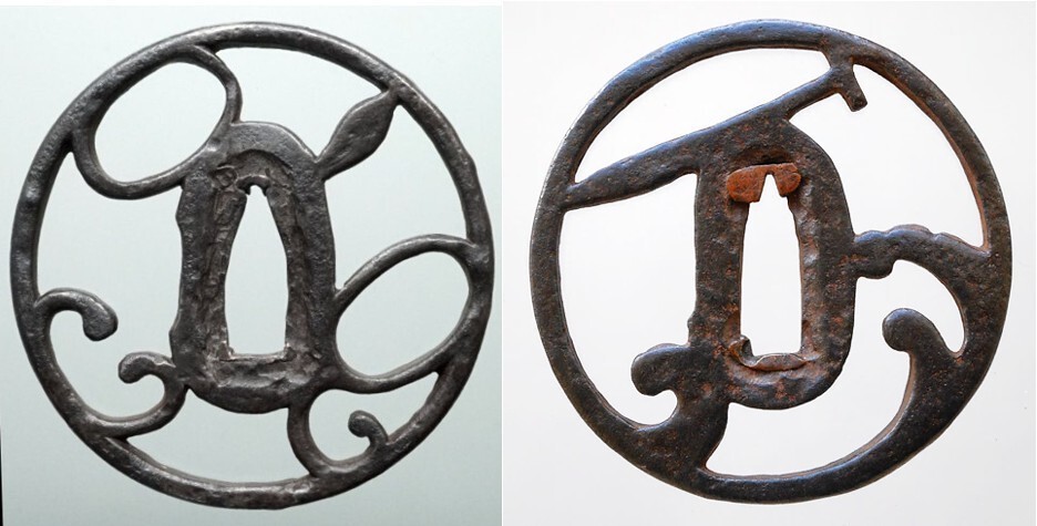

It's like those two small, but unusual "Owari" tsuba I showed you in San Fran whose aesthetic aligns somewhere between YKB (in sukashi aesthetic), Kanyama (in surface treatment) and Yagyu (in stylistic sensibility of the bamboo type and the oar & waves type)...
,image.png.257bb8cab7c57aa6819e84666dae367a.pngimage.png.0ce29525ea215509c675c6bef7d3c147.png
and the one "Kanayama" that shares so much aesthetic overlap with Sasano's published "oar & waves" tsuba that he attributes to Yagyu.
I always thought the oar & waves stood apart from all the other Yagyu examples, so much so that it should probably be separated out into a separate group.
So it's another "hot mess" really... in terms of assigning an attribution because there sure aren't any mei on any of these (not even a messy one! ;))
Again these are the kinds of examples that strongly point out the flaws and lack of depth in the current system that was primarily established by Akiyama in the early 1900s, but has remained relatively ":fixed" until Sasano's tinkering and resetting of the timeline and creation of "ko-shoami"... a whole other bucket of worms that doesn't need to be addressed in this Yagyu thread. ;)
