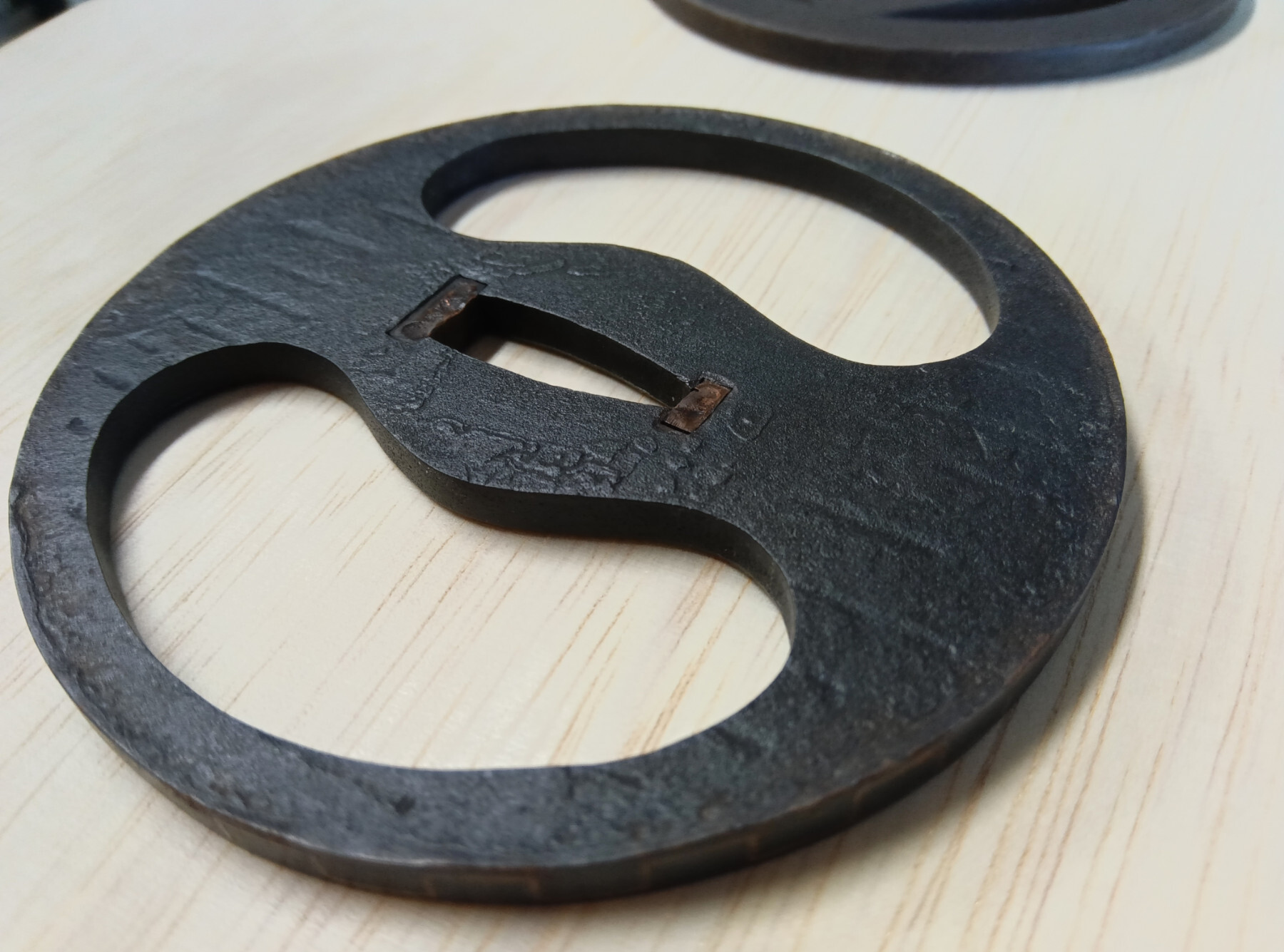

To add, I have tried to have "fancy" surface by leaving a tsuba in a 1000℃ furnace (electric) in air, for an hour or so. It does result in a surface that seems to have partially melted. It was completely uncontrollable though.
  • Love 1

what type of metal were you using when you tried to get the desired effect?
I used a piece of "steel", bought from an online shop called Haganeya. I suspect it is SS400, so low-carbon steel.
9 hours ago, ROKUJURO said:
The surface of a TSUBA may indeed LOOK LIKE MELTED  (perhaps something like TOKA ME in Japanese), but it is definitely not!
In my case, it is likely coming from non uniform scale growth. You can see in the photo what it looks like. I did the heating prior to anything else. So it messed up the seppa dai, and I was too lazy to shave it smooth...
In the end, I soaked the tsuba in warm citric acid for a couple of days.
Edited by OceanoNox
added information
Thank you Arnaud!
Your results are exactly as expected! Higher temperature would have produced still more scale but not a "melted" surface.
Jean, now my issue is that I used an electric furnace without option to control the atmosphere. I have no idea how it would look like for the same piece heated in a charcoal fire for some time.

Utsushi of a Higo tsuba:
Utsushi of Yamakichibei with an otafuku-shaped guruma motif:
Utsushi of an early Hoan style irregularly spaced rays motif (a variant from the more typical guruma motif):
So that seems to hint at getting back to the idea of material composition as a significant contributing factor for the outcome.
I have a strong suspicion that the effect will not be effectively achieved by using modern produced mono-steels with fairly even distribution of component materials in the alloys.
i suspect using the right grade of steel from the right type of sand iron formed in a tatara will be a critical key to unraveling it all...
but we shall see... i hope ;-)
Edited by GRC
  • Love 1
By the way, those images came from this forum thread:
along with this one as another Higo utsushi example:
  • Thanks 2
