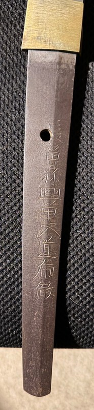

While going down the Kotetsu rabbit hole I came across a video made by Markus Sesko at the New York Token Kai from November 16th 2016. The video was about the famous forger Kajihei and how he would forge Naotane and Kotetsu signatures. Kajihei was said to be so good at these forgeries that at the time hardly anyone would be able to discern the fake from the real signatures.
  Now in no way am I implying this sword I own is a real Kotetsu or a Kajihei forgery. I’m just curious if anyone has any reference material they are willing to share of a Kajihei Kotetsu forgery besides what I’ve already seen from Markus Sesko’s site because I find this subject very fascinating. I’d also be interested to see if any of these forgeries have ever came up for sale.

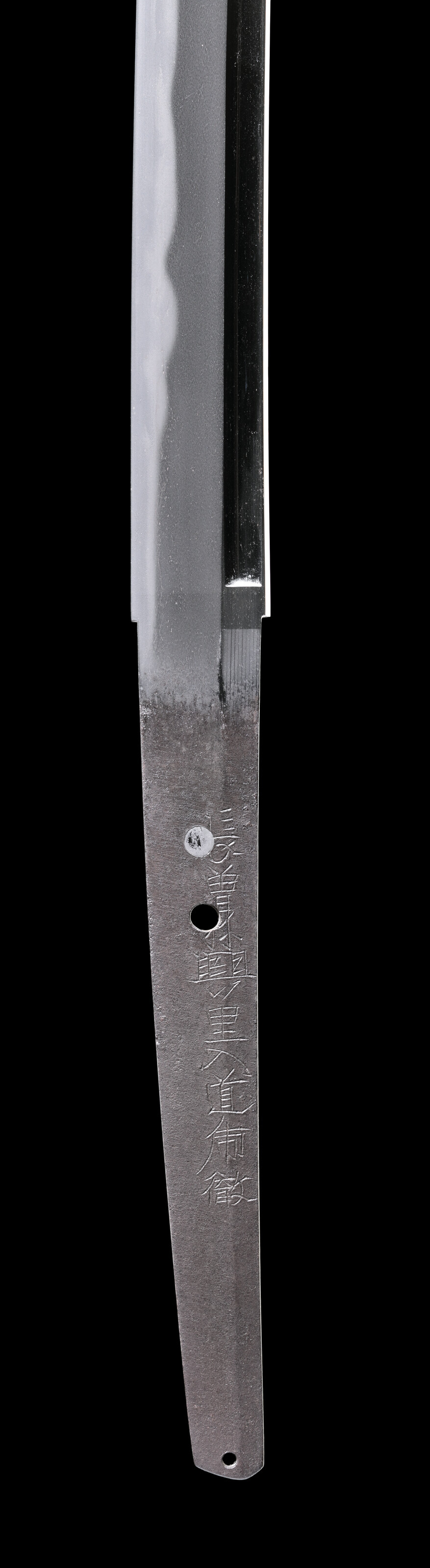

Nice riddle.
It is about tiny details.
From left to right:
shoshin (genuine) Kotetsu, Kajihei and the mei in question.
Can you see the "catch me if you can"-attitude?
reinhard
Yes, who ever chiseled the mei did a good job trying to copy Kotetsu but fell short on the small details. You can also see the difference between the shoshin and the Kajihei cut mei as well but it’s far closer than the sword I own.

The mei on your sword is very close to Kajihei's, as far as I can tell, Nicholas.
reinhard
In my opinion it’s closer to Kajihei than to Kotetsu. I also wouldn’t be mad if it was a Kajihei forgery I find his story fascinating.
