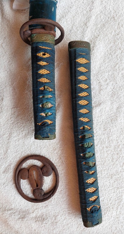

The saya is not original, my father ordered custom ones. The tsuka we are not so sure, they might have been ordered as well as the wrapping is amateur and the material is wrong. But the other pieces as the tsuba, huchi and kasira I can't tell.

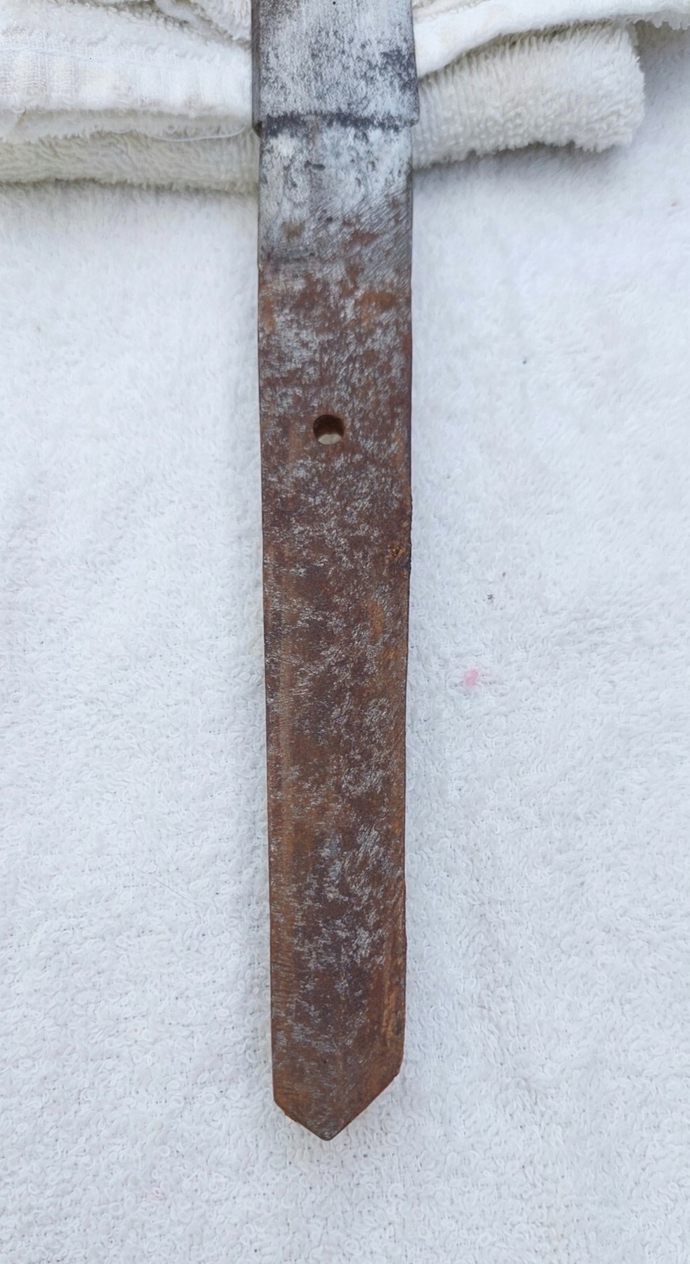

The nakago is very rusty and doesn't seem to have any stamps but the rust could have covered it. My guess is that these aren't real layered blades, but they aren't contemporary e-bay replicas as well.

Don't like the "pointy" end to the nakago on the one...this is usually a sign of a fake. But we would need more pics of the tang and blade to tell for sure. Left one appears genuine and old, but we do need far better pics.

- The fittings are very low quality, lack seppa, and the samegawa (ray skin under the handle wrap) appears to be wood, plastic, or otherwise a material i've never seen on a genuine example.
- The way the blade bulges larger than the habaki on the small sword.
- The lack of refinement of the tang (nakago) on the long sword, from the shape of the end (nakagojiri) to the yasurime (file marks) to the overall form; all of which do not represent the fine craftsmenship seen on genuine Japanese Sword tangs (nakago).
