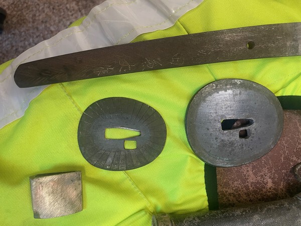

garbage finds Posted Wednesday at 07:17 PM Report Posted Wednesday at 07:17 PM Hello, Thank you to whomever can provide additional information. This was found today at our garbage site. We get swords from time to time, most are just newly made junk but this one certainly feels different. Total length is 35 1/8" and blade is about 26 1/8". Can anyone provide additional information in terms of history or value? 2 Quote
John C Posted Wednesday at 07:22 PM Report Posted Wednesday at 07:22 PM (edited) Hello: This is indeed a legit sword in navy kaigunto fittings. Not sure of the smith name (kane something) so you'll have to wait for a translation. The stamp just above the hole in the tang is the Seki inspection stamp, indicating it is not traditionally made. But still, a nice piece of ww2 history. John C. Edited Wednesday at 07:22 PM by John C spelling 2 Quote
SteveM Posted Wednesday at 08:03 PM Report Posted Wednesday at 08:03 PM 関福田兼丈作 Seki Fukuda Kanetake-saku (Made by Fukuda Kanetake, of Seki city) Kanetake is the name of the smith. Fukuda is the family name. 2 Quote
mecox Posted Wednesday at 11:37 PM Report Posted Wednesday at 11:37 PM @garbage finds Jeff, he was an early wartime smith: 兼丈 Kanetake (福田 丈太郎 Fukuda Jotaro) (can read “Taketaro”) [kanji is not “fumi” 文] Born: Meiji 43 (1910) May 10; Registered as a Seki smith Showa 14 (1939) October 26. In 1937 lived at Seki-machi, Otsu 1754; 1939: Seki-machi, Misono-cho. History: living in Seki-machi and trained under Matsuda Kanetaka who had early trained under Kojima Kanemichi (then as Kanetoki) probably in the Nipponto Tanren Juko. Summary: died in 1989 age 79. He made numerous swords for both Arrny and Navy. Example mei: Fukuda Kanetake saku 福田兼丈作 Seki ju Fukuda Kanetake saku 関住福田兼丈作 Noshu Seki ju Kanetake saku 濃州 関住兼丈作 Below: yours has SEKI stamp, Gendai Swordsmiths Index, Fuller & Gregory has SHO stamp Quote
Bruce Pennington Posted Thursday at 12:56 AM Report Posted Thursday at 12:56 AM Value runs from $1,600 to $2,400 depending upon condition, this one in the lower half of the range. But that still depends upon where and when you sell it. Quote
