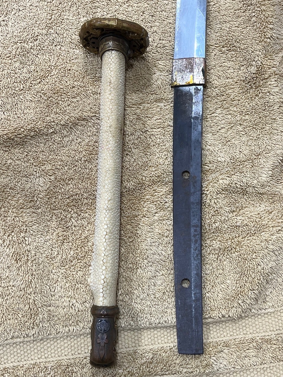

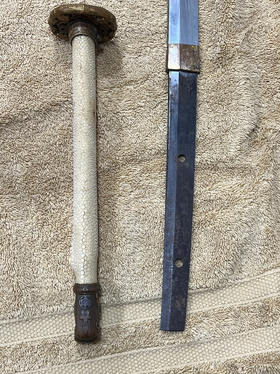

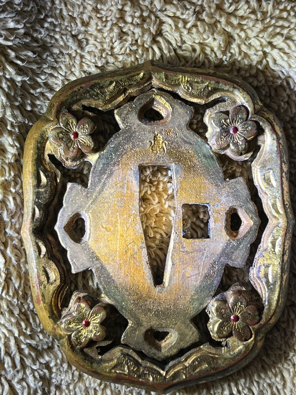

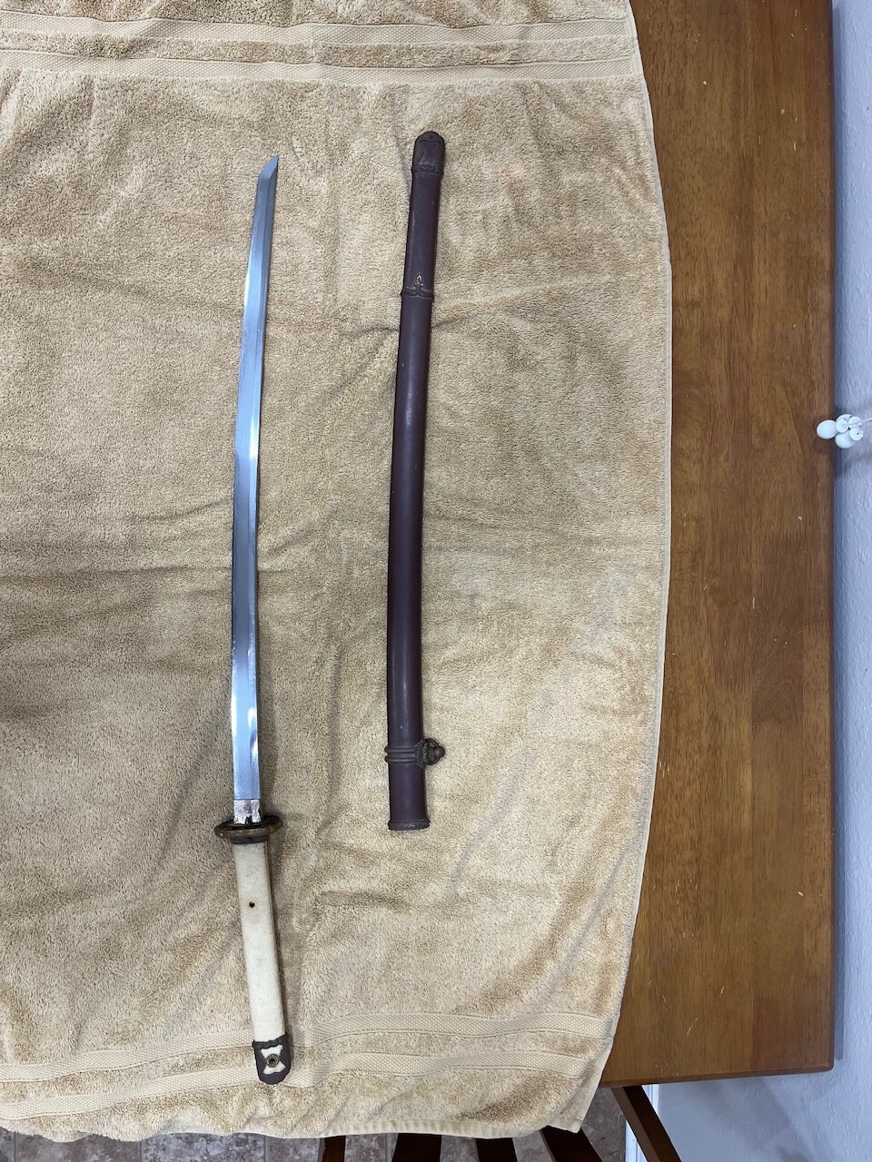

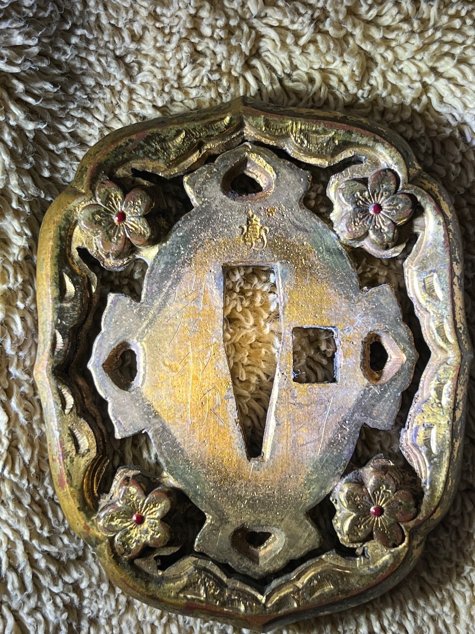

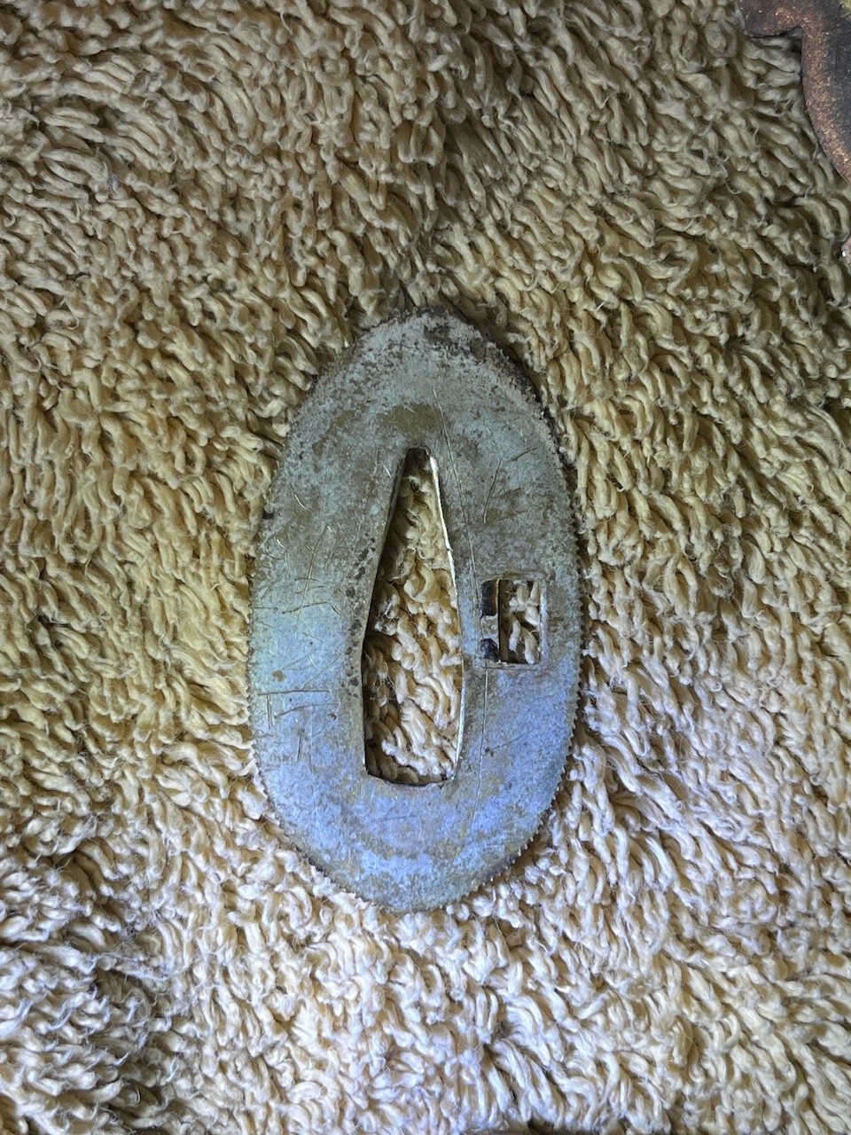

Shin gunto T98 with open tsuba [guard] more info after nakago/tang is showed.

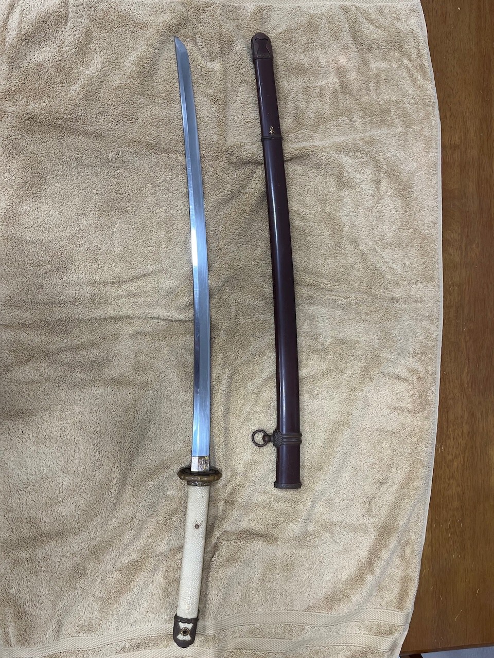

I don't see signs of it having second hanger/haikan altough chuso is centered.

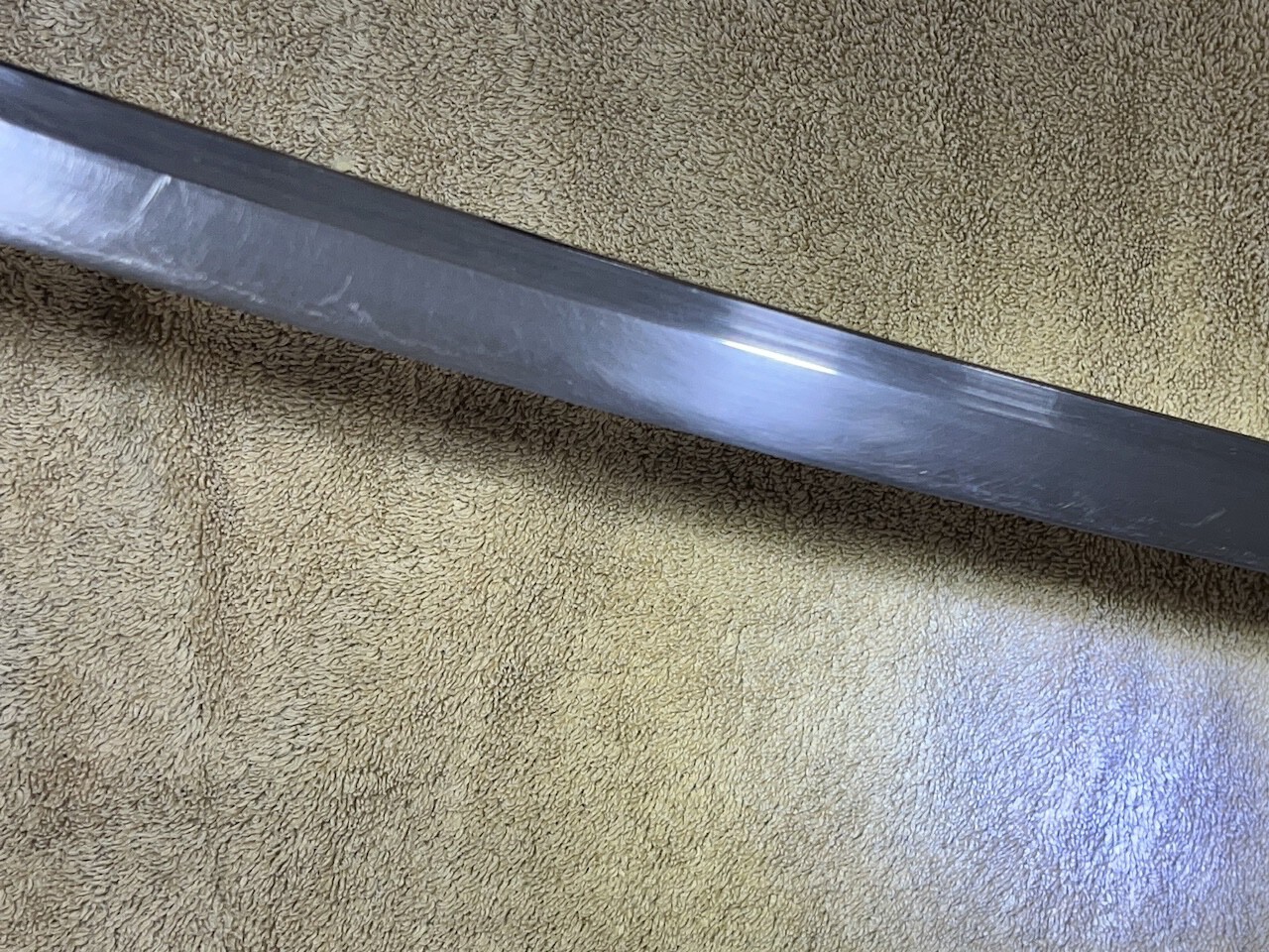

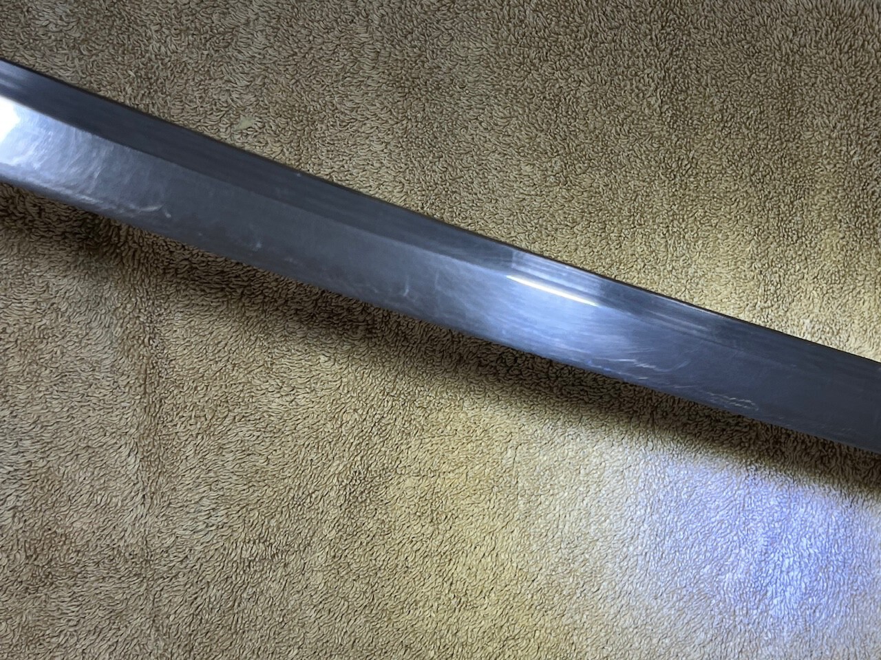

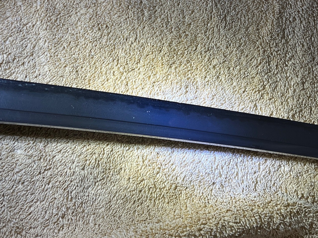

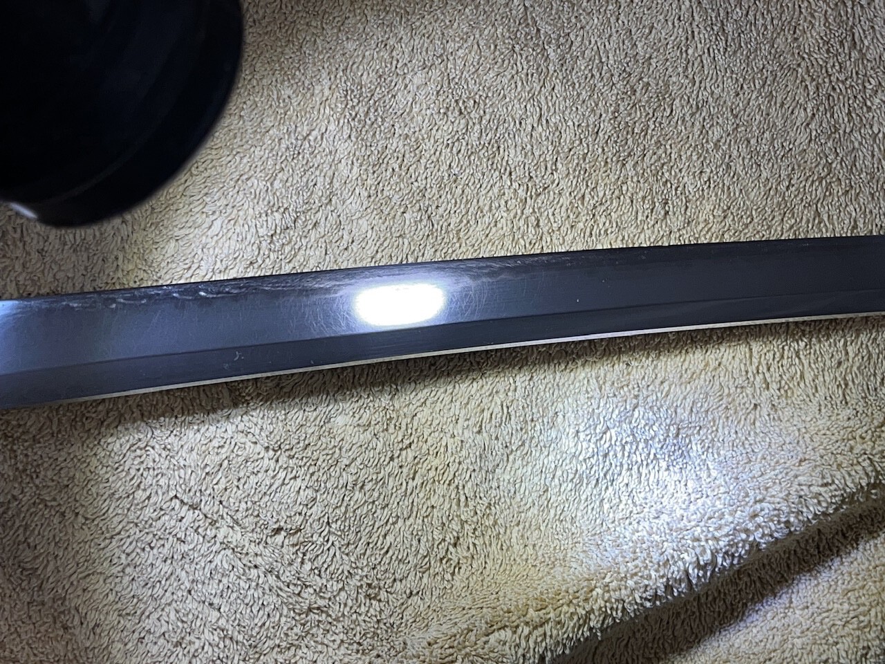

Same about blade itself. There is hamon but close up would help in a matter if it was traditionally made [gendaito] or machine [showato]

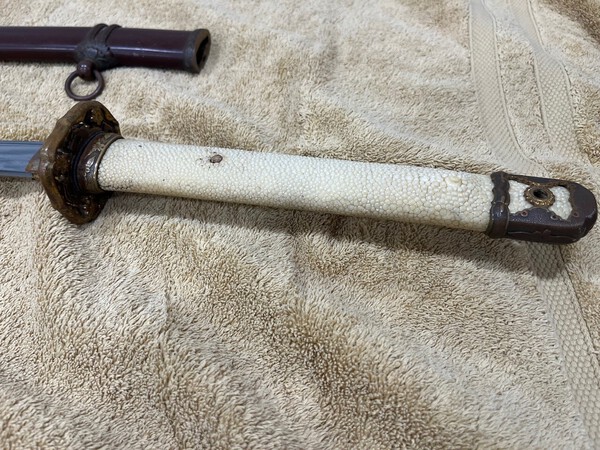

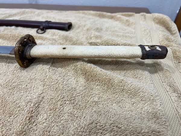

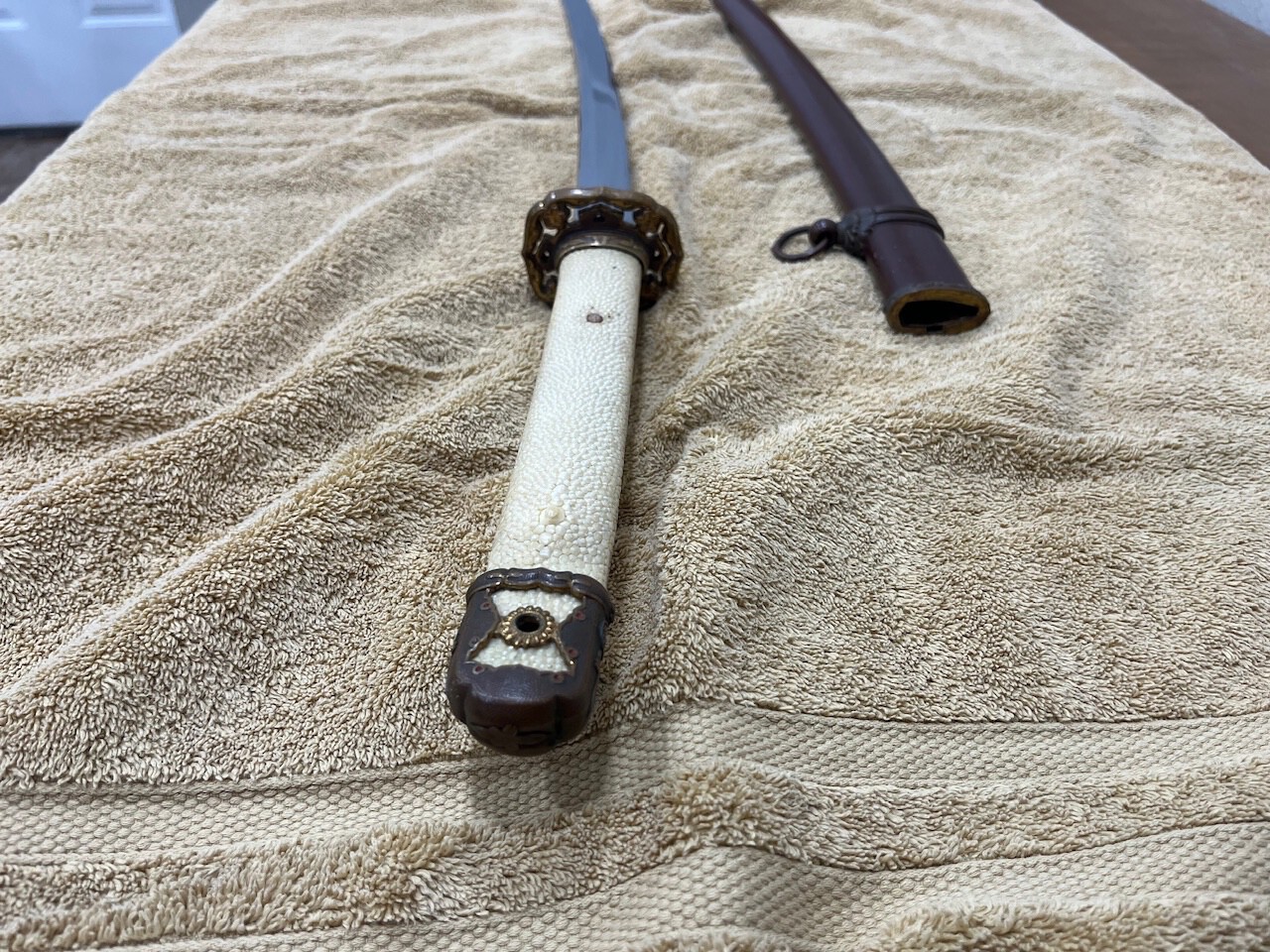

It's lacking menuki and tsukamaki. But no rust and tip is intact.
Rayskin on hundle with full wrap. Have characterisctic lumps [bigger ones closer to pommel are nice to see]

@Bruce Pennington how often you see seki/showa stamped swords with centered chuso? I wonder if this don't indicate gendaito/pre war sword. In manufacture/factory blades were made in batches. So thinking position of mekugi ana was standardized to speed up production.

Marcin gave you a great link, the Ohmura site, for getting to know WWII Japanese swords.  As the other guys already pointed out, we could use some clear close up shots of some things to help you get to know your sword a bit better.
Here's a great video showing How to Remove the Handled/Tsuka of Japanese Sword
Here's a good page to start learning some of the Japanese sword lingo: Japanese Sword Visual Glossary
Taking care of your sword: Japanese Sword Care
First big step is removing the tsuka (handle) and seeing if your blade is signed and dated.  Next is getting a few close, clear shots of the blade's hamon (temper line/pattern), and one shot showing the area around the belt hanger loop (haikan).  The Type 94 had 2 haikan, but the second one was removable and is often gone by the time we see them.  If it was the 94 version, there might be marks on the saya (scabbard) showing where it sat originally.  Otherwise, you have a Type 98.
[Mods - I was going to recommend moving this to Military forum, but I guess we might wait to see if the blade is an older nihonto]
Oh, and the reason for the comments about "Samurai" are that these fittings were WWII Army, whereas Samurai swords were 'civilian' swords carried by Samurai long before WWII.  Now, honestly, though, the Military blades were specifically designed based off the Samurai sword.  So, a more technically correct way to refer to them is "Samurai styled sword."  Now, it is still quite possible your sword holds a much older blade from the days of the Samurai.  So, let's get a look at that nakago (tang)!
Hi Jeff, the small stamps indicates the Koshirae was made by Suya Shoten. The other markings could be related to the officers name or assembly numbers. The blade itself looks to have some age and could date back to the 16th Century.
Looks like a 3-5-3 kirimon
Interesting sword! Yes, could very well be 1500s. The fittings are WW2 but the blade is older.

The family crest (mon) is a 3-5-3 kiri and one used by many families who could claim association with that particular clan so an exact family name is probably not possible.

Yeah it's samurai afterall ;-) and was shortened at least once. Tsuba is really good with those red accents. Individual order. It's sad that menuki are missing. Maybe someone more familiar with Suya soten would disclose if this manufacture used to pair crest at menuki with crest at pommel [kabutogane].

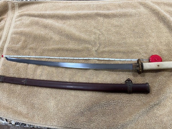

Give us measurements in spare time:
Nagasa- from tip to munemachi and entire length.

"In the Edo period (江戸時代), the law regulated the sword size for different social class. Sword carriers, martial artists, and swordsmanship students were allowed to carry swords with blade length up to 2 shaku 3 sun (approximately 69.7 cm or 27.4 in) under Tokugawa Iemitsu (徳川家光) and up to 2 shaku 2 sun 8 bu (approximately 68.6 cm or 27 in) under Tokugawa Ietsuna (徳川家綱)"
More in a link
https://romanceofmen.com/blogs/katana-info/katana-nagasa-know-how-to-measure-katana-blade-the-right-way#HowToMeasureNagasa
