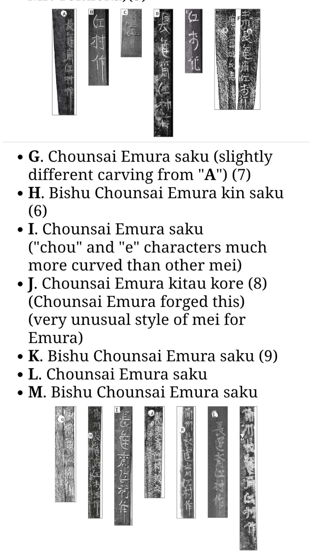

Rawa Posted September 4 Author Report Posted September 4 https://www.japaneseswordindex.com/emura.htm M version of mei [Bishu Chounsai Emura saku] For future reference in linked yt video: -statement that blades with this mei were made in prison and by Emura himself. -3 signs mei are made by his students. https://youtu.be/h4Xvq_sog2U?si=8nKGFDN9ekYA9LOh Quote

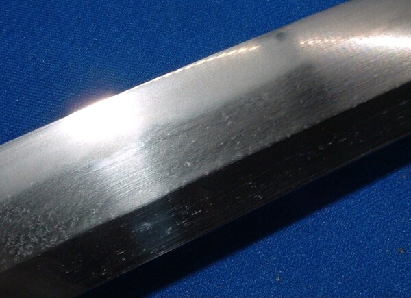

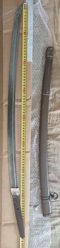

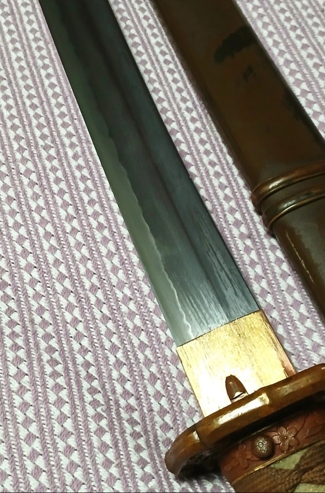

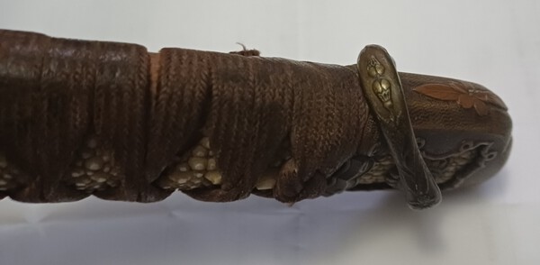

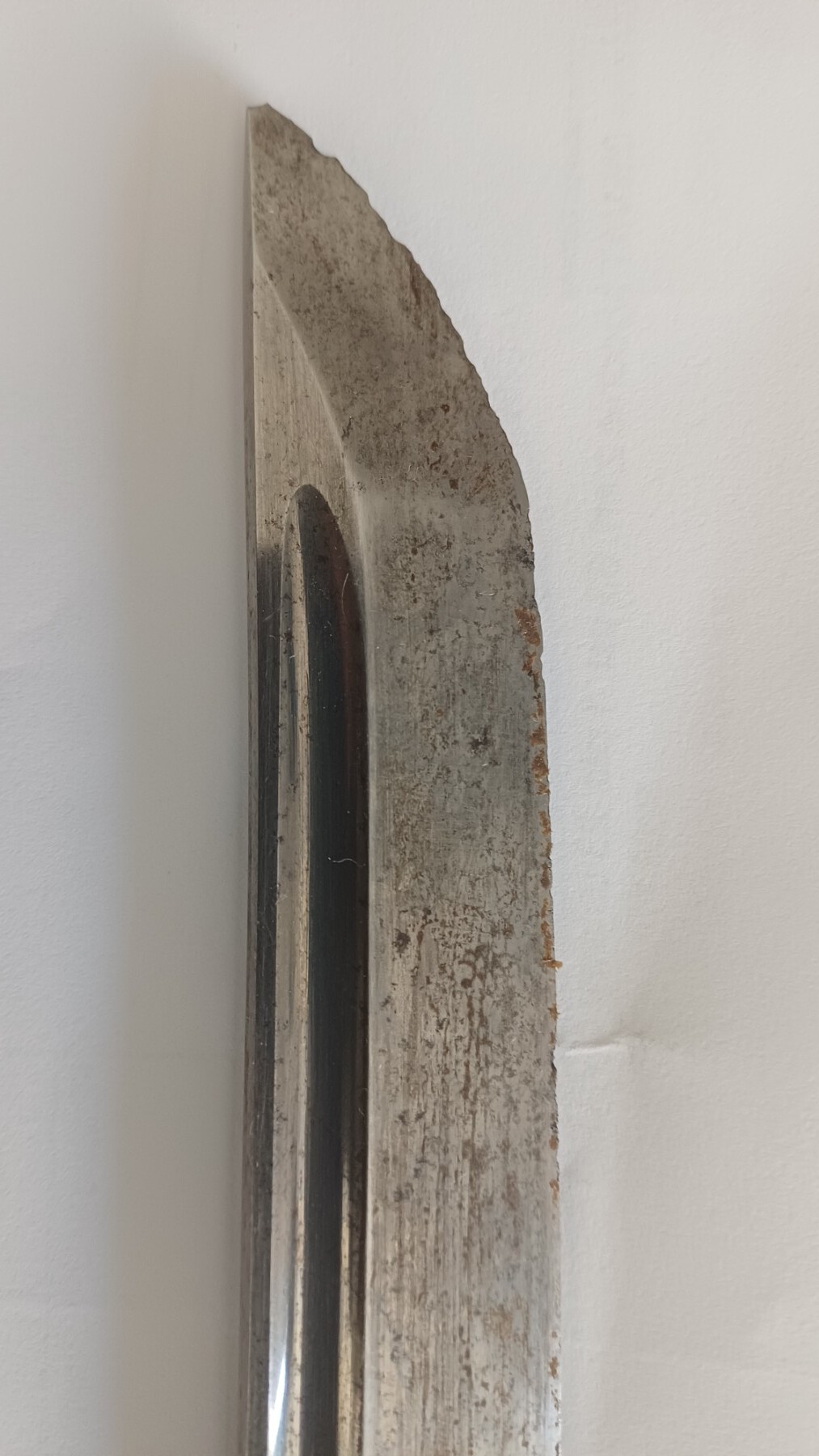

Rawa Posted September 26 Author Report Posted September 26 Got the package worst part in pic. Wonder your opinion if such a kissaki is worthy salvaging. Quote
Rawa Posted September 26 Author Report Posted September 26 17 minutes ago, Brian said: Plenty of boshi left, well worth saving. Thx boss. I knew it would require repolish but this kissaki made me confused. At least no "hakobore" Quote

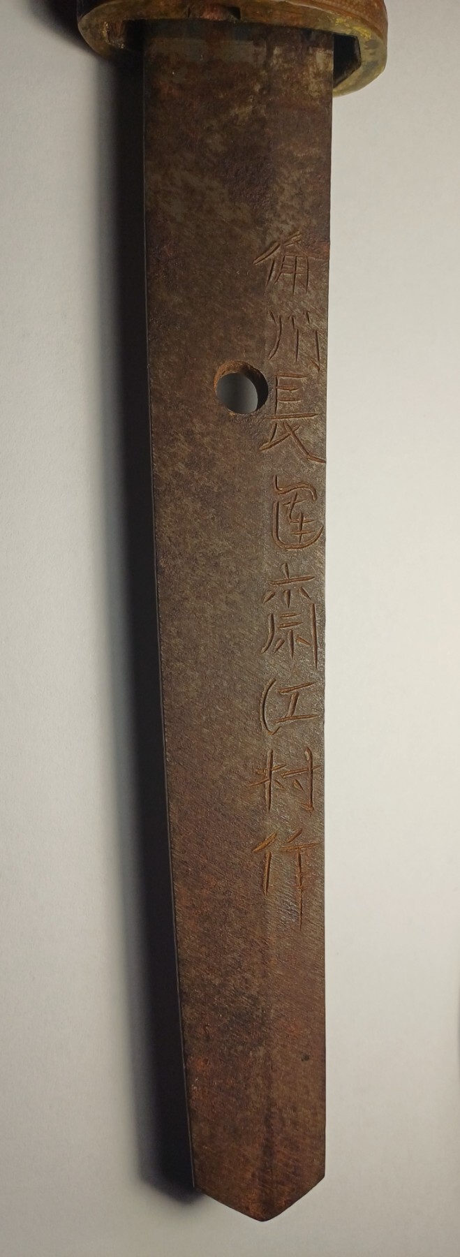

Karu Posted September 26 Report Posted September 26 Marcin you won the auction ? Congrats its the first time I see that mei but Emura had plenty so I think its hard to know if he made it himself. Also, its the first time I see an Emura blade with a bo-hi Will you get it polished ? Quote
Rawa Posted September 27 Author Report Posted September 27 (edited) 6 hours ago, Karu said: Marcin you won the auction ? Congrats its the first time I see that mei but Emura had plenty so I think its hard to know if he made it himself. Also, its the first time I see an Emura blade with a bo-hi Will you get it polished ? Yes when I saw it I knew It's worthy and would require more money. It's variation of example "K/M" from his years as head of the prison [supposedly 1940-1943] https://japaneseswordindex.com/emura.htm Even important quote: "Kiyoshi Morita noted that Emura exhibited his swords at the 1st Gunto exhibition in 1943; these were signed as being from Doshu in Kochi prefecture (mei "F"), not from Bishu in Okayama (mei "H,K,M"). This would lead one to speculate that before 1940 Emura was in Takamatsu city in Kagawa prefecture in Shikoku. Around 1940 he was located in Okayama prefecture (Bishu-mei ("H,K,M")) as the head of the Okayama prison, then around 1943 he returned to Kochi prefecture (Doshu-mei "F"). Probably various mei were used as he was the head of Okayama prison and traveled considerably" It have crest and nice fittings with open tsuba example. Edited September 27 by Rawa 1 Quote

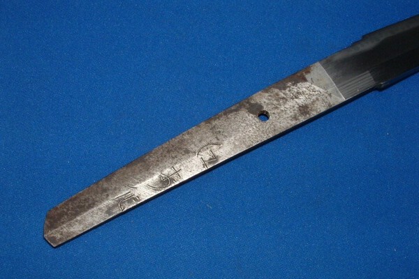

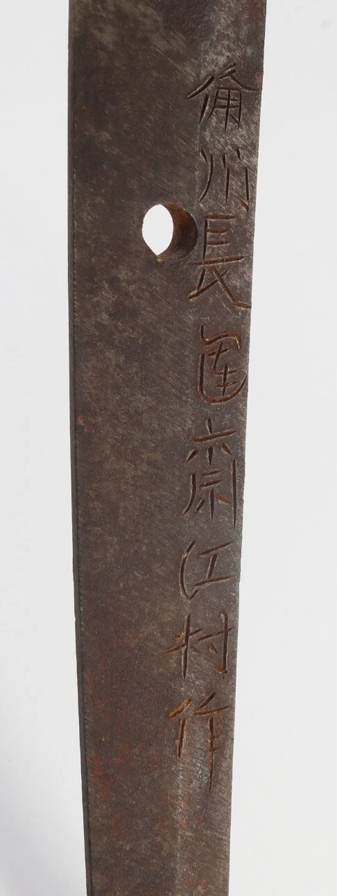

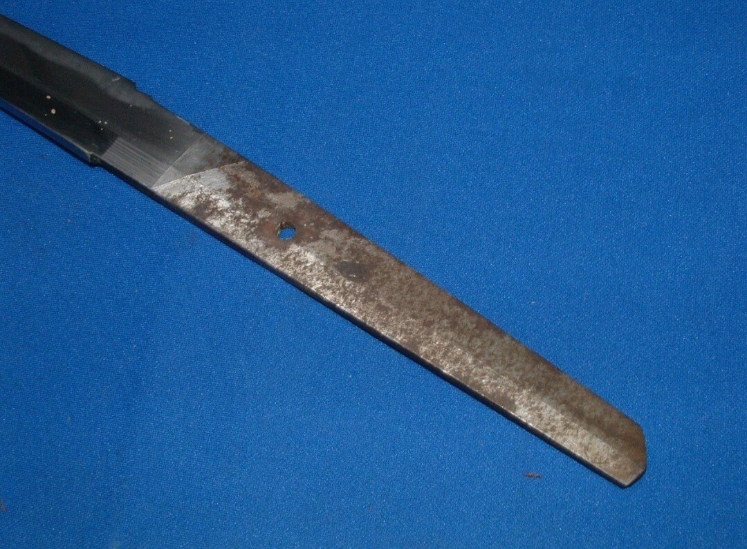

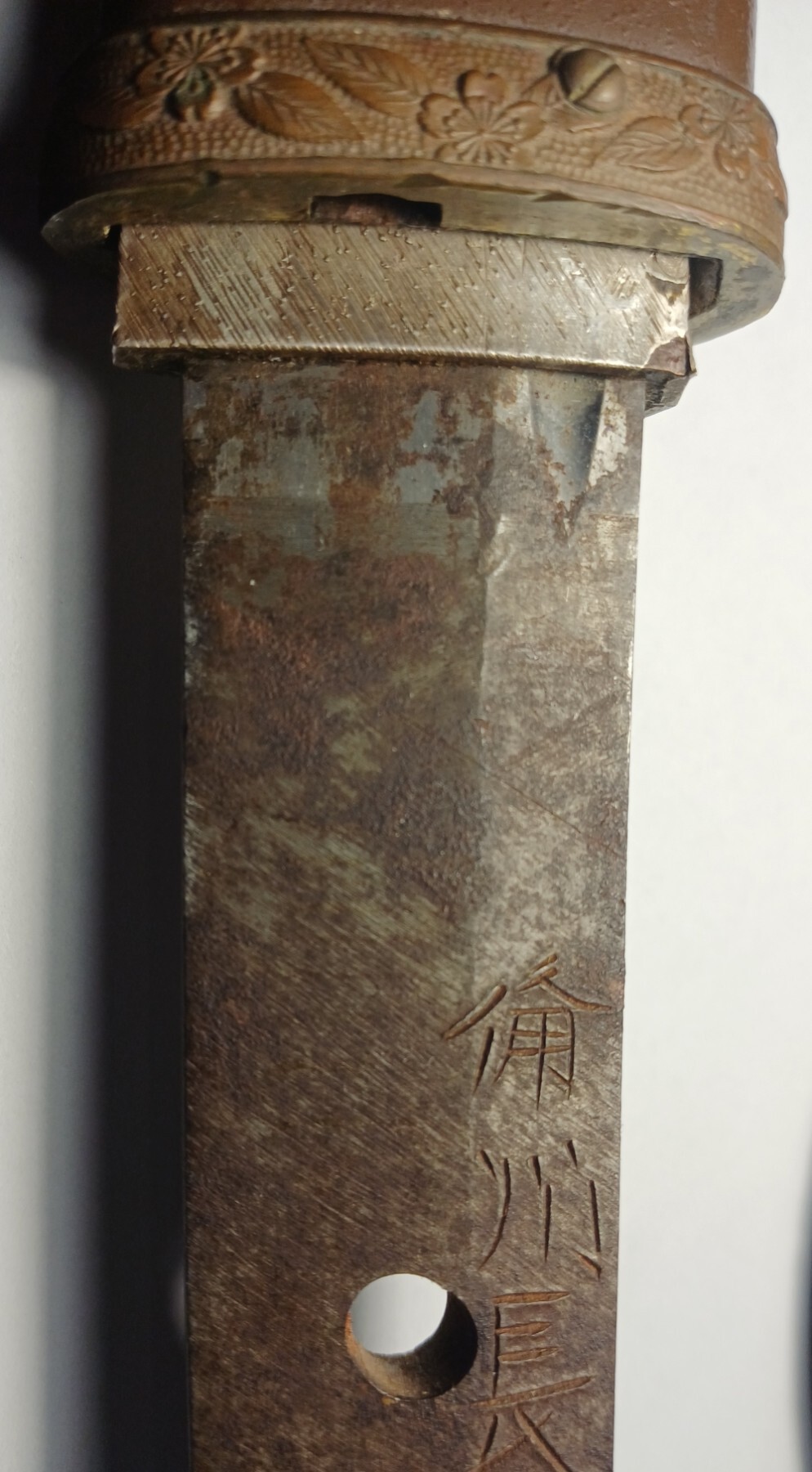

charlesf Posted September 27 Report Posted September 27 Well done on winning this sword and for sharing it with us,would you be kind enough to show the yasurime above the mei as well as the nakago jiri? Thanks and regards, charles. Quote
Rawa Posted September 27 Author Report Posted September 27 43 minutes ago, charlesf said: Well done on winning this sword and for sharing it with us,would you be kind enough to show the yasurime above the mei as well as the nakago jiri? Thanks and regards, charles. Dunno how to explain that buying sword in such a shape wasn't with profit in mind. 1 Quote
charlesf Posted September 28 Report Posted September 28 Many thanks for posting the extra images,nice silver foil wrapped habaki,the way the groove extends into the nakago is also a nice feature,the patina shows it is original,I have seen gendaito with bo-hi that looked as though they were recent additions for practitioners of iaido,usually in modern koshirae. I think you have a nice package,good length,bo-hi,family mon,the condition can be improved with a good soak in a light oil then prolonged wiping with crushed tissue or well folded and creased paper kitchen towel which should remove surface dirt. I don't think profit enters the equation if you have something that you can appreciate and enjoy.Over the course of 40+ years that I've been involved with this interest I have owned hundreds of swords,many of which I lost money on when I sold them but I never considered it a loss,rather a part of the learning curve that can't be found in books,so be happy! Regards, charles. 1 Quote

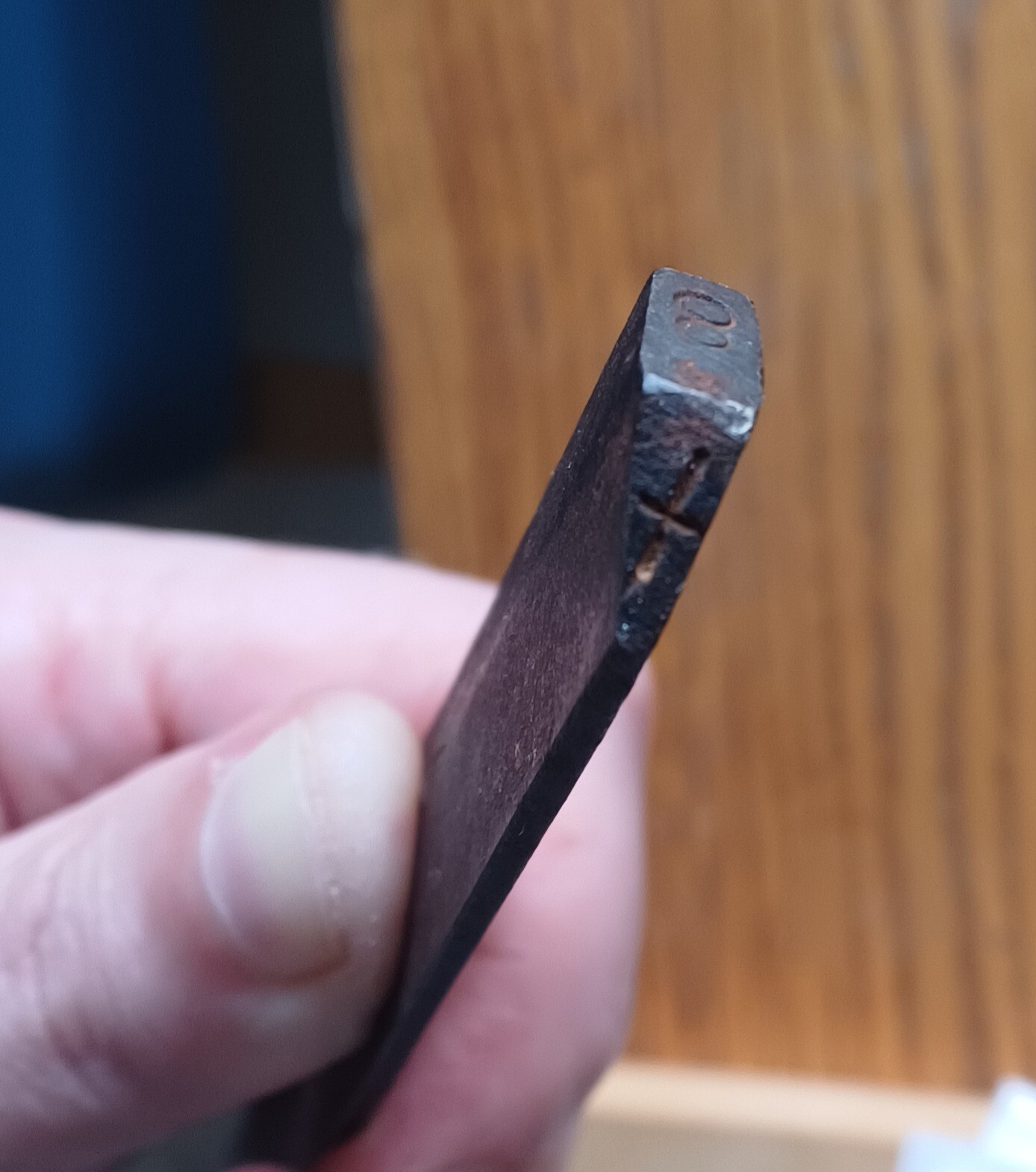

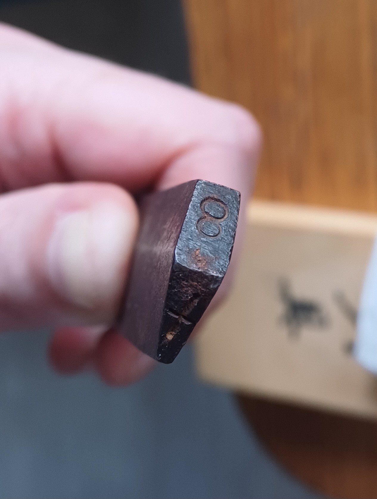

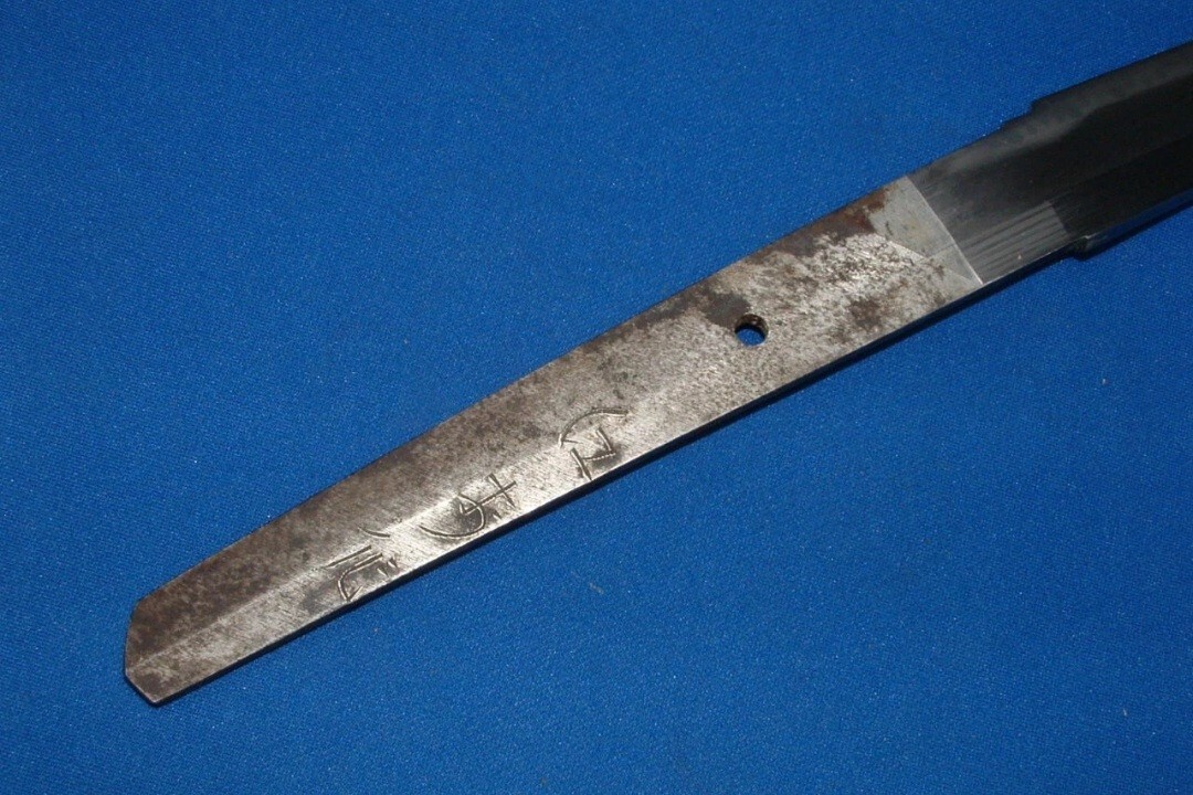

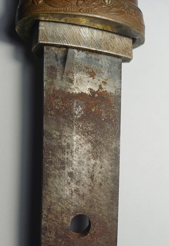

Rawa Posted October 2 Author Report Posted October 2 @IJASWORDS any of yours have similar markings? 1 1 1 Quote
Bruce Pennington Posted October 2 Report Posted October 2 Marcin, Never seen anything like that. Do any of the other fittings have a number? Quote
Rawa Posted October 2 Author Report Posted October 2 (edited) I dont see any. Prisoner number? Only assembly markings. Edited October 2 by Rawa 1 Quote
Scogg Posted October 2 Report Posted October 2 Never seen that before either. Very cool. I imagine that would be a particularly challenging location to apply a stamp Quote
Kiipu Posted October 2 Report Posted October 2 Do not recall seeing this before either. Possibly a Japanese katakana NA with an Arabic 8? ナ8 = Katakana NA 8. 1 Quote

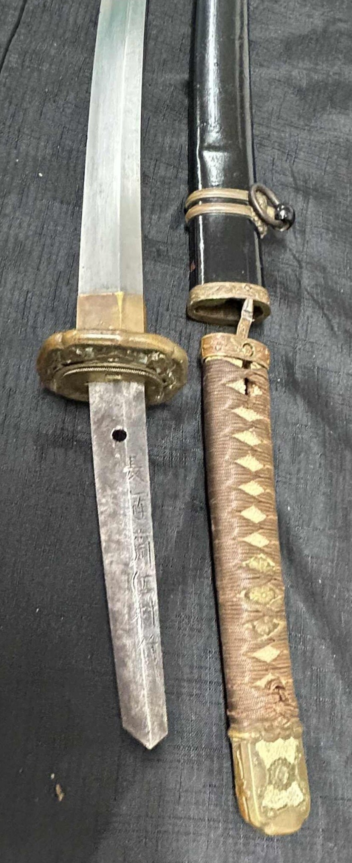

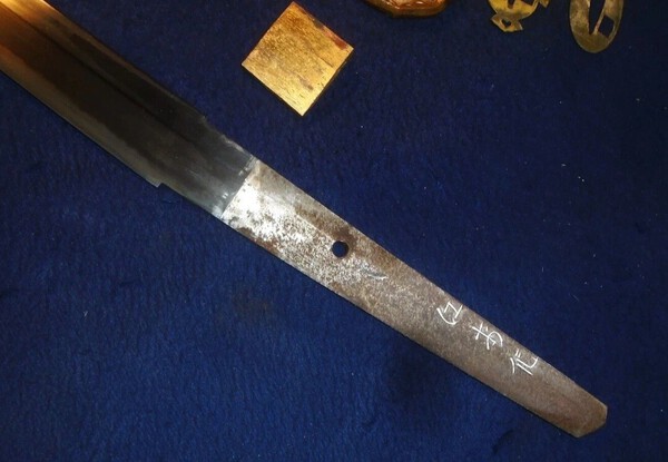

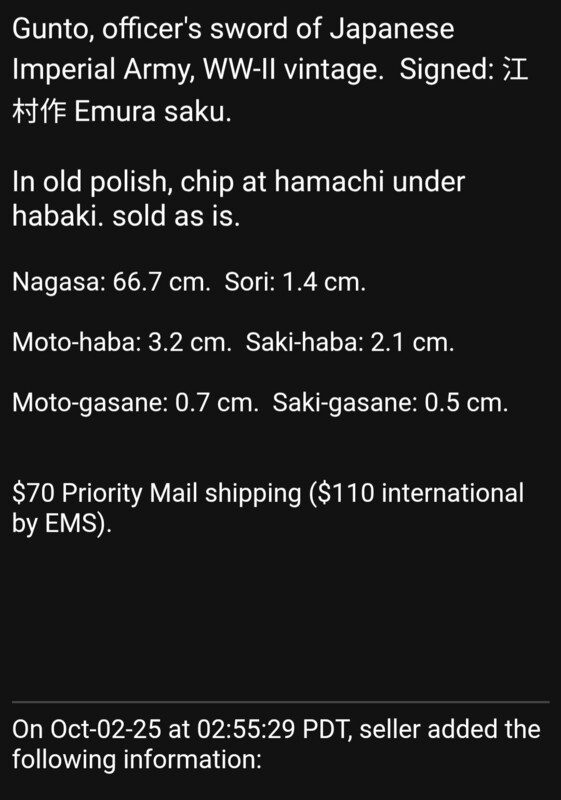

Rawa Posted October 5 Author Report Posted October 5 (edited) I'm going to post here any fresh "Emura" I find. Type "E" Sanji mei Emura saku [blade was cleaned with sand belt, nakago jiri consistent with Slough] https://ebay.us/m/Ga05Wv Edited October 5 by Rawa 3 Quote

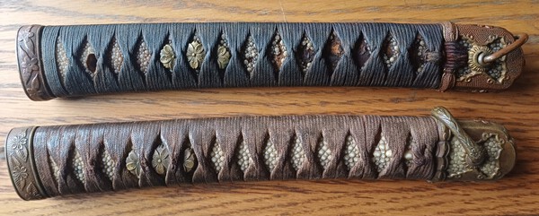

Rawa Posted October 9 Author Report Posted October 9 (edited) I got second example of Emura so I can add pictures for comparison. Lower is individual order. Please bring more examples. Edited October 9 by Rawa Quote

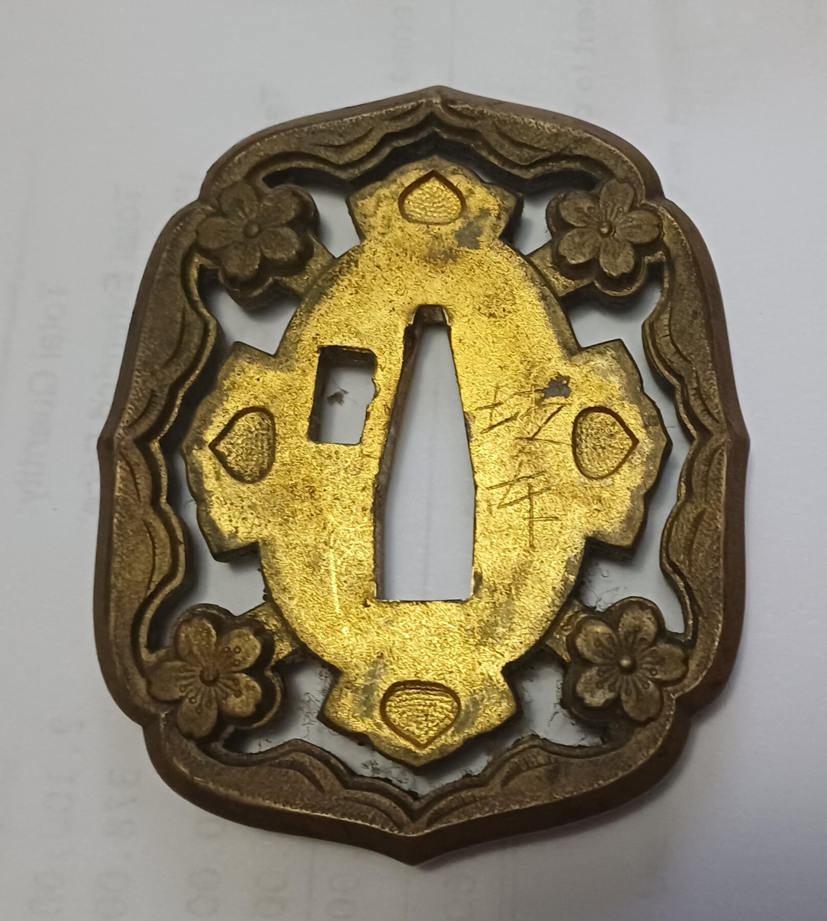

Rawa Posted October 9 Author Report Posted October 9 (edited) Koiguchi and haikan. If you find more different drop here. Edited October 9 by Rawa Quote

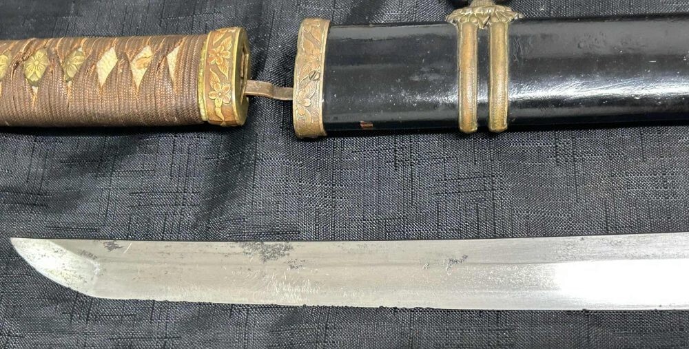

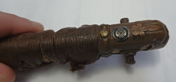

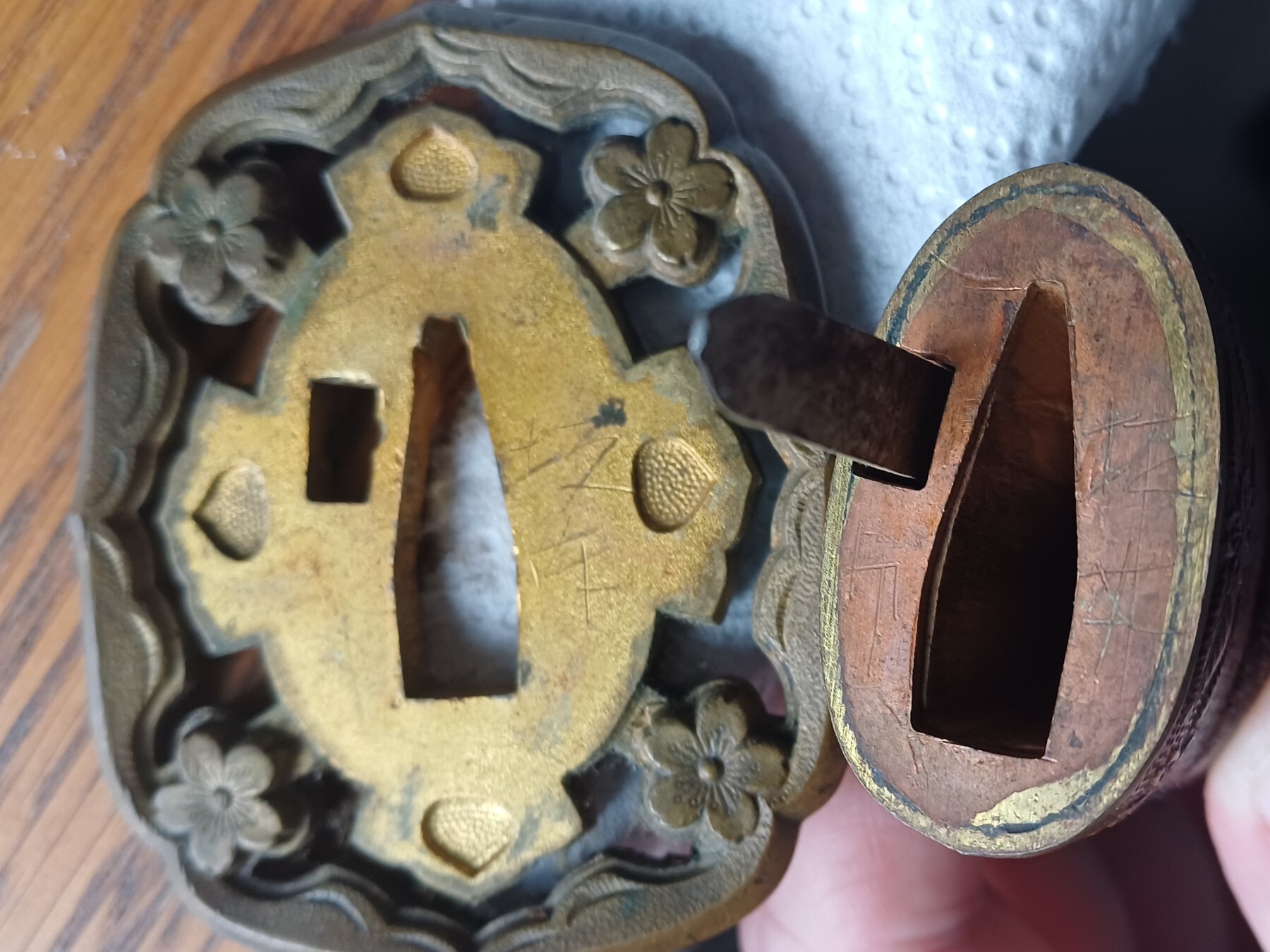

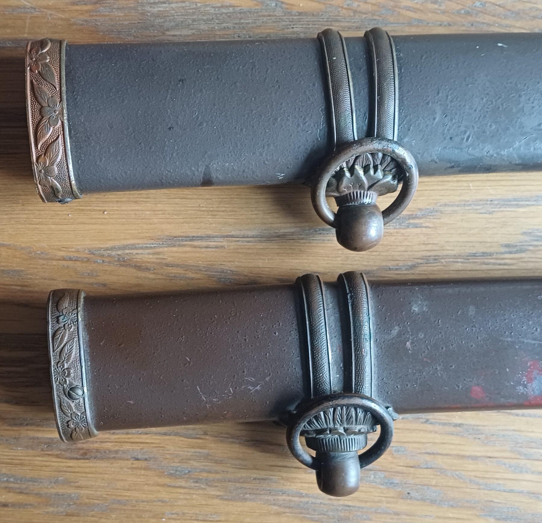

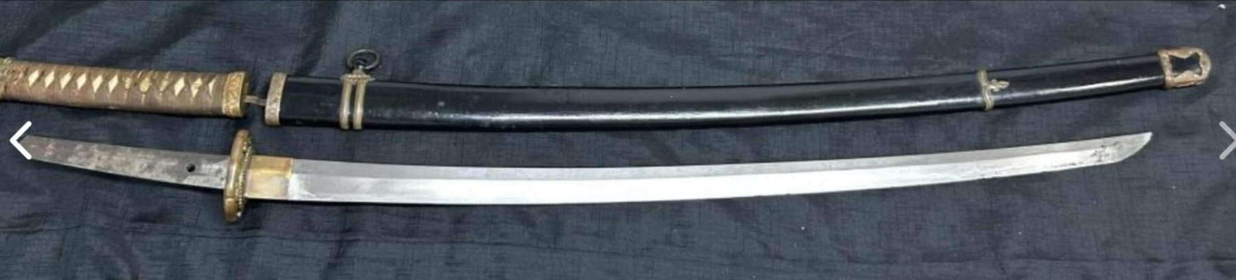

Rawa Posted October 9 Author Report Posted October 9 (edited) I found another example of longer mei. Again longer signature katana mei. Mr @Bruce Pennington what kind of assembly is this? Black lacquered T98? Open tsuba with centered chuso. Saya appears to be metal? Different degree of wear on tsuka and saya parts points that it could be random assembly [saya from "souvenir NLF"] Edited October 9 by Rawa Quote
Bruce Pennington Posted October 9 Report Posted October 9 Marcin, The black army saya is fairly common. At first glance, I often think "Aha! Another souvenir.", when it's really just another army saya. The metal fittings aren't gold gilded. 1 Quote

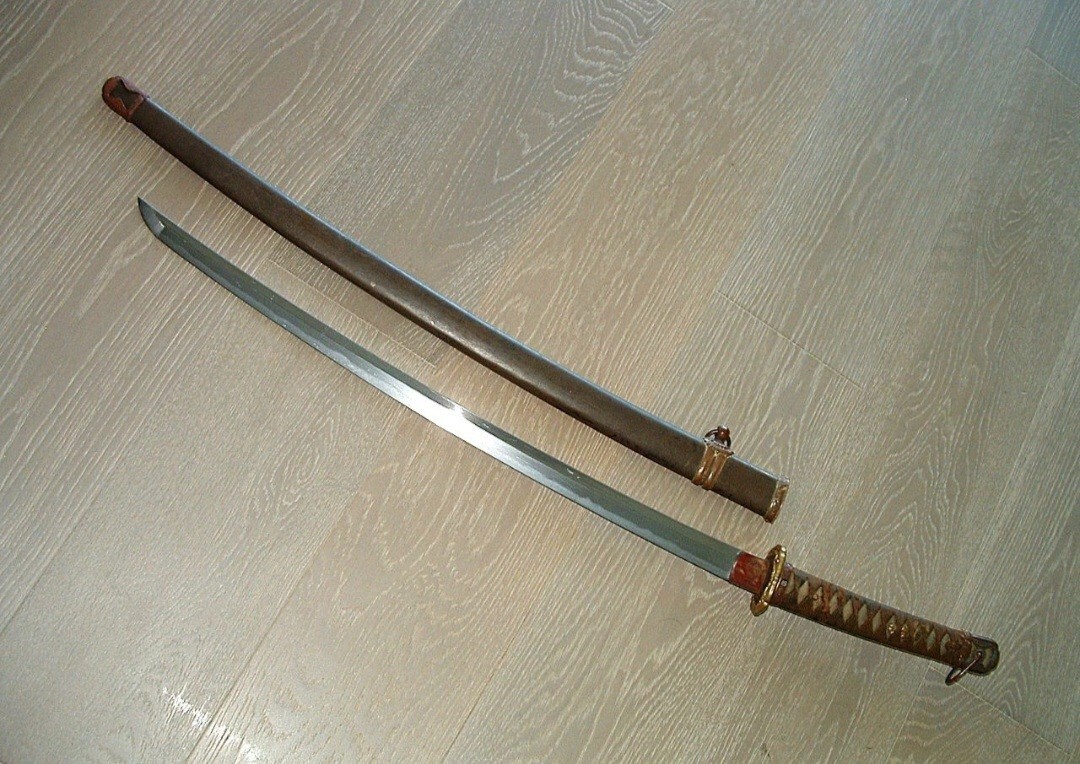

Rawa Posted October 11 Author Report Posted October 11 (edited) Old thread with many great examples. And example from aoi Japan from around 2014. Tachi mei 3 kanji. So sanji mei exists as both katana and tachi mei types. https://www.aoijapan.net/katana-emura-saku/ Edited October 11 by Rawa 2 Quote

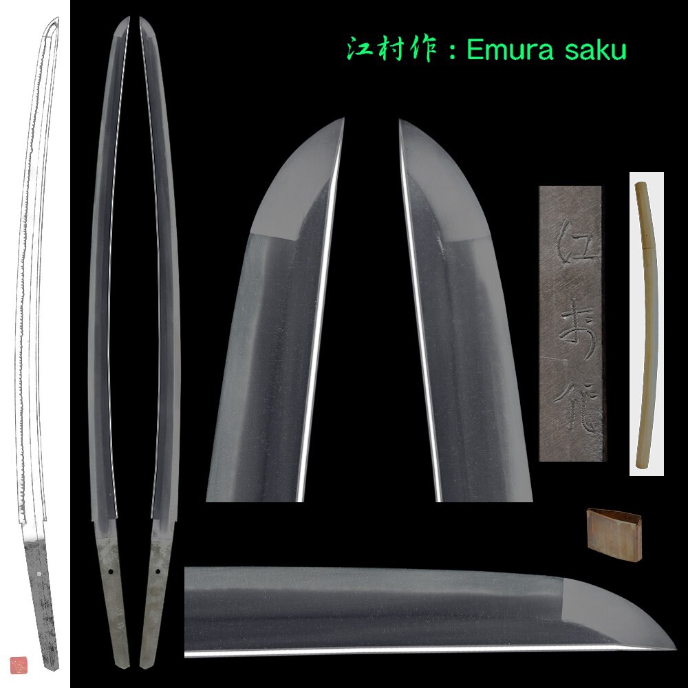

Rawa Posted October 11 Author Report Posted October 11 Another sanji mei [katana mei] aoi Japan 2015 https://www.aoijapan.net/katana-emura-saku-4/ Quote
