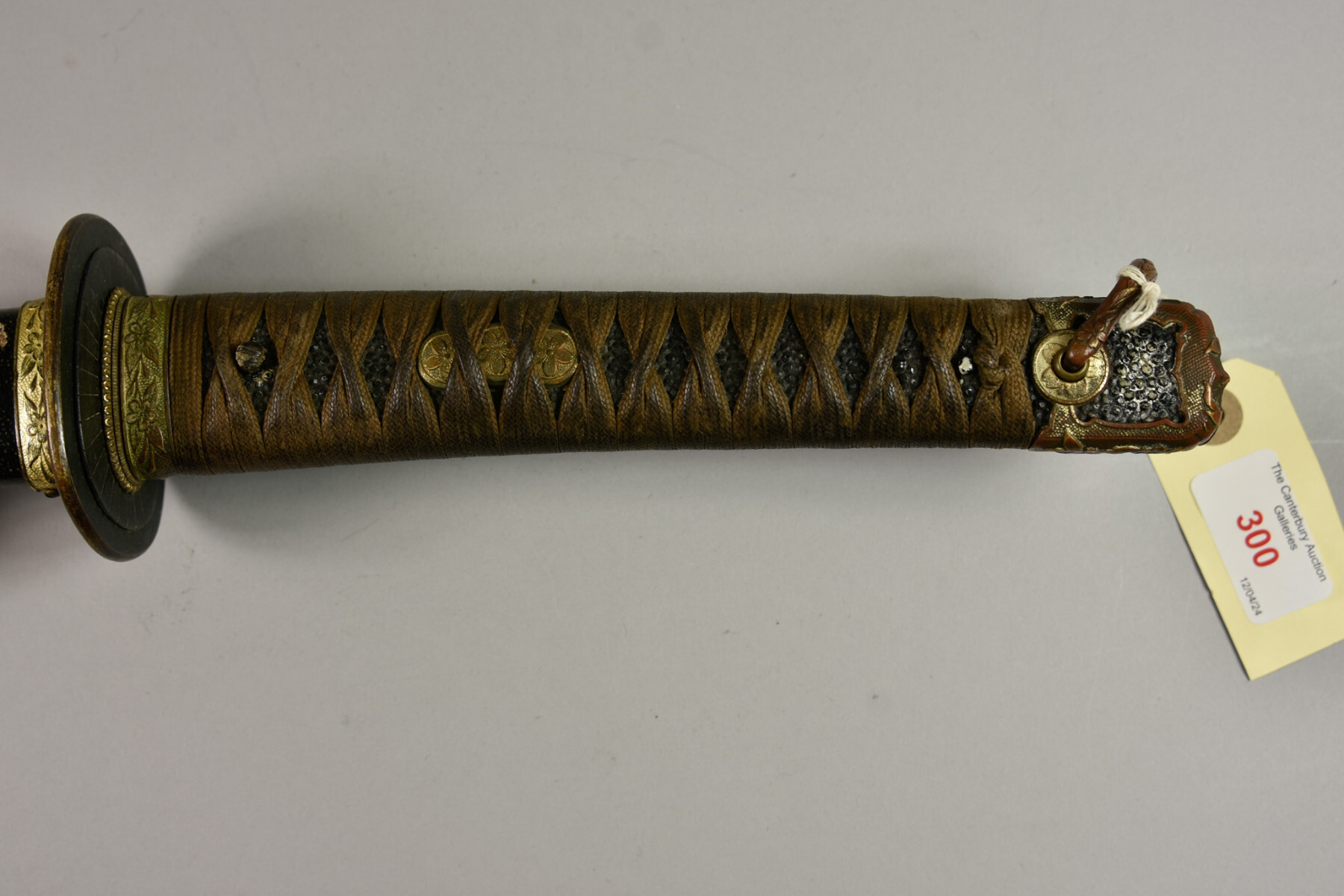

The sarrute is missing, everything else seems complete. My question (long way of asking) is was there a more prominent variation of the sarute on standard Kai Gunto (2 ashi, speckled black laquered saya) or is any of the Shin Gunto variants acceptable on these?
Looking through my parts, I have a clasped hands one spare, and was wondering if that would be correct/appropriate if I was to fit it?

Thank you all. I think i'll fit the clasped hands one for now, if I don't have a different one.

Didn't take long to find the auction where it was sold: https://denhams.com/lot/718/april-2023
Some nice history. I got his photo, framed story summary and his Vice Admiral commission. Need to ask him if he still has the ship photo and medal ribbons.
Captain Caslon and the HMS Nelson. Lots to be found on him online. Nice to know he was there and is well known. Must have been an interesting surrender ceremony, I guess they just pulled swords from the pile and gave them out.
Brian, have you checked under the Fuchi for any writing? In regards to the Sarute position there is no particular rhyme or reason whether it sits Ha or Mune side, it was the officers preference.
Once the sword is in hand it would be a good idea to take some clear pictures of the writing, with the known location of surrender you may have a chance of identifying the IJN officer this sword belonged to.

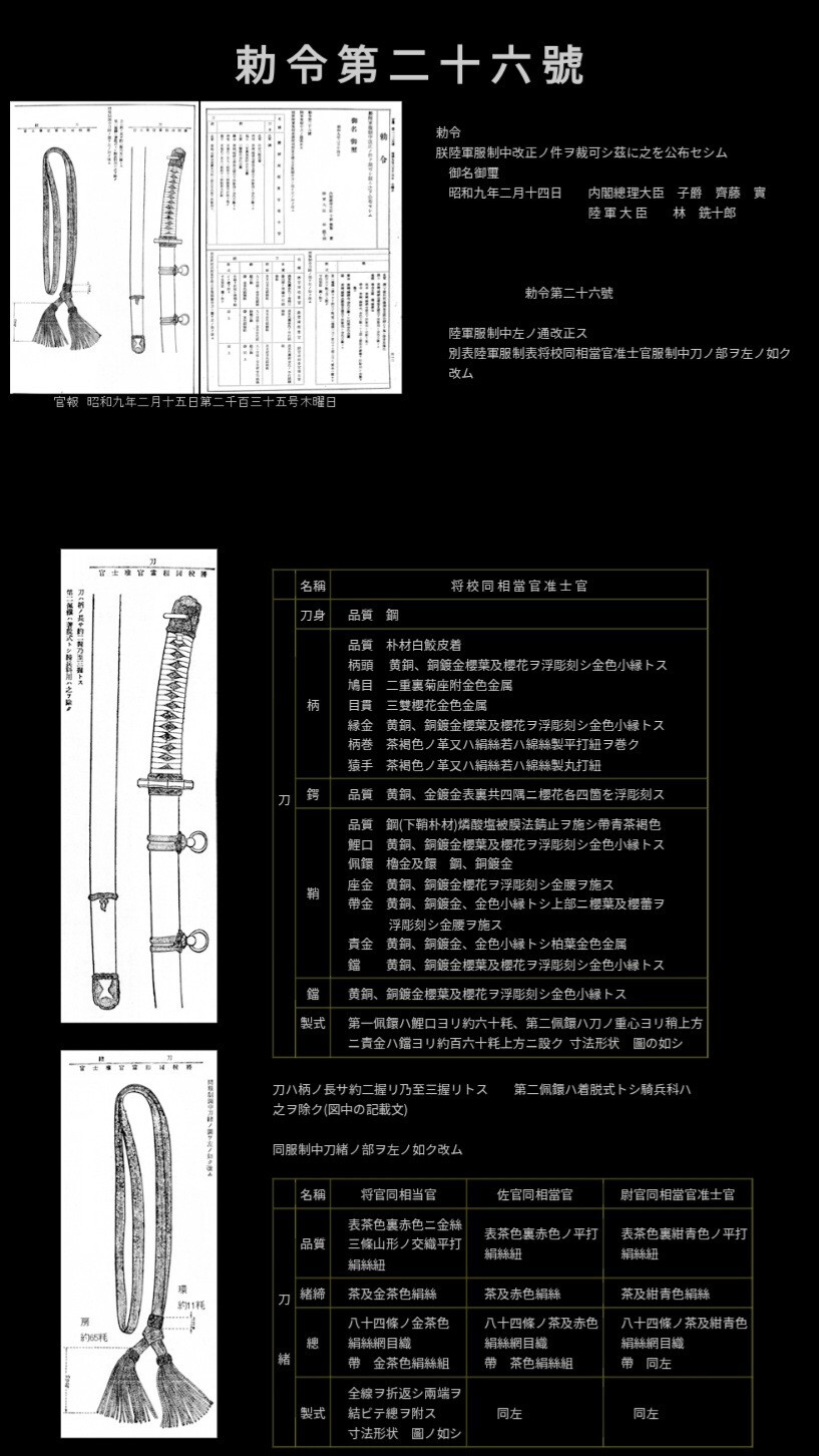

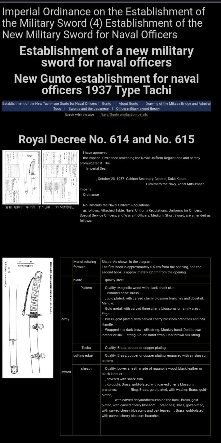

Sarute from Minatogawa Tachi

Hello, I think the clasped hands or all brass style would be appropriate, as well as the braided silk cord. What would look odd is having the brass and painted style sarute, commonly found on Type 98 Army swords.
