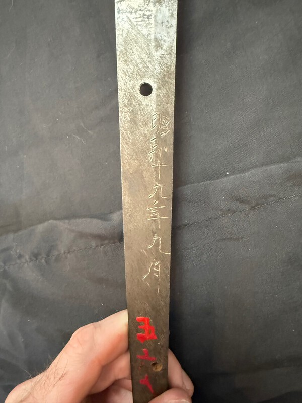

Scogg Posted July 31, 2025 Report Posted July 31, 2025 I got this sword in a small bundle and would love to know the translation. Full disclosure: It’s seen better days… And I will likely be putting this sword on an eBay auction because it’s not the item in the bundle that I was focused on. If it sells, I will donate a small percentage of the proceeds to the NMB for the translation assistance. All the best, -Sam 1 Quote

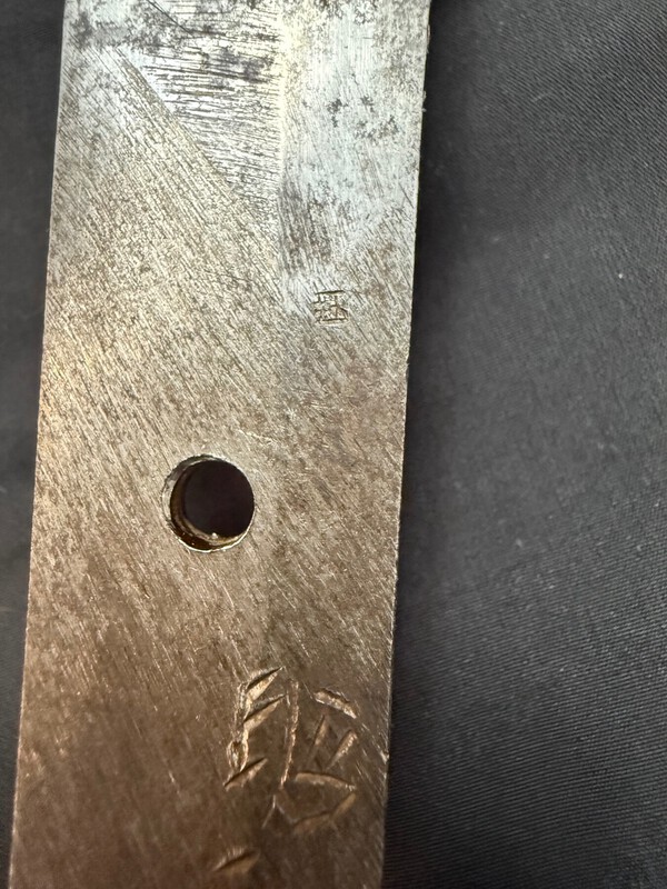

mecox Posted July 31, 2025 Report Posted July 31, 2025 Sam as above and probably this guy “Yasumitsu” (康光), real name Noguchi Shojiro (野口照二郎) born Meiji 40 (1907) from Tahara-mura, Kamo-gun in Gifu, registered as a Seki smith Dec 1943. It has a stamp, probably Seki partial and sideways 3 Quote
