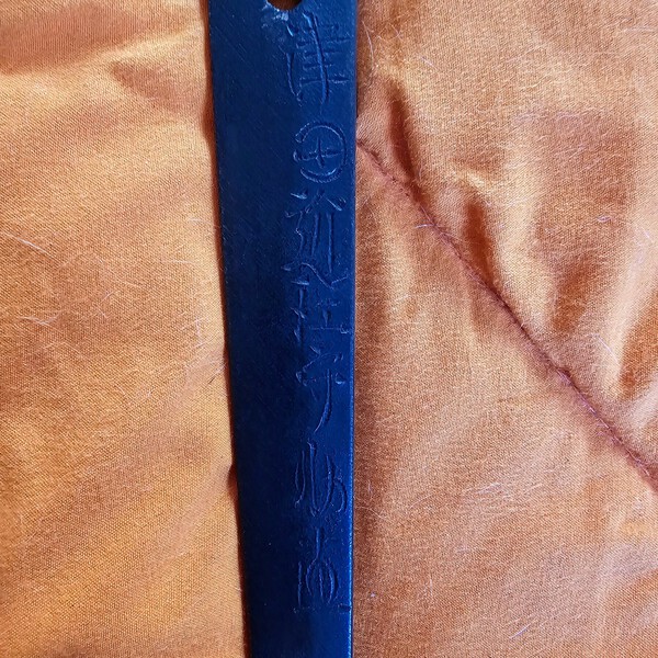

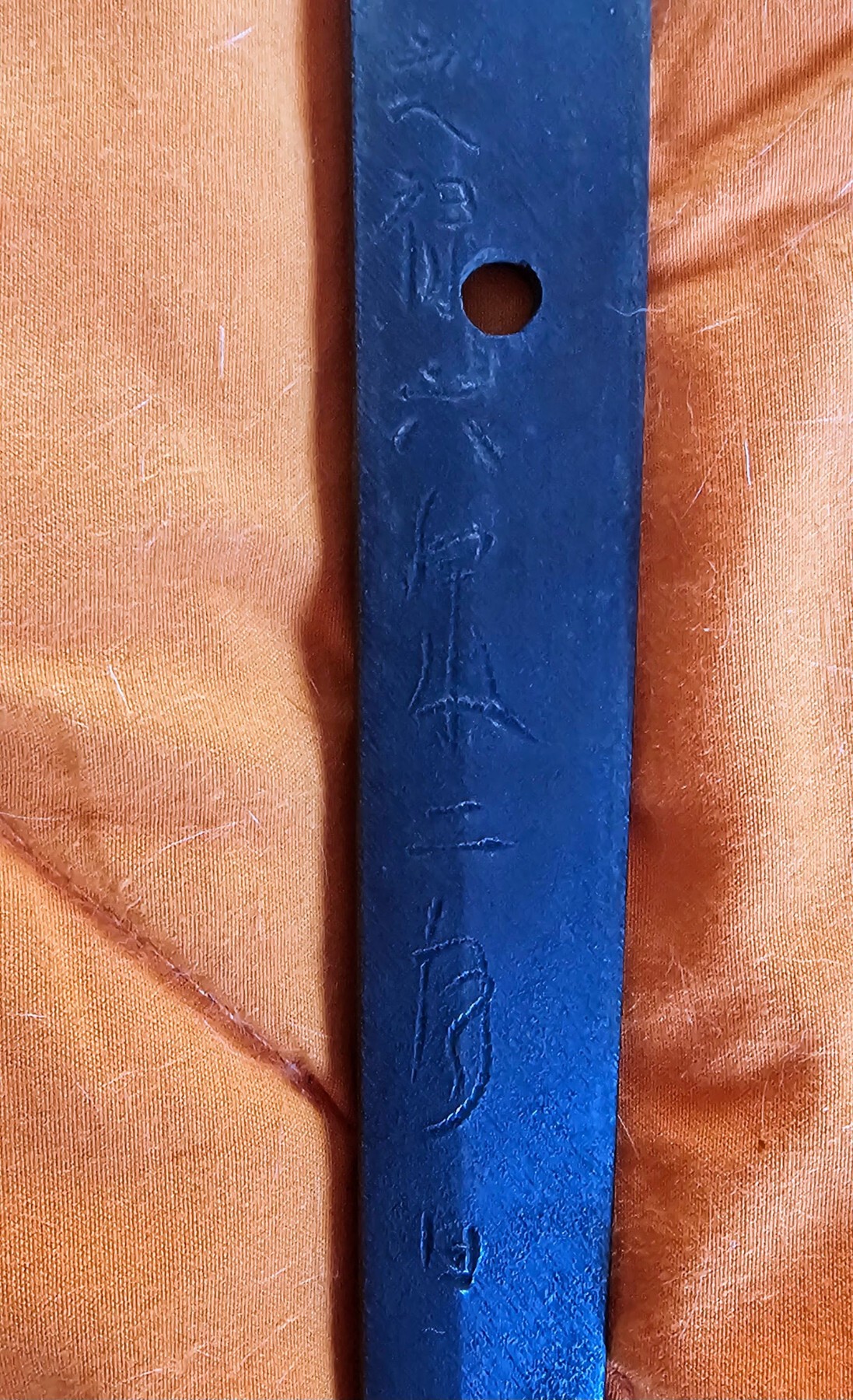

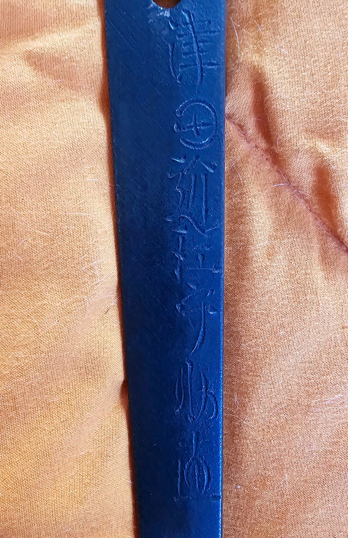

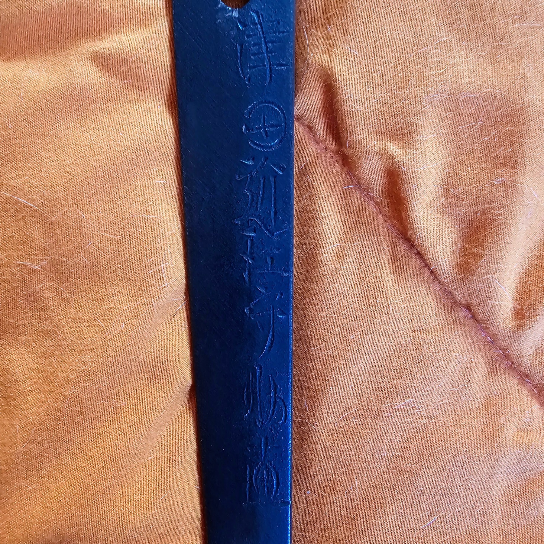

daleanson Posted May 11 Report Posted May 11 this blade came back with my uncle from ww2 can anyone help me identify it Quote
nulldevice Posted May 11 Report Posted May 11 津田近江守助直 Tsuda Omi no Kami Sukenao __禄六歳二月日 I'm not sure on the first character but its likely Genroku 8, February (1696) 2 1 Quote
Nobody Posted May 11 Report Posted May 11 FYI: A genuine Sukenao with the same date inscription (February 1693) - 津田近江守助直 元禄六歳二月日 Tsuda Ominokami Sukenao - 日本刀の通信販売 明倫産業株式会社 1 2 Quote

daleanson Posted May 18 Author Report Posted May 18 thank you much does it look authentic to you Quote
daleanson Posted May 19 Author Report Posted May 19 On 5/11/2025 at 12:19 AM, Nobody said: FYI: A genuine Sukenao with the same date inscription (February 1693) - 津田近江守助直 元禄六歳二月日 Tsuda Ominokami Sukenao - 日本刀の通信販売 明倫産業株式会社 Quote
daleanson Posted May 19 Author Report Posted May 19 does this mean the one I have shown is a fake? my uncle brought it back with him after ww2 he always said he wished it to go back to the family Quote

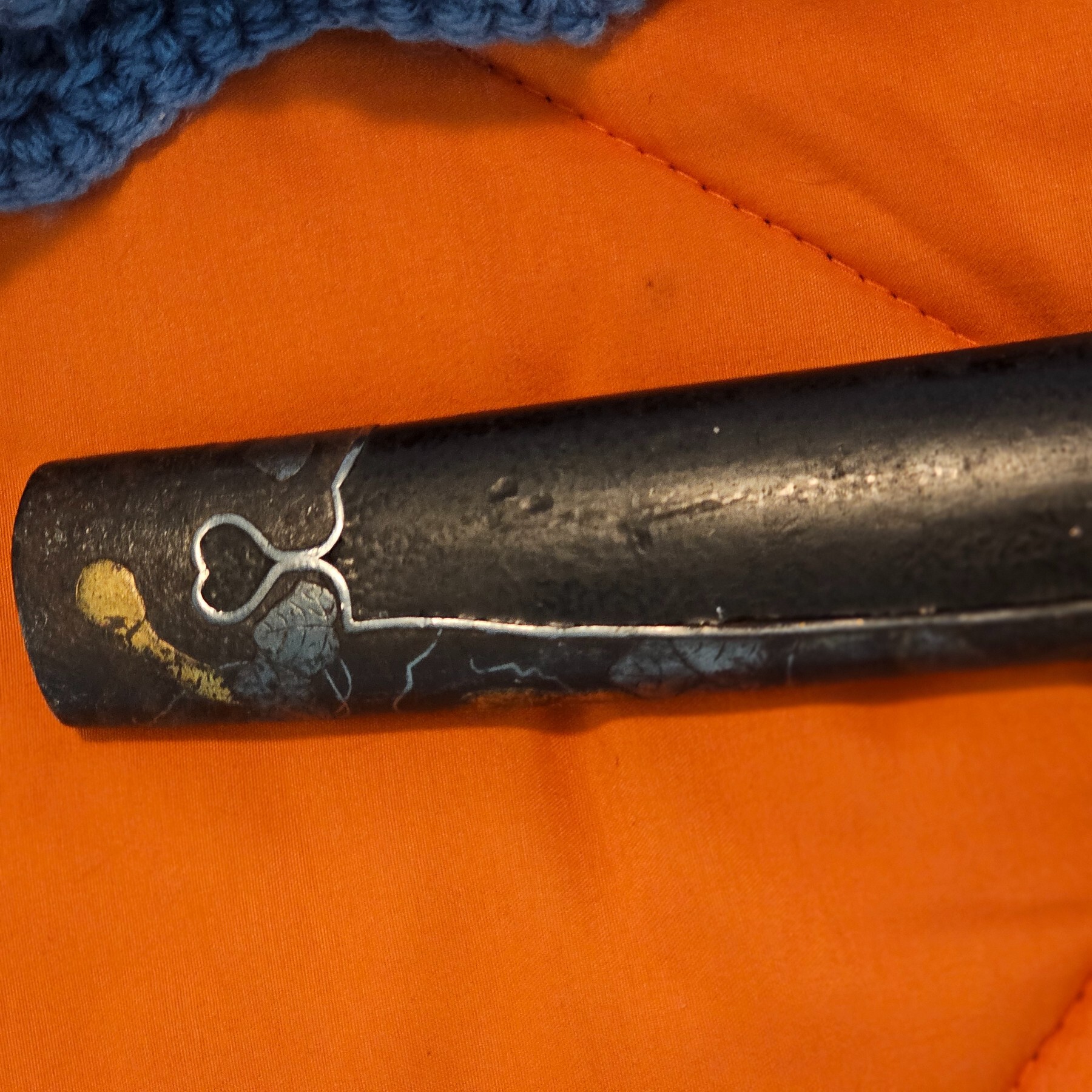

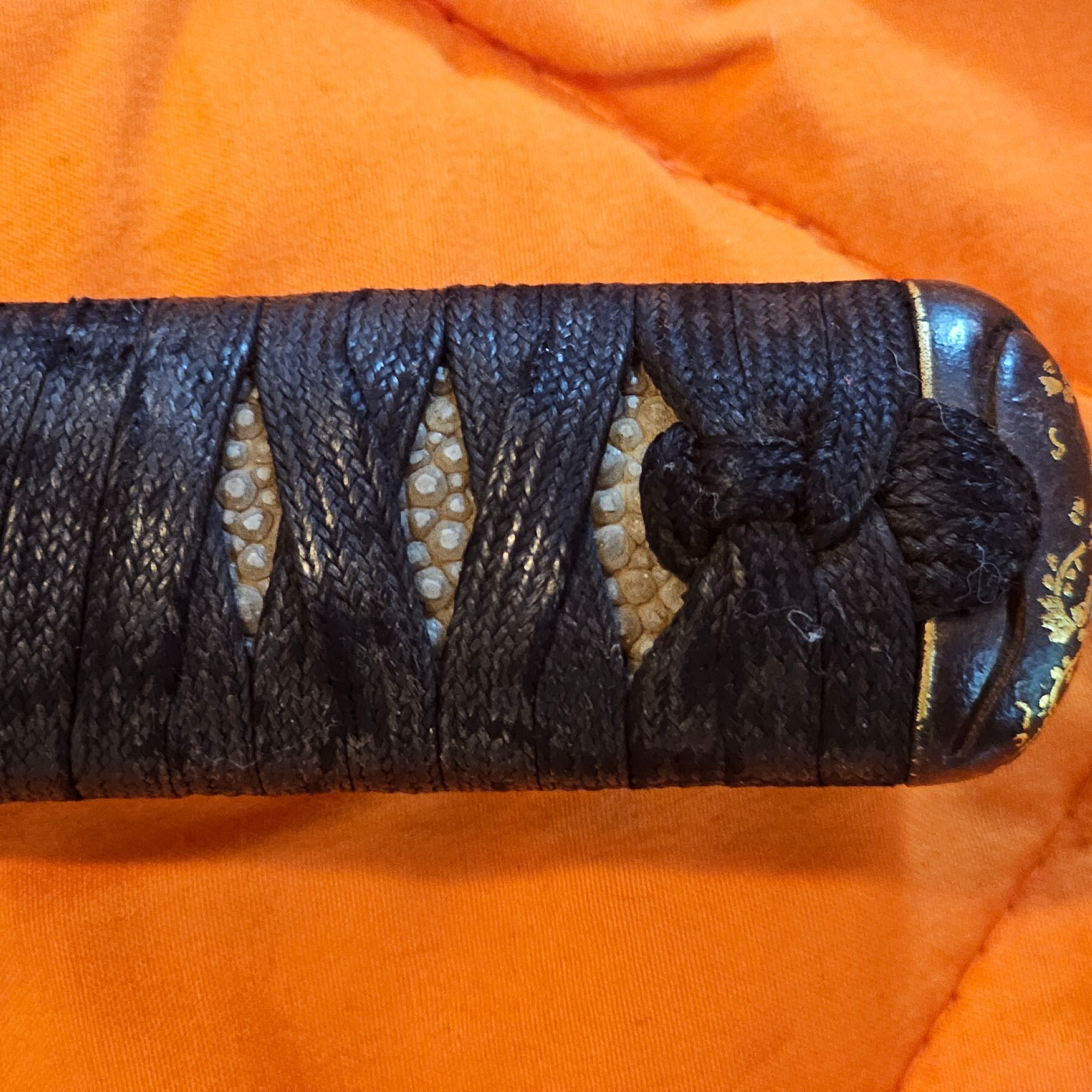

Geraint Posted May 19 Report Posted May 19 Dear Dale. It is common to find perfectly genuine swords with the signature of a well known maker added. Compare the signatures side by side and see what you think. Note for example that the date on your sword is aligned in a different part of the nakago/tang. The mountings for the sword are attractive in their own right and together this makes an interesting package so don't do anything hasty, just avoid touching the blade with your fingers, (it quickly rusts), and wipe a little light oil on it, just a very thin coat. This sword is not in military mounts, sometimes these come with a surrender tag from the owner, and so there is no real possibility of returning it unless you have some paperwork to go with it. It would be nice to see a shot of the whole blade, the whole mount and the tsuba/guard if you could. All the best. 2 1 Quote
