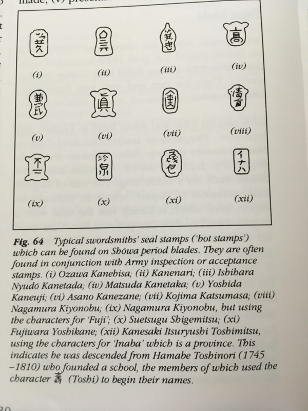

Bruce Pennington Posted April 6, 2025 Report Posted April 6, 2025 That is the first kokuin I've seen for Yoshimitsu. Oddly, Fuller has that one listed as being found on a "Yoshikane", number ix in the chart below: I have seen multiple smiths using the same stamp when they all work for the same shop. @mecox - Mal, any chance Yoshimitsu and Yoshikane worked at the same shop? Also, do the kana in the stamp say something useful? Quote
mecox Posted April 6, 2025 Report Posted April 6, 2025 Bruce, the kokuin stamp has two kanji for "Fuji" and looks like the smith is YOSHIMITSU 義光: real name Yabushita Fujio (藪下不二夫). So looks to be his given name? Born Taisho 4 (1915) August 18. Reg. Showa 15 (1940) April 1 (age 24). (“Noshu Seki ju Yoshimitsu saku” he has a dated blade of “1942” SEKI). Seki gunto smith. Dont know about the "Kiyonobu" in the F&G table? There were three "Yoshikane" with that "yoshi" kanji, I dont know which one you have. Quote
Bruce Pennington Posted April 6, 2025 Report Posted April 6, 2025 3 minutes ago, mecox said: There were three "Yoshikane" with that "yoshi" kanji, I dont know which one you have. Thanks Mal. I don't have one, it was just Richard Fuller's attribution in his chart of kokuin above, item ix. Either he made a mistake and miss-named the kokuin in the chart, or there were more than one smith using that same stamp. Quote
mecox Posted April 6, 2025 Report Posted April 6, 2025 The F&G table for (ix) has Nagamura Kiyonobu, not Yoshikane. These names dont look right? 2 Quote
Bruce Pennington Posted April 6, 2025 Report Posted April 6, 2025 Just now, mecox said: The F&G table for (ix) has Nagamura Kiyononu, not Yoshikane. These names dont look right? Oh, crap. I'm not really dyslexic, that I know of, but I had been looking down to the "xi" instead of ix!!! Well, now, he was really off on that name or again, Yoshimitsu and Kiyonobu worked at the same forge. Richard's book does have errors, it's just impossible to put out something that extensive without them. 1 Quote

Scogg Posted April 7, 2025 Report Posted April 7, 2025 The fact that swords exist with KOKUIN and also inspection stamps, implies to me, that swords with a hot stamp could be either SHOWATO or GENDAITO. My Osawa Kanehisa for example, also had a SEKI stamp. Notably, ASANO KANESANE and his company are believed to stamp his kokuin on both traditional and non traditional swords. https://www.japaneseswordindex.com/kanezane.htm Other interpretations may vary... -Sam Quote
