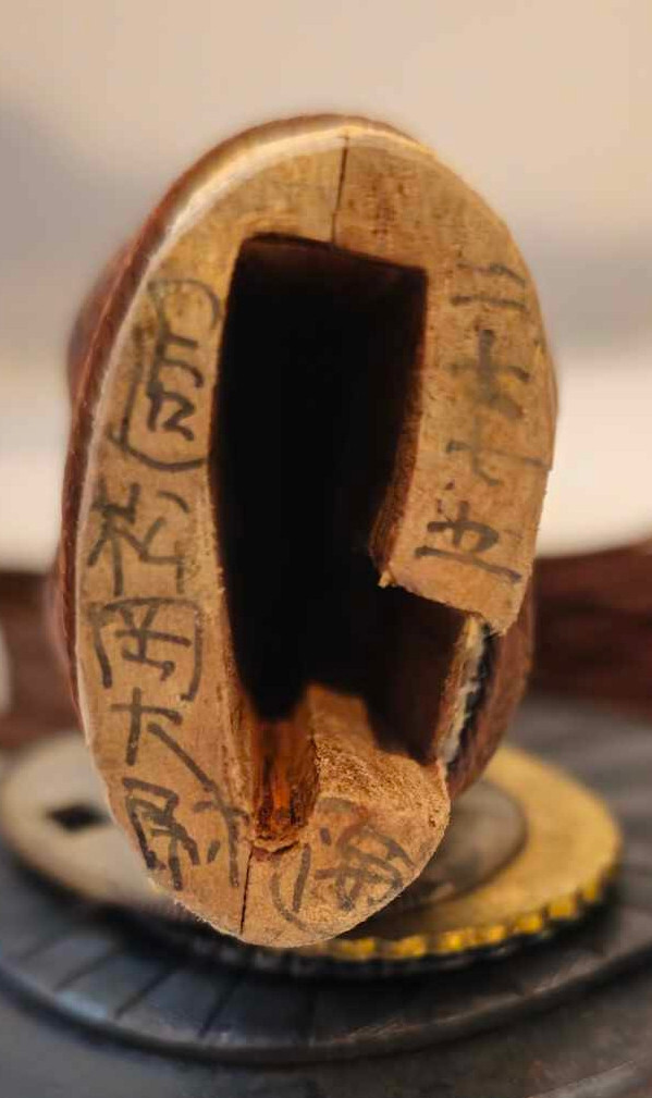

PNSSHOGUN Posted February 6, 2025 Report Posted February 6, 2025 Seeking professional assistance with profuse writing on the Fuchi: 3 1 Quote
moriarty Posted February 6, 2025 Report Posted February 6, 2025 Greetings John,, Thanks for letting such an interesting piece, militaria with some attached history is always a plus. Giving it the old college try: Left Outer Side X四海軍予え- (Fourth Naval Fleet Preliminary/Reserves? ) If any, the kanji above should be 第 Right Inner Fuchi- 二七七五 - (2-7-7-5) Left Inner Fuchi- 遞松岡下XホX - (Matsuoka Shita..Ho..) Hope this helps somewhat 3 Quote

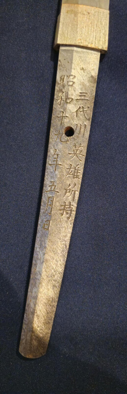

PNSSHOGUN Posted February 6, 2025 Author Report Posted February 6, 2025 Very interesting, thank you Maurice for the help. The numbers match what is stamped on all the fittings, there is also a Mon that I thought was referenced but the unit information is rather special. There is a Chumon-mei on the Nakago for a "Hideo Sanyogawa - 三代川英雄所持" who graduated from the 74th class at Etajima. 2 1 Quote

Nobody Posted February 6, 2025 Report Posted February 6, 2025 6 hours ago, moriarty said: ........................ Left Inner Fuchi- 遞松岡下XホX - (Matsuoka Shita..Ho..) ............................................................. (?) 松岡大尉 - Lieutenant Matsuoka 5 2 Quote
PNSSHOGUN Posted February 7, 2025 Author Report Posted February 7, 2025 Thank you Moriyama Sama, that is most interesting. Given the different names, you wonder if Lt Matsuoka arranged this sword for Lt Sanyogawa? 1 Quote
moriarty Posted February 8, 2025 Report Posted February 8, 2025 21 minutes ago, Kiipu said: Maybe a poorly written ㋩海軍拵え? Good eye Thomas! It's certainly more plausible Quote
