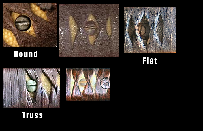

Volker those where different in size and wide.
The best is to know which kind of type 3 and which blade are in it. Then look for an example meassurements of a another collectors sword to find the right one.  Good luck for the search.
Some examples.

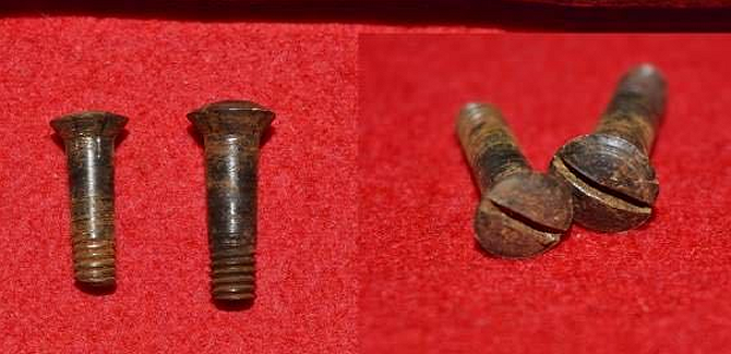

To get the screw is a real pain Volker i have made this 2 times and at the end i found the right on but i had 4 more which not fit and i doubt that these was ever in a type 3. I sold them further. I paid around $100 to find the 2 inklusive selling the ones i can't use.
I think the next time i will go to a blacksmith nearby and ask him to made a iron screw for me. That would be much cheaper when you know the measurement and the drill. I like the old flat head design of the screws in the akihisa type 3. The screw must fit in the inlet of the tsuka. Modern screws didn't fit - i test it all.

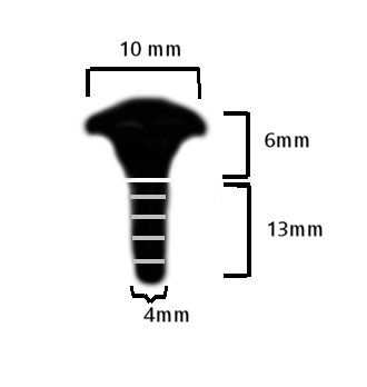

Many thanks goes to Chris, who pointed out to me that there are serval types of handlescrews for the Gunto tpye 3!!
Now here are the dimensions:
screw head diameter: 10 mm
head high  6mm
lenght for the handle of screw and sleeve around 22 mm
hop this helps to get one here in the web
I think it is the straight round head type. Not that conus ones with the flat head (like akihisa, nagamitsu, etc.). Volker did you have other type 3 with screws? You can try which on would fit.
http://kajiyahiroshi.../token-ka358101.html
I think you need this one Volker

I have these in my repair bin.  I have to check with one person who I may owe one but you can email me if anything might help you nixe@bright.net
mark
Mark,
The 3 tapered ones that seem identical, if you are at the SF show, please may I purchase one from you there?
