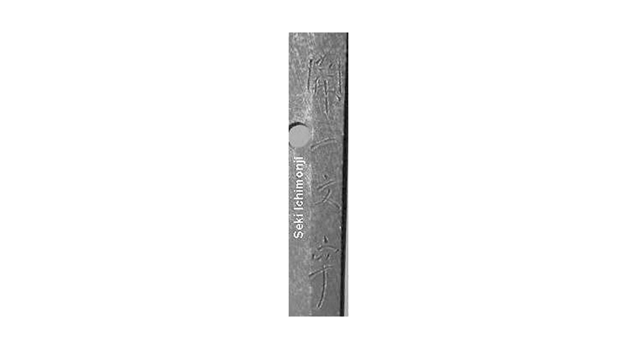

Bruce Pennington Posted December 15, 2022 Report Posted December 15, 2022 Hey guys, Found this in a kaigunto. I thought it was another Kiku ichimongi, but the first kanji doesn't match other mei I have on file. I have a vague recollection you've helped me with one like this before, but it's lost to antiquity. Thanks for the help! Quote
Bruce Pennington Posted December 15, 2022 Author Report Posted December 15, 2022 7 hours ago, Nobody said: 関一文字 - Seki Icimonji Thank you, Moriyamasan! Now, since Kiku Ichimonji was a tribute to an ancient shogun, was there a Seki shogun that this is honoring? Quote
Bruce Pennington Posted December 17, 2022 Author Report Posted December 17, 2022 @mecox - any insight on the significance of "Seki ichimonji?" Is it possible the first kanji is something other than Seki? Quote
uwe Posted December 17, 2022 Report Posted December 17, 2022 The first character looks a bit like the “handwriting” of 關. But that means also Seki (like Moriyama San suggested) or Mori. Hmm… 1 Quote
Toryu2020 Posted December 17, 2022 Report Posted December 17, 2022 Bruce - Kiku Ichimonji refers to the retired emperor Gotoba, not a Shogun. It has come to mean "A-Number One". So Seki Ichimonji may mean the artist made works in the Bizen style and are meant to be "the Best". I am sure this points to a particular smith and a short search would turn up who that is... -t 1 1 Quote

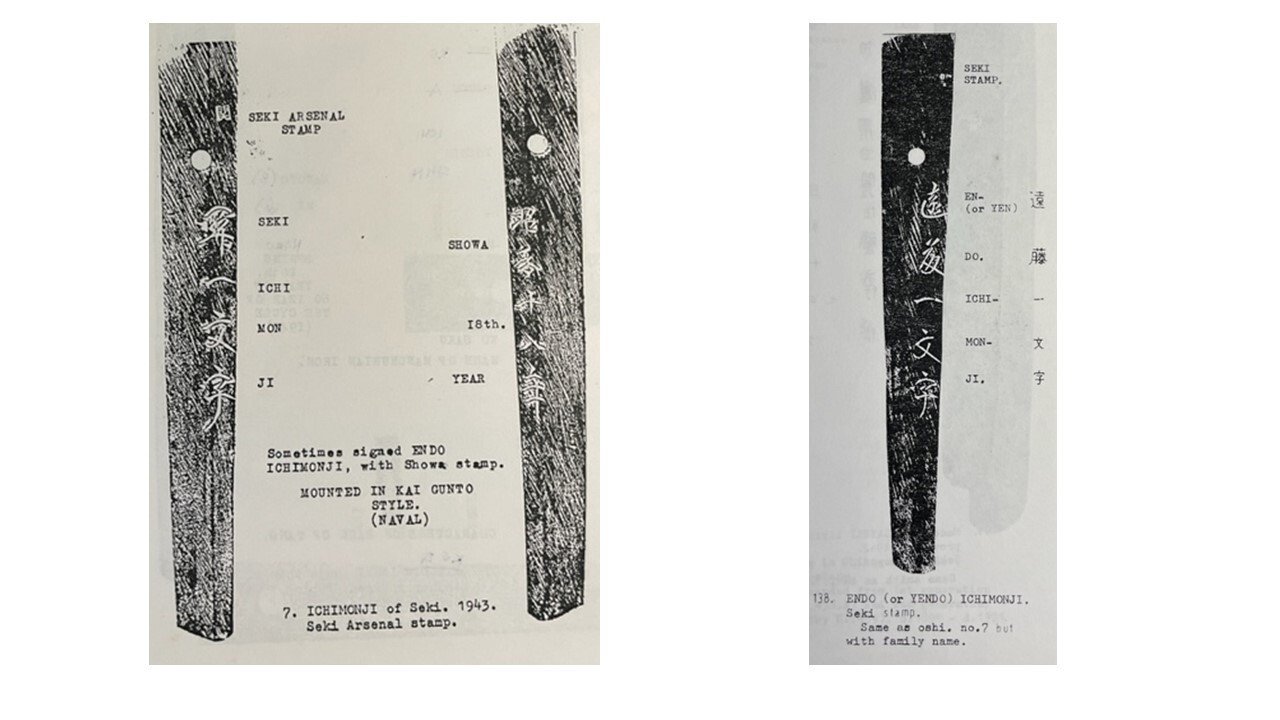

mecox Posted December 17, 2022 Report Posted December 17, 2022 Bruce and others. looks like this: ICHIMONJI (一文字), Shōwa (昭和, 1926-1989), Gifu – “Ichimonji” (一文字), real name Endō Masayuki (遠藤公之), born October 23rd 1890, he worked as a guntō smith. He was from Gifu, Kamo-gun, Tomioka-mura, Mia-ji. Registered as a Seki smith in Showa 16 (1941) Feb 9. Pic from Rick Stein page. The unusual "Seki" 關 is interesting. Found two more from F & G 1983, with some info. Ichimonji was also used by Amahide of Seki, but usually with his fuller name. 3 2 Quote
Bruce Pennington Posted December 18, 2022 Author Report Posted December 18, 2022 13 hours ago, Toryu2020 said: Bruce - Kiku Ichimonji refers to the retired emperor Gotoba, not a Shogun. It has come to mean "A-Number One". So Seki Ichimonji may mean the artist made works in the Bizen style and are meant to be "the Best". I am sure this points to a particular smith and a short search would turn up who that is... -t I have some Kanemichi blades on file with the Kiku Ichimonji, so maybe both your ideas were combined in his use of it. I was thinking along the same lines with the Seki Ichimonji idea too! 6 hours ago, mecox said: ICHIMONJI (一文字), Shōwa (昭和, 1926-1989), Gifu – “Ichimonji” (一文字), real name Endō Masayuki (遠藤公之), Mal, you nailed it! I never thought to check the Sword Forum Index site for the mei. Thanks guys, I enjoyed the discussion and the discovery! 2 Quote
