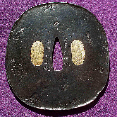

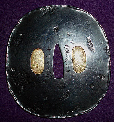

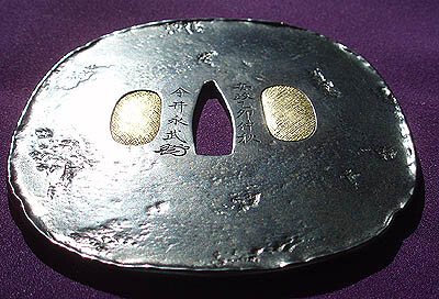

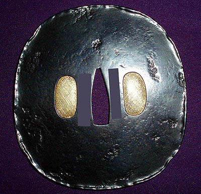

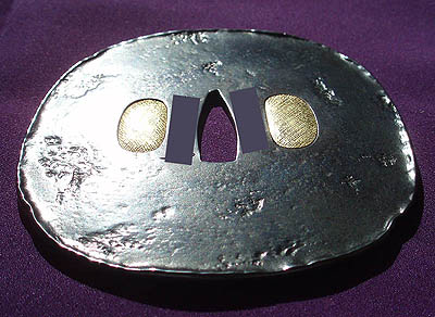

Markus Posted April 22, 2009 Report Posted April 22, 2009 Hi folks, As its quite a time since the last kantei, I would fill the gap and provide you with a new one. At first, I would just like to give you the pictures, allowing you to soak in the workmanship and execution of the piece. I am sure there are some out there which could pin this one down to at least the school at once, so I suggest to withhold or to use the spoiler function. It measures 8,0 cm in the width, and 8,5 cm in the length. The thickness at the rim is 0,35 cm. Quote

Martin Posted April 23, 2009 Report Posted April 23, 2009 Hi all, I have also seen this piece in hands and have to admit it is a REAL beauty. I guess it is very hard to take good pictures of it due to its DEEP black color. Congratulations once again on this one Markus. Good eye !! Cheers, Quote

John A Stuart Posted April 24, 2009 Report Posted April 24, 2009 Wow, the Tachikanaguchi tsuba really shows I need eye care. I wasn't even aware that those marks on the specimen tsuba were stamps. I was wondering what made that plate identifiable from others. They don't show well in the pics. John Quote
Markus Posted April 24, 2009 Author Report Posted April 24, 2009 Well, those who tried to participate did, and so I will solve this kantei. The artist ist Imai Nagatake, and the piece is signed: Imai Nagatake (今井永武) [kaô] - Ansei kinoto´u chûshû (安政乙卯仲秋, "Ansei, year of the hare [1855], eighth month") Yes, he was a student of Gotô Ichijô, a passionate waka poet, lived and worked in Kyôto, born 1818 and died 1882. As it is hard to pin it down to a certain artist with more techniques shown, I will give atari to Ford, Jean, and Curran. Now, how does one come to this artist. First, the raw material: iron, shakudô, suaka, shibuichi, yamagane, brass ... (I´ve tried to get the blueish-black shakudô, so that it is dinstinguishable from iron) I think everyone got the shakudô, and this precludes before (nearly) all tankô artists. What remains is (in a chronological manner) Ko-Kinkô (as John said), Gotô and sidelines, followed by the kinkô artists of the Edo period, the machibori group, and the metalworkers of the late Edo/bakumatsu period. Second, the interpretation: sukashi-tsuba or ita-tsuba Third, the shape: It shows a hardly accentuated mokkô-gata, with a very slight tendency towards aori. This in combination with the thinness and the ubu nakago-ana pins it relative quickly down to one of the late Edo/bakumatsu kinkô artists, especially to Gotô Ichijô who was (among others) renowned for such a shape. As Reinhard pointed out, such pieces were made at the beginning with old Momoyama works in mind, and so is the interpretation of the surface. Hawley mentions an interesting note, namely that "this artist kept more to the classical style and designs of the early Gotô Ichijô school". This tsuba is such a piece right out of the textbook. What was at the back of my mind with this kantei was, to present for a change once more a softmetal tsuba, because we already had some iron and sukashi works in the past. I think it was not that hard to vote for Ichijô or his school, and I must admit that I am very fond of the shape he and his school (and of course other contemporary artists) applied. As a comparison, I would like to add a picture which was shot under different lightning, with the result that it could be very easily mixed-up with iron. FYI: I´ve bought this one on the following site: http://japanesesword.de/ Fortunately, I recently had the chance to look at it hands-on, but there is more nice and reasonable prices stuff there so please take a look. for your interest. Quote
