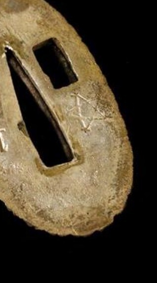

nightkid Posted March 26 Report Posted March 26 (edited) On 7/3/2022 at 9:52 AM, BANGBANGSAN said: The "8" mark maybe from Hiroshima Arsenal is there any possibility that these stamps can marked on type 98 gunto's tsuba and seppa? Edited March 26 by nightkid Quote
Bruce Pennington Posted March 26 Report Posted March 26 5 hours ago, nightkid said: Is there any possibility that these stamps can marked on type 98 gunto's tsuba and seppa? Yes. It's not common, however we have seen various arsenal inspector stamps on tsuba, seppa, kabutogane, and haikan. The Gourd - I have 5 blades on file with it, all navy stainless blades The "8" - I have 2 on file, both army; a Hidetoshi, and a Kanemichi Kanemichi Hidetoshi 1 Quote
nightkid Posted March 26 Report Posted March 26 38 minutes ago, Bruce Pennington said: Yes. It's not common, however we have seen various arsenal inspector stamps on tsuba, seppa, kabutogane, and haikan. The Gourd - I have 5 blades on file with it, all navy stainless blades The "8" - I have 2 on file, both army; a Hidetoshi, and a Kanemichi Kanemichi Hidetoshi hello sir! thank you for answering! i saw this gunto seppa and this one has star stamp on it. i look around stamp dicuss forum but i still can't find any information but this writing may be the answer. so this can be made by heijo arsenal? i really appreciate your answer. Quote
Bruce Pennington Posted March 26 Report Posted March 26 Kim, I have fittings, mostly tsuba & seppa, on file with three different star stamps. Yours is only the second example I've seen with the larger star with crossed points. Here is the other: Here is an example of a medium sized star: And I have several with these small stars: No one knows who used them, but I've always guessed them to be inspectors of the koshirae shops that made the fittings. Your idea about the Heijo factory is interesting, as they were known to make Type 95s late in the war. But this star is not one of the examples on the chart as it has cross strokes on each star tip. Doesn't rule it out, as even on that chart, they have a variant star indicated. All we can do, for now, is guess. But your guess is as good as mine at this point. 1 Quote
nightkid Posted March 26 Report Posted March 26 (edited) 2 hours ago, Bruce Pennington said: Kim, I have fittings, mostly tsuba & seppa, on file with three different star stamps. Yours is only the second example I've seen with the larger star with crossed points. Here is the other: Here is an example of a medium sized star: And I have several with these small stars: No one knows who used them, but I've always guessed them to be inspectors of the koshirae shops that made the fittings. Your idea about the Heijo factory is interesting, as they were known to make Type 95s late in the war. But this star is not one of the examples on the chart as it has cross strokes on each star tip. Doesn't rule it out, as even on that chart, they have a variant star indicated. All we can do, for now, is guess. But your guess is as good as mine at this point. thank you sir. that seppa has number 17 and the tsuba also has same stroke star stamp and number 17 and katakana マ and ホ. i think katakana can be inspection stamps. i really excited to your picture whick has numbering 18. thank you for sharing your knowledge. Edited March 26 by nightkid 1 Quote
Bruce Pennington Posted March 26 Report Posted March 26 Wow! These were possibly side by side in the production! I say possibly, because over several years, a shop likely restarted numbering sequences. Pretty cool, though. Quote
