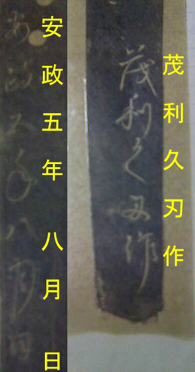

That's an interesting way to use On readings in combination to give a Japanese name. The furigana shows how it works. I noticed something similar when reading some Chinese documents about Japanese history. When translated to English it is difficult to know the person referred to. John

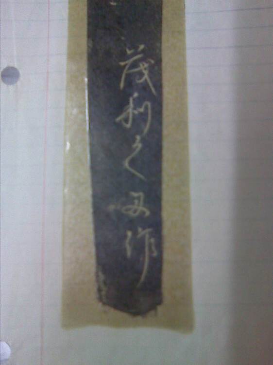

With all due respect to Morita-san, but this mei doesn't make sense to me. Translating the Kana for vocal "a" as "AN" doesn't make sense to me. Asking for enlightment.
reinhard

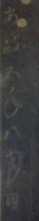

In this case I think that the “あ” on the nakago is not Kana. That should be thought as 安 in Sosho style.
(But this might be rather confusing as the origin of Kana is Sosho.)
Peter,
Did you understand my answer?
Perhaps, no one might have been able to read this signature(Morikuni) before you posting here and in U.K.
There were 3-4 sword smith Morikuni(守國,盛國,護國)in around Ansei(安政) period.
Therefore, Morikuni(もりくに,your sword) might be someone in 3-4 swordsmith.
Morita
Morita San,
Thanks for your help. It belongs to a friend of a friend and in the 20+ years he's owned it no one has been able to translate it until today.
Your assistance is much appreciated, I will check out the Morikuni smiths.
Thanks,
Peter
