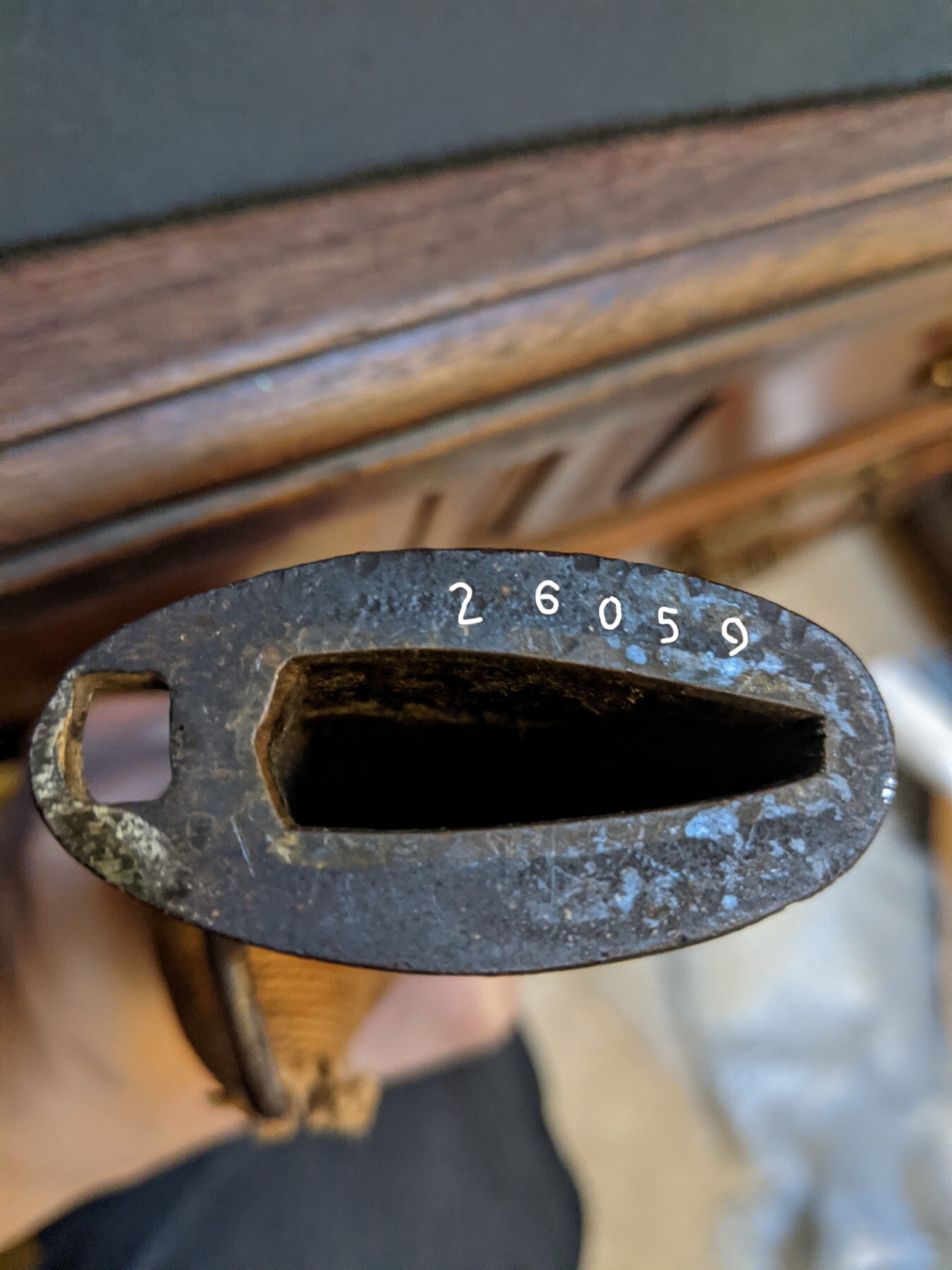

Is the scabbard painted black or is it some other color?  Is the scabbard serial number matching to the blade serial number?
Apologies Thomas, I didn't see this
The colour is a very very dark brown almost to the point of black.
the serial number does match yes, it's very obscured though, i've taken a quick picture for you as best I can.

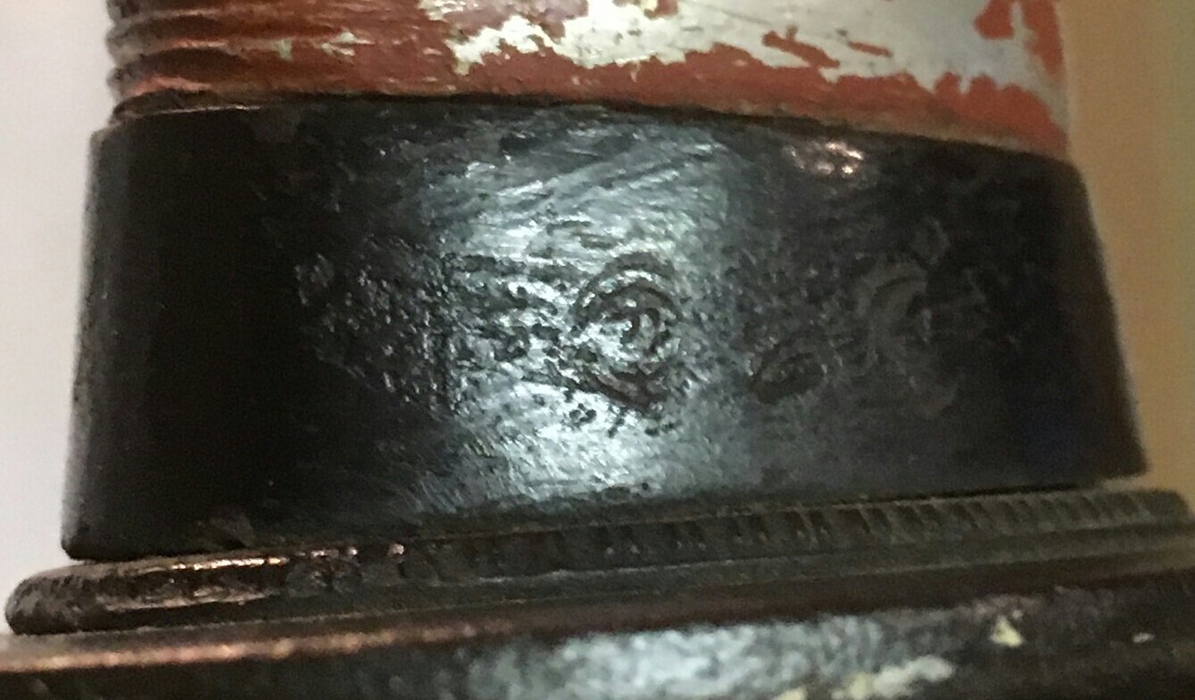

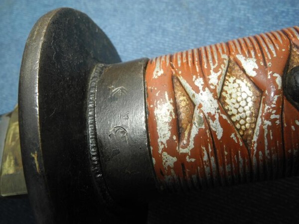

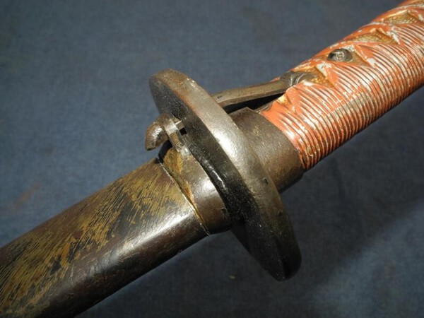

I've come across a Nagoya side-latch, number 201833, Seki inspector on the blade that has a Seki inspector stamp on the fuchi!  I don't recall ever seeing one in that location.  Has anyone else?
It was posted by ac1976 on this Guns.ru thread.
Bruce
Here is a Side Latch #202030. It has some marks on the fuchi, but they are not close enough to tell what they were.
Yes, my Seki/Nagoya side-latch is the same.  Center inspector mark is not readable.  Since it's so rare to get readable stamps on these steel fuchi, it's possible they were using the Seki stamp in the center a lot, but we just aren't able to observe them.  I suppose it makes sense, as the Nagoya Arsenal started using the small Seki in 1943-45 on officer blades, they probably started doing the same on Type 95s.  I wonder if anyone has ever seen a wooden handled 95 with stamps?  I checked mine, and it doesn't appear that they even tried stamping the fuchi.
