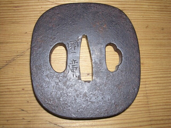

samusamu Posted August 30, 2021 Report Posted August 30, 2021 halo friend this is legit tsuka gunto? but the kabutogane look no ornament sakura in the back and tsuba It's real ? What translation on the tsuba? thank you Quote
Brian Posted August 30, 2021 Report Posted August 30, 2021 Tsuba is upside down. Please rotate. The sword looks genuine from what we can see. Unusual in Indonesia. 1 Quote
samusamu Posted August 30, 2021 Author Report Posted August 30, 2021 Halo thank you sorry,, this addition photo yes this from indonesia but koshirae only. how about the kabutogane? Looks right? Quote
Grey Doffin Posted August 30, 2021 Report Posted August 30, 2021 The tsuba is signed Kunihiro, I believe. Grey Quote
uwe Posted August 30, 2021 Report Posted August 30, 2021 Seems he made several with the same shape.... Quote
Bruce Pennington Posted August 31, 2021 Report Posted August 31, 2021 The gunto appears to be late-war. I have seen other examples of that style kabutogane. The fuchi is navy, but looks like it was original to the sword, adding to my view that this was assembled late in the war. Quote
Bruce Pennington Posted August 31, 2021 Report Posted August 31, 2021 Can we get photos of the nakago? Quote
