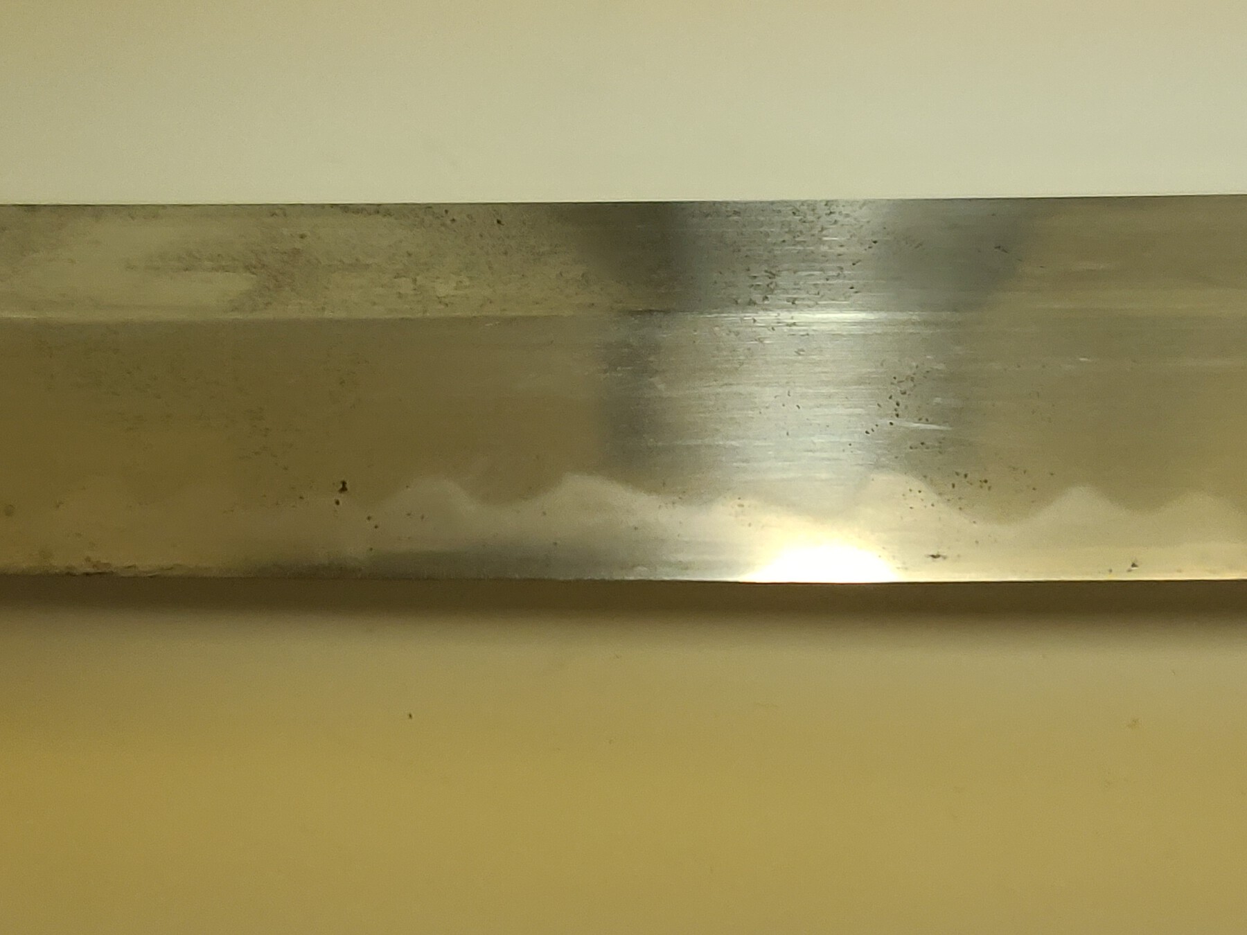

No stamps, right?
Somehow, I "think" it might be a Gendaito, but it’s more gut feeling than anything else.
No they’re not ,but could be muji and the Hada (if there is any) is obscured by the poor polish.
... but a much better one. Still going with Gendaito. There’s activity there.
and no dark spots that would make ,e feel of water quenching.

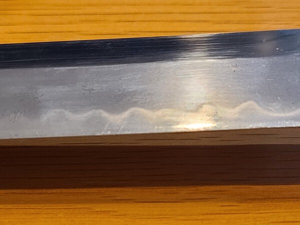

Its hamon activity for one Andrew.  I passed on the above blade because it was too hard to tell if Nie and nioi were present due to bad photos and old polish.  I can definitely see the activity on my Yoshimichi blade, and it has helped me learn.
I have also learned to stay away from liveAuctioneers sales as they are really not as described in the photos.  As you ask for more pictures the trash becomes apparent.

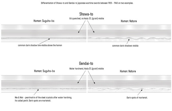

i paint this fast to explain.
On the upper side you see gendaito / down side showato.
You see on a gendaito the structures of the pearl matrix of the iron after hardning in water. On a showato all is uniform. with a mostly dark line during the hamon and dark shadows in the spikes of the hamon if it is not suguha-ba (straight hamon). Most of the gendaito where forged in masame hada - straight lines. Most of the showato you didn't see a hada between the layers of the iron. If you see some dark or bright shining spots which looks like asteroids rocks in front of the sun, this is nie and dark ones like ara-nie and a sure sign of gendaito.
Btw: Don't forget that a wartime polish isn't such shining as a modern polish. The sword looks much more decent and you must play with the lights and angles to see all the beauty of a blade.

Chris,
That is an excellent illustration! Take a bit more time and do one a bit more detailed (it's already good) and I'll add a section on it in the FAQ?

Chris and Jesse,
Thank you for your explanations. I am half way through reading your website on RJT Gendaito Chris, and am keeping your remarks in mind when making my way through the content.
I have been looking at higher quality blades/nihonto to increase my pattern recognition. Some of these points I have managed to deduce myself, but the activity of the hamon has been something that has been hard to quantify. You have done an excellent job putting this into words.
