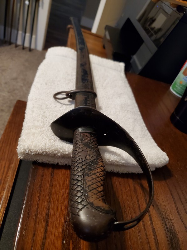

dwmc Posted December 15, 2020 Report Share Posted December 15, 2020 Over the years I couldn't help but notice many Type 32 Gunto's, both Ko and Otsu's have been painted black. I get the sense that these black painted Type 32's were painted either WWll or before and not post war. Anyone happen to know the reason behind the black paint? Thanks, Dave M. https://www.ebay.com/itm/WWII-Japanese-M1899-TYPE-32-OTSU-TROOPERS-SWORD-SCABBARD-MATCHING-NUMBERS/224236094829?hash=item343583456d:g:djgAAOSwiVRfsZnP Quote Link to comment Share on other sites More sharing options...

dwmc Posted December 15, 2020 Author Report Share Posted December 15, 2020 Thanks Trystan, interesting possibility. Dave M. Quote Link to comment Share on other sites More sharing options...

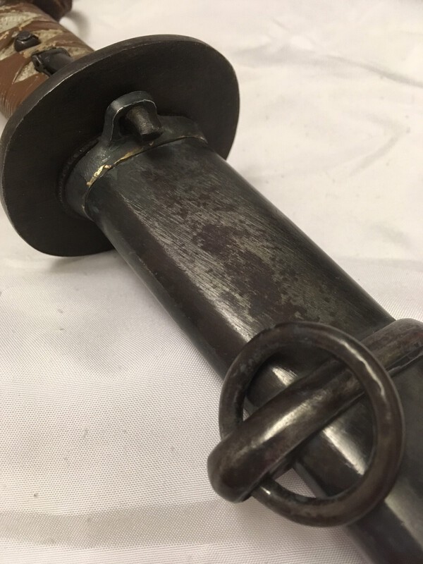

Shamsy Posted December 16, 2020 Report Share Posted December 16, 2020 I would guess, Dave, simply a matter of exposed metal rusting and painted metal being protected. Because there is often original paint underneath the 95s and the application quite crude, my suspicion is that it is a crude 'field fix'. Type 32 were never painted, so they should be a neater application of the black paint. Some of my 32, all with leather seppa. Top to bottom: Black paint Light metalic blue Deeper.... blue? In the white These are great swords too. Under rated to collect but very well made and relatively cheap. The stories some of these swords could tell. As we were discussing arsenal refurbishment, I've included a couple of photos of number 3. The saya has undergone re-matching twice before. Just an interesting thing to see. 3 Quote Link to comment Share on other sites More sharing options...

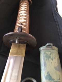

Bruce Pennington Posted December 16, 2020 Report Share Posted December 16, 2020 13 hours ago, Shamsy said: Light metalic blue Deeper.... blue? Steve, After seeing your "blued" sayas, it made me think about one of my 95s. It's the one with the mottled green paint that I assumed was a bad Bubba post-war job. I had stripped the greens and what remained was a darkened "blue" finish to the steel. After seeing your 32s with that same finish, I'm starting to think this was a regular finish done, for some reason, on some saya. Apparently it wasn't done to all saya, so why just to some? Maybe it was needed for a particular type of top-coat paint that in use for the moment? (I still regret stripping that green paint!) Dave, sorry for taking your thread off-topic! 1 Quote Link to comment Share on other sites More sharing options...
