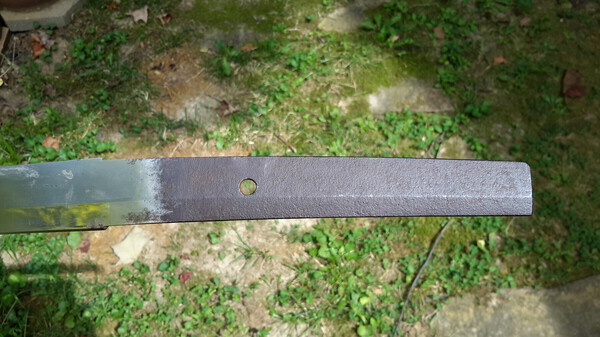

ChrisW Posted September 14, 2020 Report Posted September 14, 2020 Hey guys, Been a while since I posted a blade, and while I am strapped for cash, this is a blade that I got in my trip to Arizona a while back from a gentleman by the name of Brian Quinn. A real stand-up guy and he sold this to me at a really fair price. Its fairly nice to look at and while the polish is not particularly great anymore, there's enough to enjoy. It measures 28.5" nagasa and has a mostly complete signature. I'll let the pictures do the talking since I am crap for words anyways. What I'd like is a name attached to this blade and an opinion on the signature itself. Anything else is gravy! 1 Quote

SteveM Posted September 14, 2020 Report Posted September 14, 2020 津田越前守助廣 Tsuda Echizen-no-kami Sukehiro 2 Quote
ChrisW Posted September 14, 2020 Author Report Posted September 14, 2020 Ah... probably gimei then? Mmm big name like that, probably gimei. But, I did buy it for the shape and the hamon pattern anyways, so no bother! 1 Quote

Stephen Posted September 16, 2020 Report Posted September 16, 2020 (edited) BQ Knows his stuff suprised he didn't say smith. If you have bright room hold at ceiling corner with a little bit of movement you should see the hamon pop out. The more i look at the blade an not the ground the more im liking it. Edited September 16, 2020 by Stephen Crop rotate Quote

Surfson Posted September 17, 2020 Report Posted September 17, 2020 Steve has it exactly right, Sukehiro, and without study, I think you are exactly right - it looks gimei to me. Quote
AntiquarianCat Posted September 17, 2020 Report Posted September 17, 2020 Hello Robert, if you don’t mind my asking what are the best tells for gimei? The signature looks oddly fresh, unweathered and deep for an old sword; would that be part of the problem? Quote
Surfson Posted September 18, 2020 Report Posted September 18, 2020 Sorry I don't have time for a long answer. My recollection is that he had two main periods of signing, one was called Kakumei and the other was Marumei, meaning square and round. If I am not mistaken, the maru mei period was the one in which he mostly used Tsuda, and the signatures were quite flowing, almost like grass script. I'm sure you can google Sukehiro signature examples and find lots of discussions about it. Even looking in Fujishiro should make it clear. 1 Quote

Stephen Posted September 18, 2020 Report Posted September 18, 2020 Last attempt to redeem n help It looks like dried yellow uchiko powder Did you Google the translation SM gave you.. ? You'll find more than a few examples of his mei. Hot water an old toothbrush will clean up the mei. Note the strokes are the chippy style. Quote
