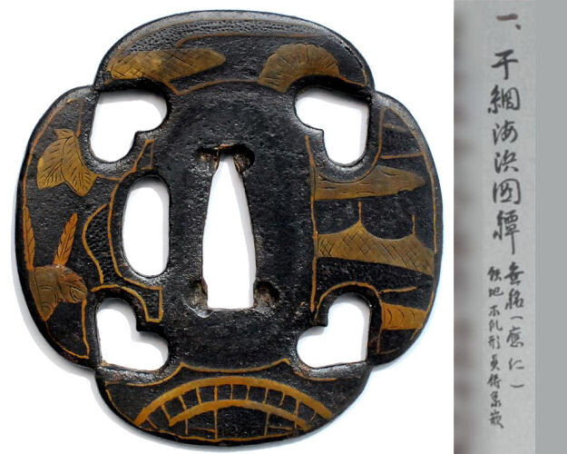

Hi Luca, really a wonderful piece!
I'm sorry I'm unable to offer help on subjects depicted. I wish just to point out a tsuba of similar kind attributed to Ōnin by an old NBTHK paper.

I think there is a slight relation to the themes. Mauro's paperwork notes the theme as "drying nets and beach" (干網浦浜). The image on the right side of Mauro's tsuba clearly shows the nets hung up to dry. They look a bit like a tent, which is a similar shape seen on the north quadrant of Luca's tsuba, which also fits in with the plover (千鳥) on the south quadrant. For a different treatment on plover and drying nets, see the tsuba below
http://mizusumashi.com/post-11718/
I can't figure out what the other motifs are, but I'm wondering if the shapes on the east/west are sand dunes.
On the opposite side I agree with the tsuzumi and sasa, but the connection eludes me. I was thinking summer/winter (drying nets for summer, and sasa for winter on the opposite side) but I don't know what to make of the tsuzumi.
The cartwheel motif also seems to be repeated. There has to be an underlying, connecting theme.
