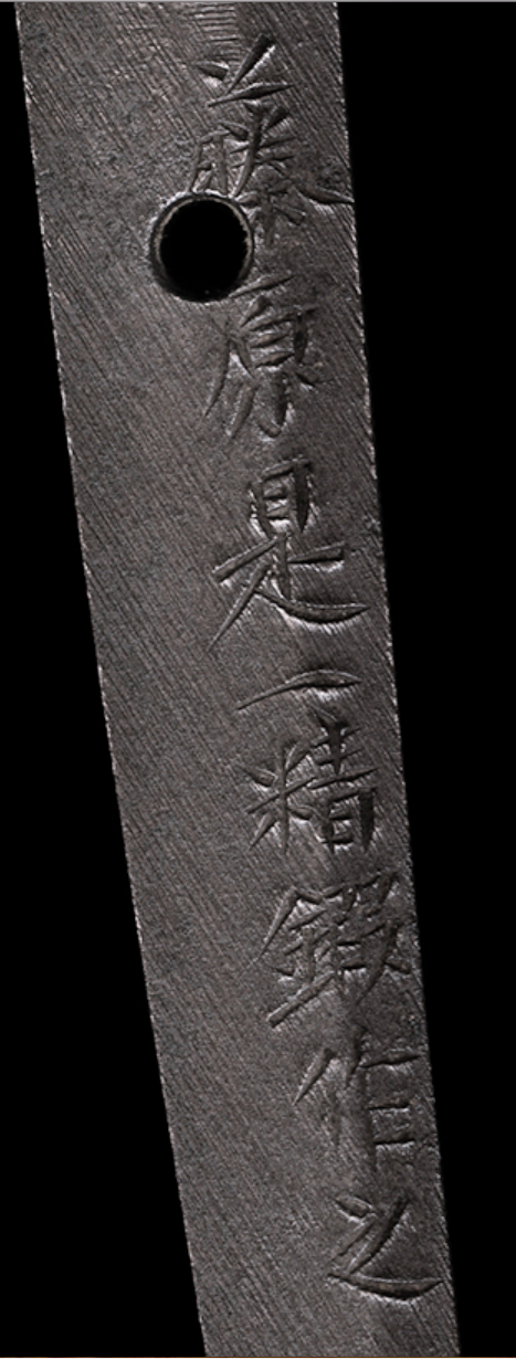

Could I have some feedback on this mei please . I did find a mei on this site looked close, seems to be alot of copies around . 62.2 cm long small Katana in late war Kaigunto mounts  Thank you Geoff

All I can say is that if gimei (probable), the faker did a rather good job at reproducing the strokes.
Geoff, there are nine generations.  Based on this date, I think that it could only be 7, 8 or 9.  If it's gimei, it is probably purporting to be 7, since he is the most famous, along with the first generation.  I haven't studied the mei, but I have a 7th generation and am attaching a photo of the mei.
I made a side by side comparison, but the site wouldn't let me upload it for some reason.  It isn't a bad likeness.  I will try again on the next box.
The last two kanji on yours, which I think say "sei-tan" or respectfully made, are pretty different.  I am leaning toward it not being 7th generation or being gimei of 7.  You will need examples of 8th and 9th generations.
