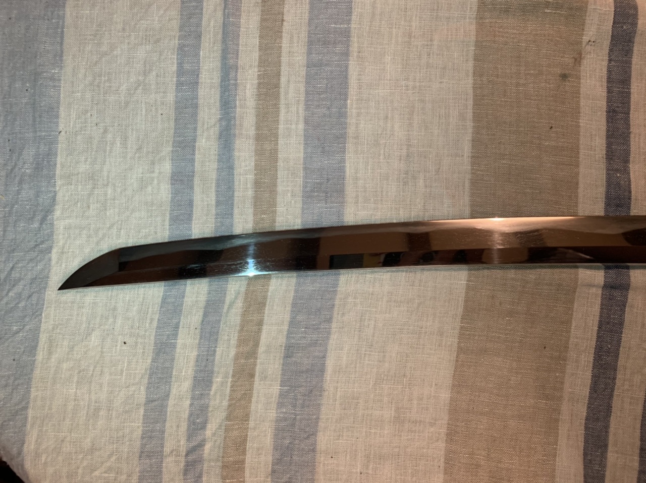

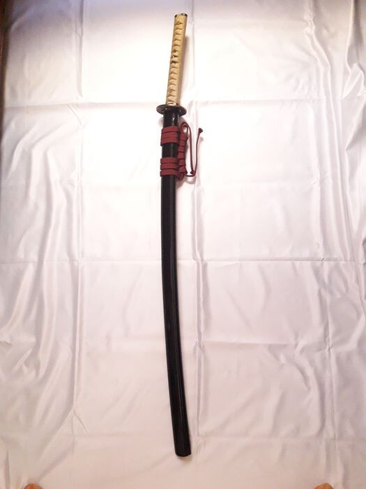

Eckart, please add one more image of the full-length,totally-bare blade, as sugata is the first feature to look at.
Share this post
Link to post
Ken, thanks. Adding one further photo per request. Lighting is poor but the shape is reasonably clear.post-5461-0-05956600-1594009662_thumb.jpeg

I think everything was made to deceive here. The nakago is suriage for no reason it seems.

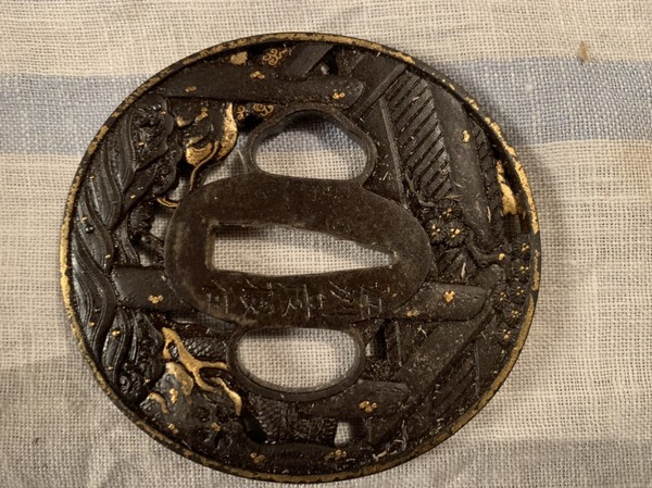

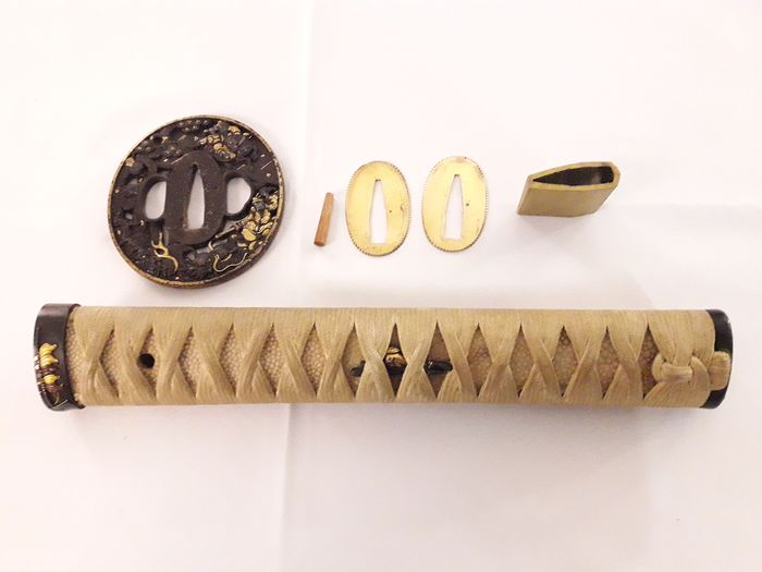

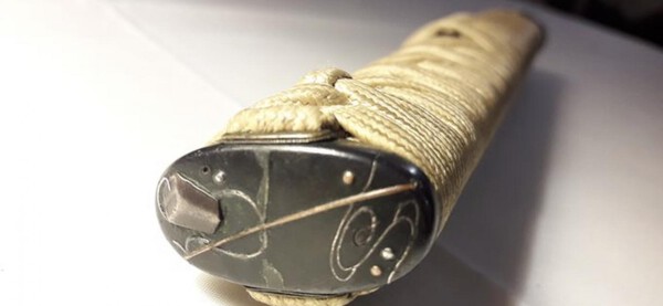

I was going to roll with modern sword based on the koshirae which looked 20th century to me.now I've seen the Nakago blade may be shinshinto still think the mounts are not that old.can we see more detail of the fuchi, kashira and tsuba please?

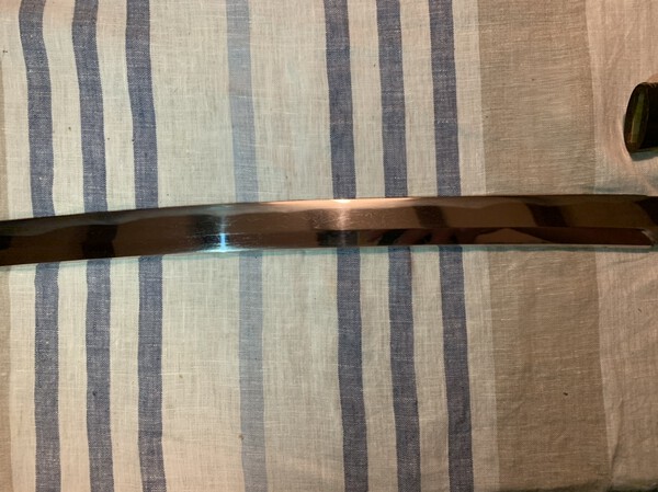

What about the polish? The JI is so glossy that no HADA is visible. Not good!

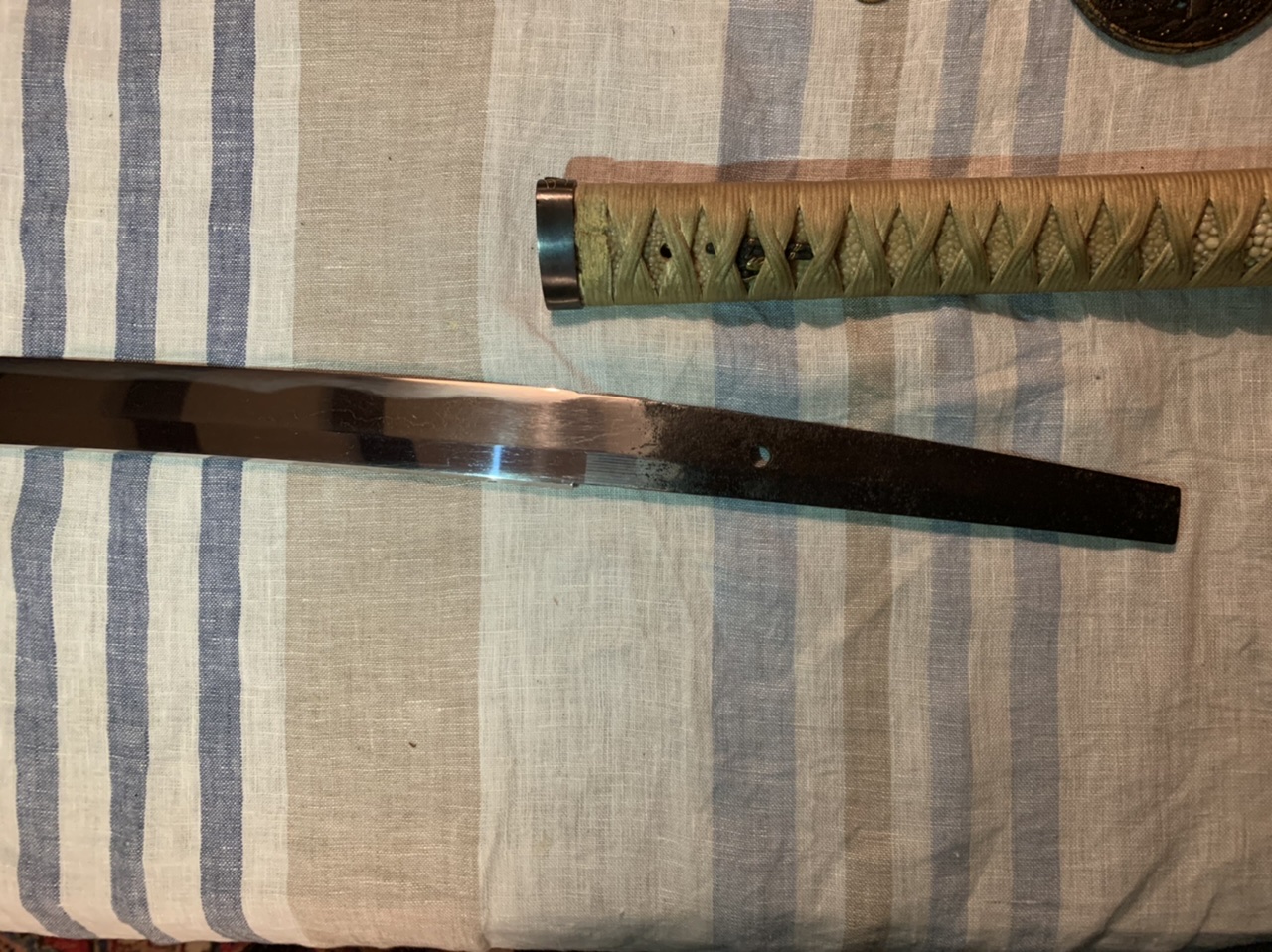

Thanks for the further questions. I think these are down to my poor photos more than the blade or fittings though. My own photos under terrible lighting follow:post-5461-0-80212000-1594132238_thumb.jpegpost-5461-0-65543500-1594132294_thumb.jpegpost-5461-0-82316300-1594132388_thumb.jpegpost-5461-0-03228200-1594132459_thumb.jpegpost-5461-0-93300200-1594132491_thumb.jpegpost-5461-0-89180100-1594132544_thumb.jpegpost-5461-0-57774000-1594132581_thumb.jpegpost-5461-0-73432000-1594132667_thumb.jpegpost-5461-0-74564500-1594132854_thumb.jpegpost-5461-0-01503500-1594178616_thumb.jpg

At least there is Hada, so traditional sword. When I first saw the pictures, I thought the ji was so glossy it looked like a WW2 Showato..

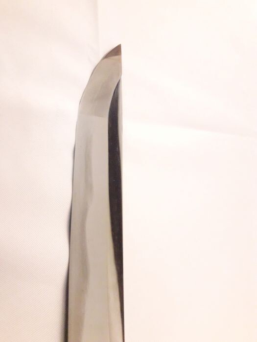

The HADORI is another problem which we can't solve without holding the blade in hand. In general, making photos of the YAKIBA is difficult and don't help much.

Looking at the start of the hamon, this sword doesn't seem to be suriage... but seems pretty tired...
Thanks, Jacques.  "Pretty tired" in that the machi look ground down?  Or are there other features that point you to that opinion?  I've read some of the older threads on "tiredness" and see a lot of mention of shingane.  To my eye, there aren't dull patches as such, but perhaps that's the point others above have made about hadori hiding those?
Regarding the suriage, you conclude that from the hamon trailing down just beyond the machi as opposed to "continuing" deep into the nakago?  Is that correct?  Thanks for any further pointers-- particularly if any literature you think worthwhile on the wear/tiring effects of polishing.

Hi Eckart,
I'd look at the hamon termination as a bit suspect, too.  If the blade has been shortened significantly, so that 'new' tang is formed over part of the blade that had previoulsy been polished, the hamon should run deeper into the tang, not stop short of the hamachi, as it seems to do here.  Unless the sword as a whole had been retempered, creating a new hamon (without getting into too much detail, often this creates a stylistic contrast with the original/alleged smith's work).  This would also help explain the very white, bright metal of the hamon boundary, although this isn't uncommon in perfectly authentic shin-shinto period work, either (I have an example myself); and possibly also contributes to the 'tiredness' of the surface metal.
The concept of tiredness is a bit harder to define.  You get a feel for it after you get a chance to examine a number of antique and/or well-used blades, but you might imagine that repeated or heavy repolishing, ie, grinding down the hard surface steel, especially at the ji and ha, produces a more coarse, almost uneven appearance to the grain, the hada, whatever it's pattern might be (itame, mokume, etc).  At the extreme, the hamon becomes quite shallow, as some of it's metal at the edge is lost, and the blade might show 'ware,' or openings in the grain, potentially deep enough to expose the softer iron core of the sword.  It can be hard to discern between a high quality, but worn, blade, and one that was wasn't forged to the same standards, or perhaps flawed in the hardening & tempering process.
