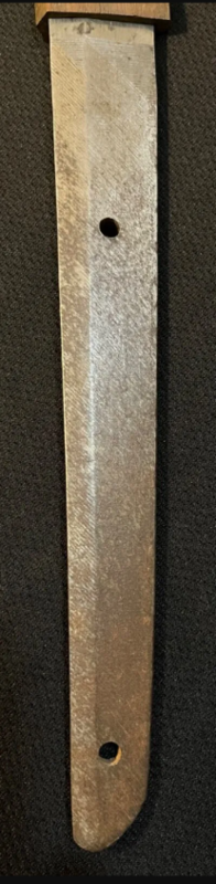

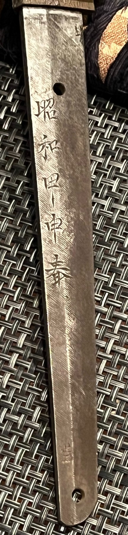

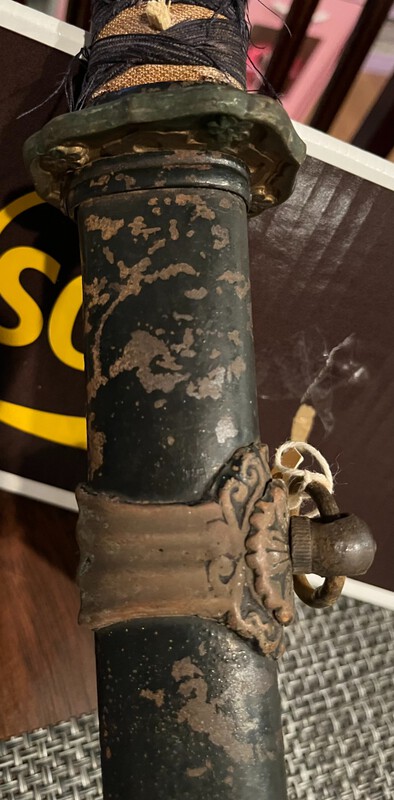

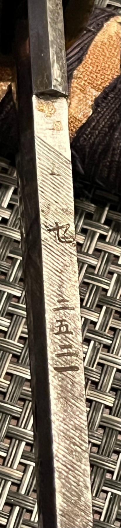

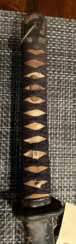

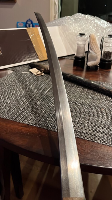

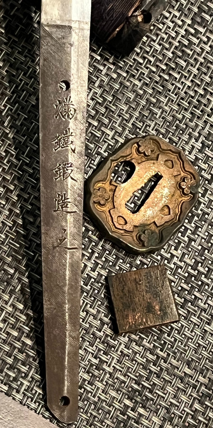

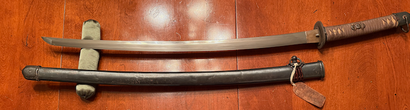

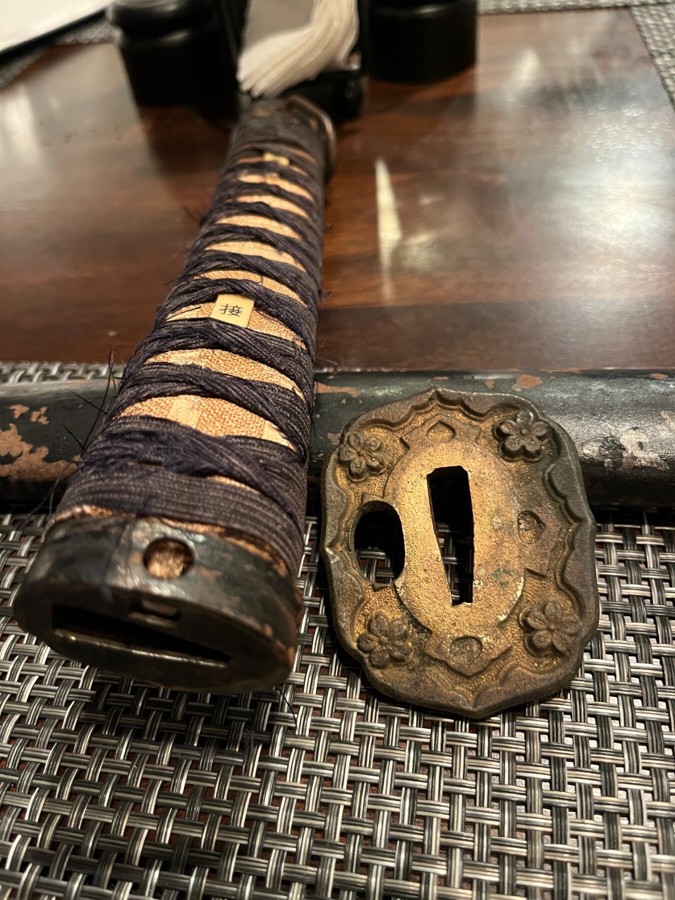

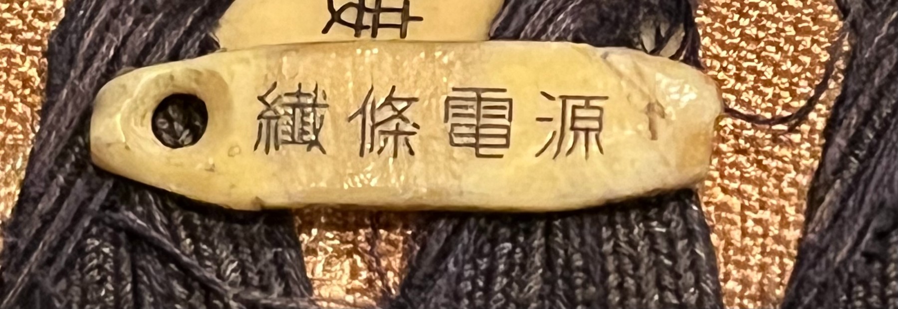

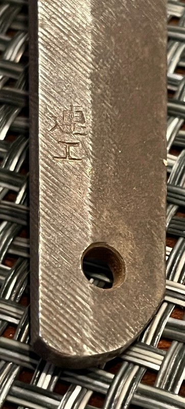

Bruce Pennington Posted January 30, 2023 Report Posted January 30, 2023 Could post this on the Mantetsu Survey thread, too, but since there aren't that many Mantetsu on file with the MRS fittings, I thought this would be a good place to post. Got the privilege of examining this one personally. Thanks Erns! @Stegel A Spring 1944 Mantetsu, with MRS fittings, double stamp "連工"; serial セ 2521. It has ivory or plastic (after removing them for photos, I think they are plastic) items in the ito, like menugi. Awaiting translation from the Translation Assistance guys. 2 1 1 Quote
BANGBANGSAN Posted January 30, 2023 Report Posted January 30, 2023 8 hours ago, Bruce Pennington said: Could post this on the Mantetsu Survey thread, too, but since there aren't that many Mantetsu on file with the MRS fittings, I thought this would be a good place to post. Got the privilege of examining this one personally. Thanks Erns! @Stegel A Spring 1944 Mantetsu, with MRS fittings, double stamp "連工"; serial セ 2521. It has ivory or plastic (after removing them for photos, I think they are plastic) items in the ito, like menugi. Awaiting translation from the Translation Assistance guys. 受聽器 Receiver 纖條電源 Fiber Power Supply 接 Connecting 1 Quote
Bruce Pennington Posted January 30, 2023 Report Posted January 30, 2023 7 hours ago, BANGBANGSAN said: 纖條電源 Fiber Power Supply Thanks Trystan! The guys on the Translation forum said they came from some sort of phone or communication equipment. Maybe a field radio? I'll post them on Warrelics. They seem to have a bunch of guys that collect that kind of equipment. BTW, do you know what is meant by "fiber power supply"? Quote
Kiipu Posted January 30, 2023 Report Posted January 30, 2023 Thanks to Trystan who transcribed the characters above, I was able to find the following information. 接 = setsu = on, on-position, of switch. 受聽器 = juchōki = earphones, headphones. 纖條電源 = senjō dengen = filament supply. A related term would be senjō dengen hen-atsuki 纖條電源變壓器 [filament supply transformer]. Source: United States, War Department. Japanese-English Technical Terms Dictionary. TM 30-482, November 1946. Quote
Bruce Pennington Posted January 30, 2023 Report Posted January 30, 2023 1 minute ago, Kiipu said: 纖條電源 = filament supply. Hmm, the plot thickens. I don't know anything about WWII electronic equipment. Can't picture what device would use "filaments". If someone here at NMB doesn't pop in with an answer by tomorrow, I'll run it by the Warrelics collectors. Thanks Thomas & Trystan! Quote
Kiipu Posted January 30, 2023 Report Posted January 30, 2023 16 hours ago, Bruce Pennington said: A Spring 1944 Mantetsu, with MRS fittings, double stamp "連工"; serial セ 2521. What color is the ito wrap and also the scabbard? Quote

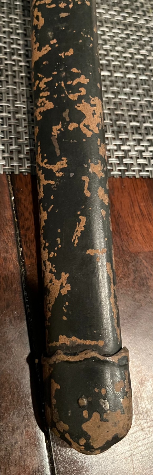

Bruce Pennington Posted January 31, 2023 Report Posted January 31, 2023 10 hours ago, Kiipu said: What color is the ito wrap and also the scabbard? The saya is a very dark green. At first glance, I thought it was black, but in good light you can see it is a dark, dark green. The ito seems to be a very dark grey, or light black. Quote
Bruce Pennington Posted August 13, 2023 Report Posted August 13, 2023 Updating the thread with the current stats. I have 18 of this style on file, all of them 1944/1945 except for Neil's '38 Manchurian Rinji Seishiki (MRS) Fittings Date Serial Number Notes Source 1938 Winter N 156 SMR IJASWORDS, NMB 1942 Spring Unknown Sohei swords/ebay 1944 Spring SE 489 Ren ebay 1944 Spring SE 1029 Ren 1944 Spring SE 1066 Ren 1944 Spring SE 1144 Ren 1944 Spring SE 1251 1944 Spring SE 1310 Ren Leather Saya Cvr 1944 Spring SE 1344 Ren 1944 Spring No serial number Ren Gold Saya Worthpoint 1944 Spring SE 2430 Ren 連工 1944 Spring SE 2575 Ren 連工 1944 Spring SU 10 Ren 連工 1944 Spring ? 199 Ren 連工 1945 I 142 Unknown Fuller 1945 I 285 Mumei ND blade only Steve, NMB 1945 I 165 Mumei ND Remilitaria.com 1945 I 1170 Mumei ND Quote

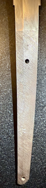

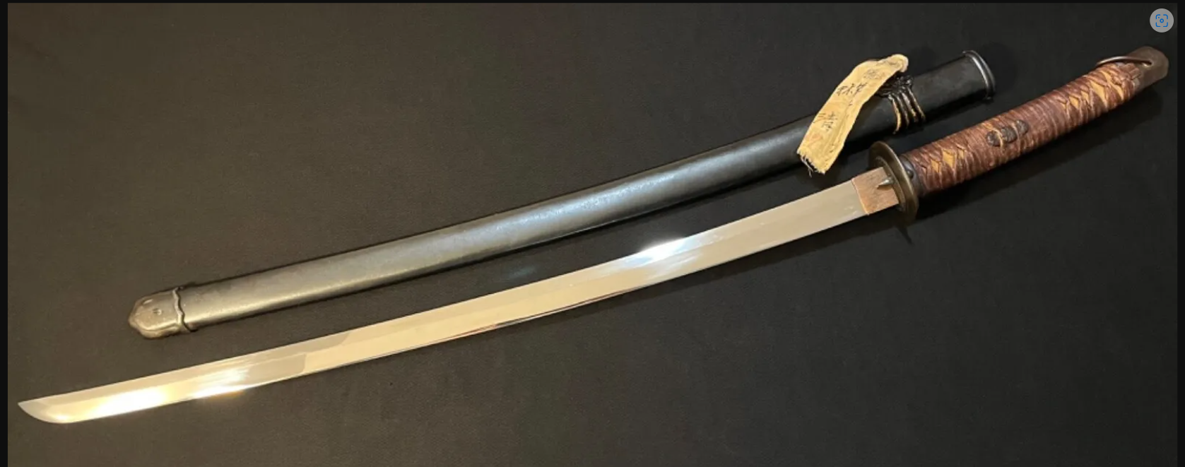

Bruce Pennington Posted March 8, 2024 Report Posted March 8, 2024 Another for saie by St. Croix Swords HERE. Has a 1945 mumei Mantetsu い 164 @Kiipu @BANGBANGSAN 1 1 Quote
Kiipu Posted March 8, 2024 Report Posted March 8, 2024 The name is 林清 on the tag. The first character is the last name and the last one is the first name. Many different pronunciations for each character though. @Stegel 1 Quote
mecox Posted March 9, 2024 Report Posted March 9, 2024 As per Thomas, name at left likely to be: Hayashi Kiyoshi 林清. At right may be, but not sure: Korei dai san bu ni katsu kai. Army group?? 3 Quote
BANGBANGSAN Posted March 9, 2024 Report Posted March 9, 2024 2 hours ago, Kiipu said: The name is 林清 on the tag. The first character is the last name and the last one is the first name. Many different pronunciations for each character though. @Stegel 古厩第三部二(冶/浩?)会 林清 1 Quote

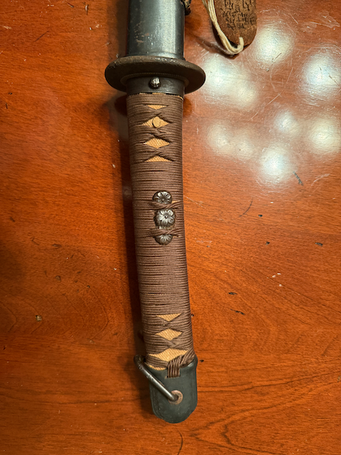

Conway S Posted April 24, 2024 Report Posted April 24, 2024 Greetings, I thought I'd post one of my recent acquisitions. Perhaps in the same way colorful snakes scare potential predators away with bright colors, this parachute chord wrap scared potential bidders away. The wood core is original, but the same is gone. I'll hopefully send it off to get rewrapped soon. @Bruce Pennington thanks for referencing the hiragana "I" in your previous post. The mune is stamped い 八八.The tsuba is stamped 7 80 and the fuchi has a faint 4 on the release button prong. Conway Quote
BANGBANGSAN Posted April 24, 2024 Report Posted April 24, 2024 31 minutes ago, Conway S said: Greetings, I thought I'd post one of my recent acquisitions. Perhaps in the same way colorful snakes scare potential predators away with bright colors, this parachute chord wrap scared potential bidders away. The wood core is original, but the same is gone. I'll hopefully send it off to get rewrapped soon. @Bruce Pennington thanks for referencing the hiragana "I" in your previous post. The mune is stamped い 八八.The tsuba is stamped 7 80 and the fuchi has a faint 4 on the release button prong. Conway Congrats, you got it for a good deal. 1 Quote

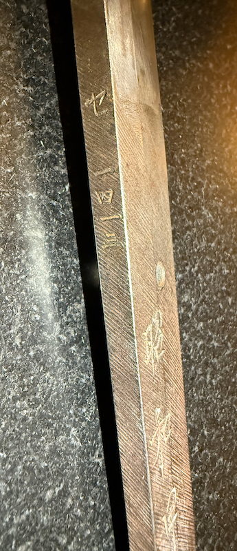

Conway S Posted October 23, 2025 Report Posted October 23, 2025 Here’s another example. Spring 1944 with ren stamp 連 and serial セ se 一四一三: It’s in overall excellent condition. 2 Quote
Bruce Pennington Posted October 23, 2025 Report Posted October 23, 2025 9 hours ago, Conway S said: It’s in overall excellent condition. That is a beauty, Conway, and a new one for the files, thanks! That makes 15 examples so far. Wouldn't mind getting one of these in my collection some day. Going to have to sell my wife's car, though, to get the cash. 1 1 Quote
Conway S Posted October 25, 2025 Report Posted October 25, 2025 (edited) @Bruce Pennington Here’s another Spring 1944: セ 一一四三 that’s not listed in your table. Maybe you haven’t seen this one yet sold Here Edited October 25, 2025 by Conway S Quote
Bruce Pennington Posted October 25, 2025 Report Posted October 25, 2025 2 hours ago, Conway S said: Spring 1944: セ 二四三 Thanks Conway, I've got that one down as "1143". There is a pretty good space between the two ones. 1 Quote
Conway S Posted October 25, 2025 Report Posted October 25, 2025 Ah you’re right! The top stroke would be shorter than the bottom if it was a two. Good catch. Looks like there are consecutive numbers recorded now (セ1143 and 1144). Quote
Bruce Pennington Posted October 26, 2025 Report Posted October 26, 2025 21 hours ago, Conway S said: consecutive numbers recorded now (セ1143 and 1144). I don't see 1144 in the chart or my files. Do you have a reference? I have a 1344 on file. Possibly when it was first found we saw the large strokes and missed the smaller strokes of the 3? Quote
Conway S Posted October 26, 2025 Report Posted October 26, 2025 I was just referencing what’s posted above. Maybe a mistake in your chart if you don’t have a picture recorded. Quote
