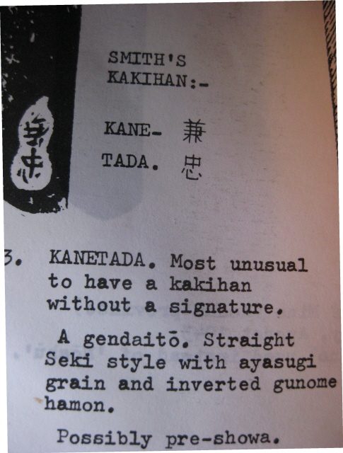

GregD Posted October 5, 2008 Report Posted October 5, 2008 maybe this will help,a friend had a sword by this smith some years ago,shinsa said modern factory made.Stiill a nice looking sword,profuse ayasugi hada.This is the info i have from F&Gs Greg Quote
Brian Posted October 6, 2008 Report Posted October 6, 2008 Greg, The name rang a bell. Now I remember it..from SFI? Welcome, great to have you here! Brian Quote
