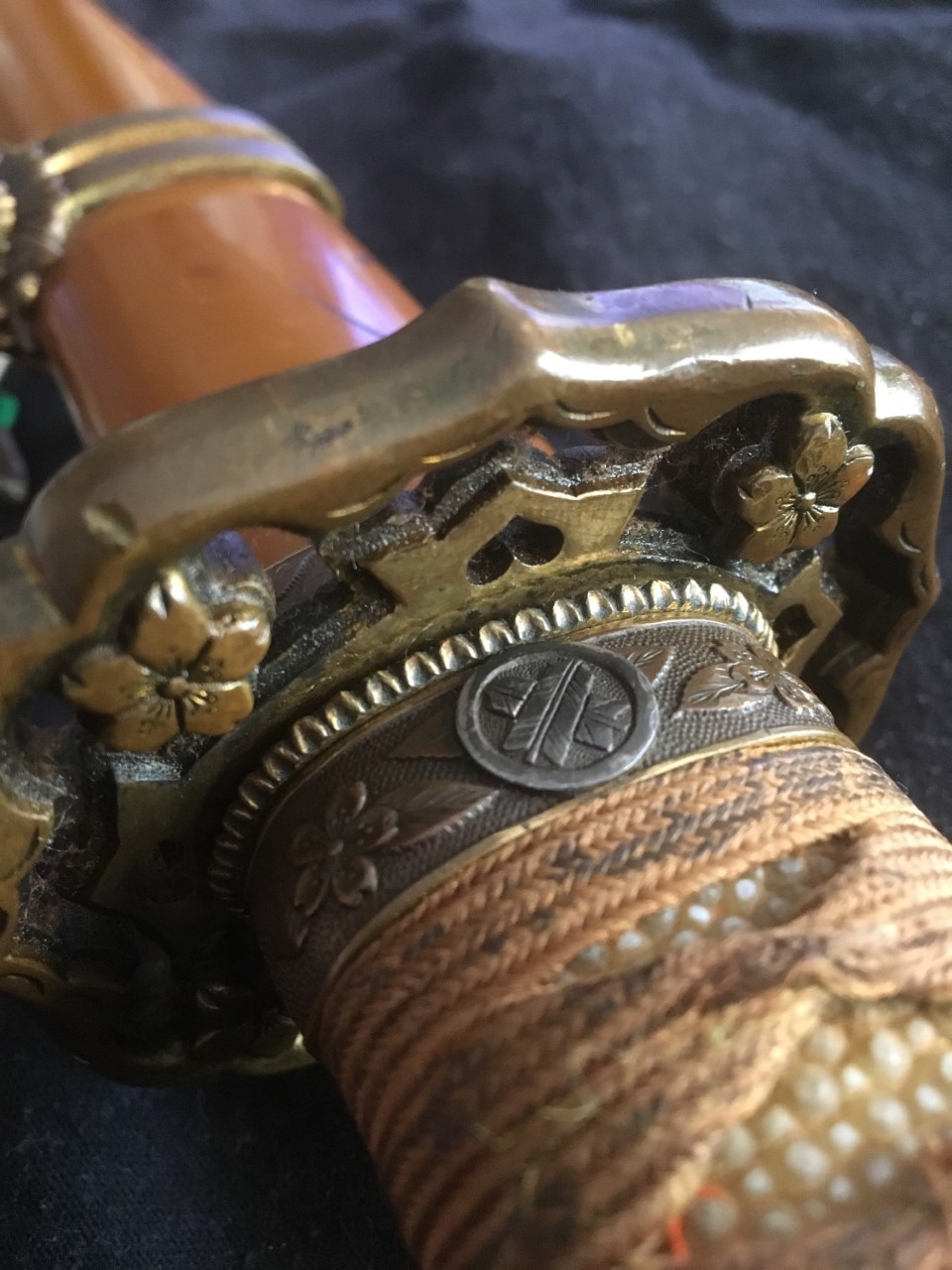

I have this seki stamped showato or semi-traditional(since it's stamped) by Kiyomiya with the 'sakai' mon.
Might be of interest for the thread? :)

Kamon shown in Austus's posting is Maru Ni Yotsu Ishi (Four stones within a circle) a rare one, sometimes confused with the famous  hishi24.gif
Kamon shown in David H's posting is Maru Ni Ken Katabami (Creeping wood sorrel and swords within a circle) katabami3.gif
Can you spot the difference between it and this katabami8.gif which is called Maru Ni Hanare Ken Katabami?

There's a small difference in the spacing between the other mon. Very small. Is that the answer?  (If you respond, could you tell us your martial art, too?)
Hi Austus, absolutely correct.
The trick is in the wording Hanare, which means opening or expanding, it's also used in Kyudo (Japanese archery to express the moment that the arrow, held at highest tension is released).
