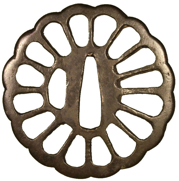

One more
It is the only papered tsuba I have that is mumei
This won't last long so I'll be looking at the clock to see who is fastest
Is the ana original or a later addition?

I'd think the design is original as ana is included in the design. I'd guess making major changes to design like that after the item is already made would be futile as you can always make a new tsuba with similar but slightly altered design.
The shape is kiku-gata/kikka-gata. I'm not too well versed on who made these but I believe they often get attributed to Saotome. So my guess is Saotome.
The iron reminds me of HIGO, the slightly irregular lines say JINGO to me. A nice and strong TSUBA, I like it a lot. The ANA is of course original.
Difficult to judge the material from your pics, Grev. If made by yamagane, ko-kinkō should be the quite obvious answer. If made by iron, much harder to say...

I couldnt be sure what the metal was, but thought yamagane late Muromachi/Kokinko
Spent 5 minutes wondering about the shinsa result, size?, nakago ana size?, mass produced, perhaps they feel there is no evidence to suggest it wasnt sat on a Tachi at some time  :laughing:

These always seem get thrown into the Ko Kinko bracket, but they obviously found something special about this particular example, be good to know what?
Is there anything that stands out to you Grev?
Would they be wrong?, having seen so many....
