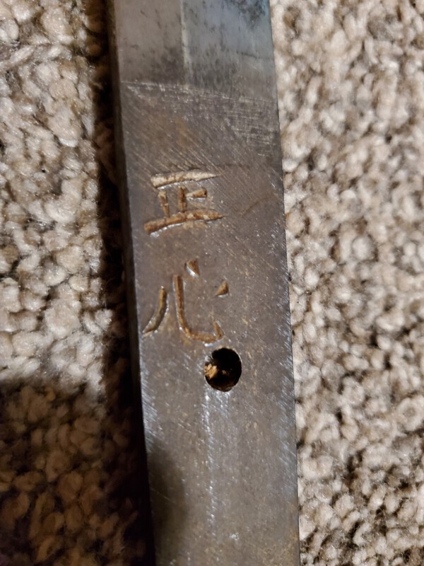

So, Steve, what do you think about this one?  It doesn't have the 右, just the 正心.  It's on a shingunto on This Thread
Yanagawa Seishin (or Shōshin). Morita-san mentioned in his other post that this was the same person as Yanagawa Useishin (or Ushōshin), but he speculated that Seishin started adding the 右 to his name later in life to signify some life event (in this case, having returned from the war).
