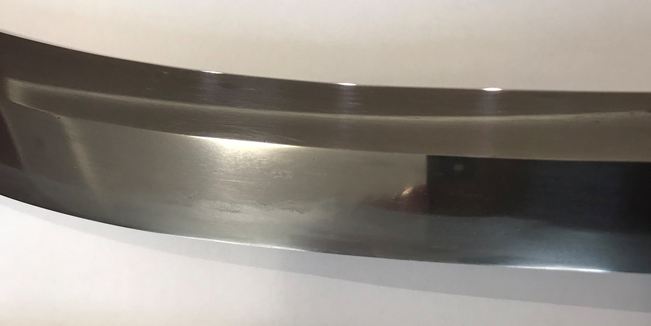

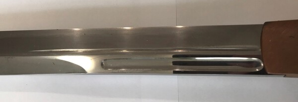

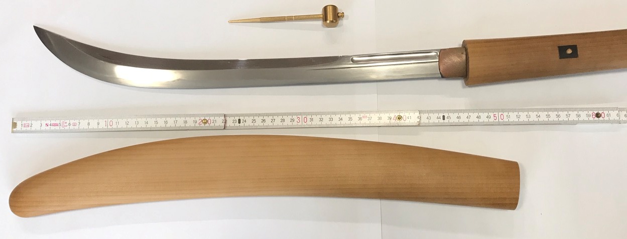

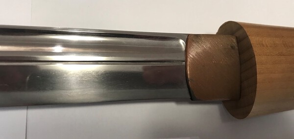

nektoalex Posted December 4, 2017 Report Posted December 4, 2017 Greetings! I ask you to help in the identification of this naginata. While the photos are just like that. Thanks in advance. Quote
TheGermanBastard Posted December 4, 2017 Report Posted December 4, 2017 Looks like a rather late piece. Shinshinto likely. Not for the battle ground. Quote
paulb Posted December 4, 2017 Report Posted December 4, 2017 Alexandr do you have any images of the nakago? Luis, you may well be right, however it would be very helpful if not only stating what you think it is but also what makes you come to that conclusion based on what you can see. 2 Quote
nektoalex Posted December 4, 2017 Author Report Posted December 4, 2017 While there is no, he is interested in receiving them and at the first opportunity will publish them. 1 Quote
TheGermanBastard Posted December 4, 2017 Report Posted December 4, 2017 Hello Paul, well the Sugata, color of steel and Condition lead me to believe it is a rather late Shishinto periode piece. I am having a hard time to nail it down in words. It is just after having looked at and handle sufficient blades that you get the feeling for it. if we can see the Nagako it will be a way easier call ... but just looking at the images that is my impression. 2 Quote
Ray Singer Posted December 4, 2017 Report Posted December 4, 2017 Shorter naginata with deep curvature in the monouchi is typical for the Edo period, seen in both Shinto and Shinshinto. From the look of the tsuka, I would guess that it has a short, ubu nakago (rather than an osuriage one). The naginata-hi are simplistic, also pointing to later work. 1 Quote
paulb Posted December 5, 2017 Report Posted December 5, 2017 Hi Luis thanks for coming back. I tend to agree with you regarding shape and condition although as Ray says the exagerated shape seen here started earlier and carried on through. Colour is tricky, I struggle to identify colour in steel unless it is fairly extreme but for sure I wouldn't risk it based on a screen image unless it was on a very high end calibrated screen. I also think the hi have a basic look to them. Quote
Jean Posted December 5, 2017 Report Posted December 5, 2017 The notion of dark steel (identification/kantei point to Northern kuni) is tricky and can’t in no way be ascertained by looking at pictures, be cause as mentioned my friend Paul, it depends on light. You have to study several blades side by side at the beginning to be able to absorb this notion and establish a scale of colour steel. This is a relative notion and that must not be forgotten: it is dark steel compared to.... this notion is only valid for Koto. In Shinto times, steel travelled (on its little legs) and become homogeneous throughout the country. So darker steel in late Shinto or Shinshinto lets me skeptical... Quote
Jacques Posted December 5, 2017 Report Posted December 5, 2017 So darker steel in late Shinto or Shinshinto lets me skeptical... Yasutsugu is known for this feature Quote

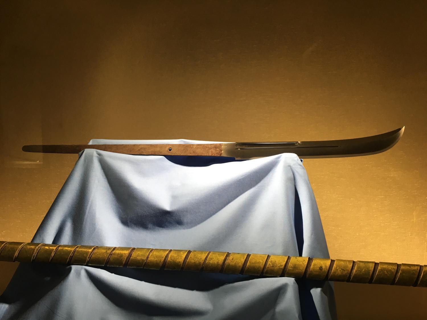

Marius Posted December 5, 2017 Report Posted December 5, 2017 While I agree with the statetement about the shape, here is a short naginata. Can you say something about it? This is not an attempt to hijack the thread. Quote

J Reid Posted December 7, 2017 Report Posted December 7, 2017 Back to topic... the Naginata that Marius posted is good for comparing to the other naginata in discussion. Funny enough they kinda look similar. The one Marius posted looks mid-late Edo (hard to tell for sure because of the lit up patina on Nakago).. Pretty short and beefy. Sugata is almost a balance in length in Nagasa X Nakago. The original posted naginata had a longer Nagasa and shorter nakago ..slightly slimmer Sugata.. Id think the OP naginata is older (earlier Edo) than Marius's and actually slightly suriage. All speculation and uneducated without seeing OP nakago. Jean, I agree, when comparing a Koto blade with "a good example of dark steel" vs a shinto or newer, it is obvious that the steel of old swords is considerably darker. Thinner and lighter blades too. Shinto steel is "generally" lighter in colour as opposed to Koto. Jean and Jacques.. exceptions to all rules right? Occasionally there is shinto blades with "darker" steel and koto with "brighter" steel. Jean is correct about the transition of steel quality from Koto to shinto and I'm sure Jacques is right too about yasutsugu .. didn't he and other shinto smiths experiment by sourcing old steel to use when making their swords? Just my Thoughts .. oh and I agree with you,Luis.. you start to develop a "sixth sword sense" haha. 1 Quote
Marius Posted December 7, 2017 Report Posted December 7, 2017 Josh, Thanks for your comment. I have posted this naginata to show that there are always exceptions in nihonto. Of course, I agree the naginata shown by Alexandr is mid to late Edo. But this does not mean that a pronounced saki zori in a naginata proves it is of a later make. The blade in my photograph is an early Kamakura naginata, displayed among other swords in the Futarasan shirne in Nikko. Attached is the full picture, with the nagaye of this blade. Many early naginata seemed to have a strong curvature. Have a look at the Heiji Monogatarki Emaki (Heiji scroll). 2 Quote
TheGermanBastard Posted December 7, 2017 Report Posted December 7, 2017 In general we should focus on the rules not the exceptions I would like to think Quote
Shugyosha Posted December 7, 2017 Report Posted December 7, 2017 Hi Luis, In England we have a saying that "rules are for the guidance of the wise and for the governance of fools". I'm not suggesting that you are a fool (whereas in Nihonto terms I certainly am) but learning the rules is only the beginning... Best, John Quote
TheGermanBastard Posted December 7, 2017 Report Posted December 7, 2017 hello John, the Naginata posted by Marius is a great example for an exception ... the blade is in exceptional condition. Again just relying on the image Iw ould not have put this anywhere near Kamakura in 101 out of 100 attempts. Quote
Shugyosha Posted December 7, 2017 Report Posted December 7, 2017 Me neither - I would have given it to Shinto and probably will if I see it again. Quote
J Reid Posted December 7, 2017 Report Posted December 7, 2017 Wow Kamakura? No kidding.. very surprised. Interesting exercise, guys. Quote
